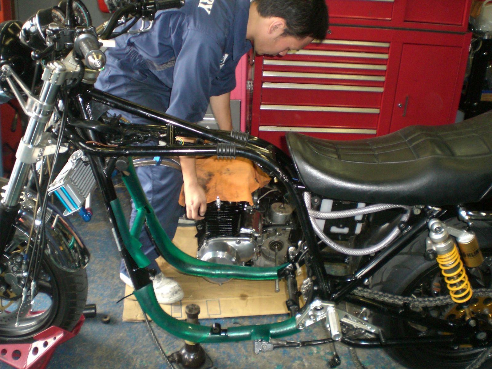

24 Aug 2012 01:22 - 24 Aug 2012 01:25 #544430
by sc/ant864
Engine is out, wow that thing is heavy next time I'll get help. My arms feel like I went to the gym for a full day.

24 Aug 2012 10:07 #544460
by 531blackbanshee
Replied by 531blackbanshee on topic '77 KZ 900/1000 street/drag project
those engines are heavy,awkward,finger biting,sonsab!tches :pinch: .
some rubber/vinyl tubing split lengthwise is a good frame protector.
available from most home improvement stores,
