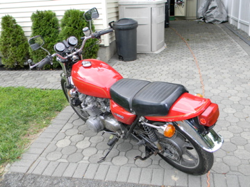

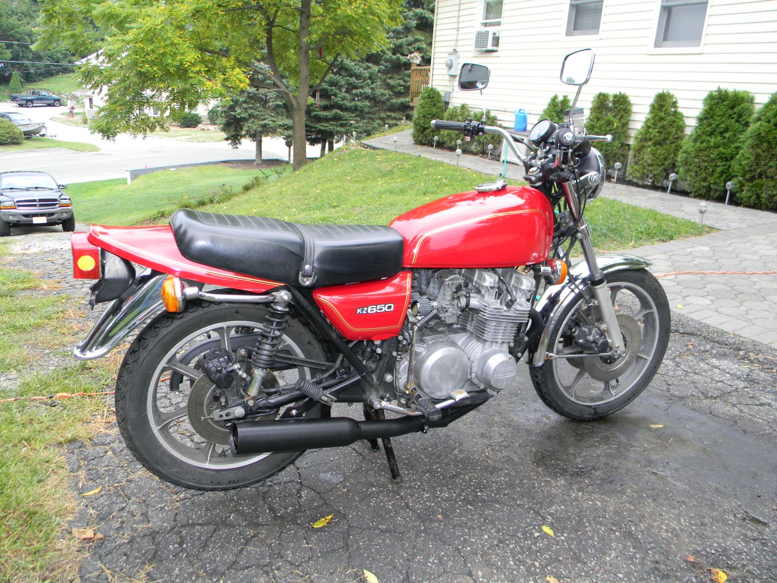

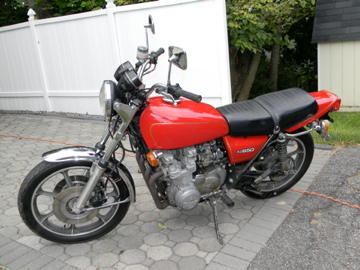

...OK, so I wasn't sure what I was going to do with this bike. So, I stated to sort it out and fix the little problems. Here a list of what I fixed so far.
1. Didn't run, just chugged on maybe a cylinder and a half. Pulled and cleaned carbs. All good, runs like a bear!
2. Replaced bad horn.
3. Replaced slooooooooow directional flasher.
4. Replaced missing seat hardware, only had one pin holding the seat on.
5. Freed up sticking front calipers.
6. Installed complete missing center stand.
7. Replaced one fogged up directional lens.
8. Replaced bad neutral light bulb.
9. Replaced missing battery hold down strap.
10. Cleaned inside of tank and fixed frozen petcock.
11. Installed new plugs.
12. Changed oil and filter.
13. Pinstriped tank, covers and rear tail piece.
14. Diagnosing no taillight, traced to bad ignition switch.
...Anybody have a ignition switch for a '77 650 C3? I guess it's off to eBay.
...That's pretty much it for mechanical problems. Now I just need to clean it up to match the fairly fresh paint job. I really bought it to fix up and sell. But, it runs so well, I think I may keep it. I figured I might keep it at least until I get the #1 project bike complete and then maybe sell it. Maybe. But, it sure would be nice to have a Commuter, a Cafe bike and a Harley. We'll see.
...anyway, here's a few pix after the work.

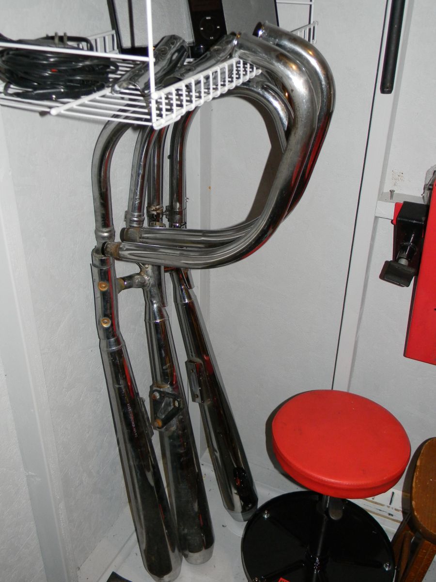

...found the pipes for my #2 project Kaw!
...through two different sources.
...one right here on KZR.
...the other on fleeBay.
...I must say, pieces from both are in excellent condition and I'll have parts left over. They'll look like brand new when I get through cleaning them. Can't wait to get 'em on the ol' girl and see what they look like. My vision of putting it back to a real stocker just might come true. Soon baby, soon!
