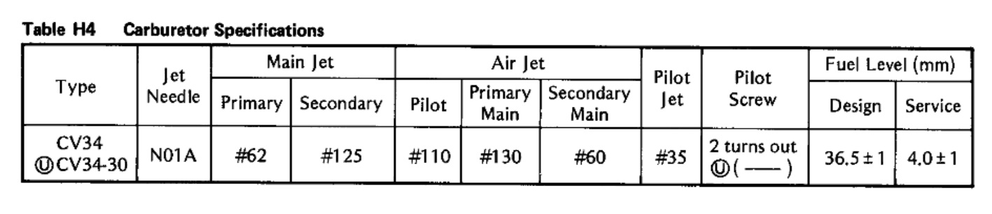

Kevin, do you have a factory service manual for your Spectre? If yes, does it cover the Keihin CV34mm carbs?
I've been having trouble finding the FSM float bowl height and fuel level height for my 82 Spectre 750. I don't have a manual for it. If you do, I'd sure appreciate a quick spec lookup.

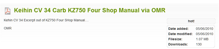

rustbuckett wrote: Kevin, do you have a factory service manual for your Spectre? If yes, does it cover the Keihin CV34mm carbs?
Thx.
KZr's FILEBASE
Attachment filebasekzr.jpg not found
includes the following:
Here's a direct link:
www.kzrider.com/filebase/doc_download/47...-shop-manual-via-omr
Scroll down to locate:
Good Fortune! :)

Hey Rust,looks like PATTON supplied the info.I got into my carbs today and repaired the fuel leak (again).I found the repair I did last time actually partly blocked the fuel to the 3+4 carbs.its all good now.While I had them on the bench I checked my float height-upside down from the rim of the carb I measured 16mm.I have to do the clear tube test again but I had about 4mm.The bike runs nice up to about 5k rpm then bog s bit so I have more to do I will post pics of my fuel pipe mod later tonite.I also changed my brake fluid it had the color of maple syrup.I floated new fluid on top of the old and used a syringe to suck the old crap out.That kept the me from getting air in the lines,then I opened the bleeder and let new fluid run through the whole system.I picked up a one man brake kit from the Auto store.
