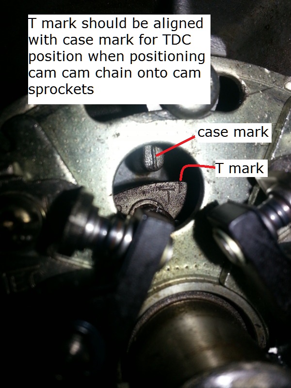

04 Dec 2012 14:34Would consider using threadsert as opposed to helicoil.sweetbro wrote: ...stripped the threads out of one of the cam cap holes. What is the best way to fix this? Is there enough meat there to helicoil it? What has anyone else done in this situation?
As to positioning crankshaft at TDC when installing cam chaim --
