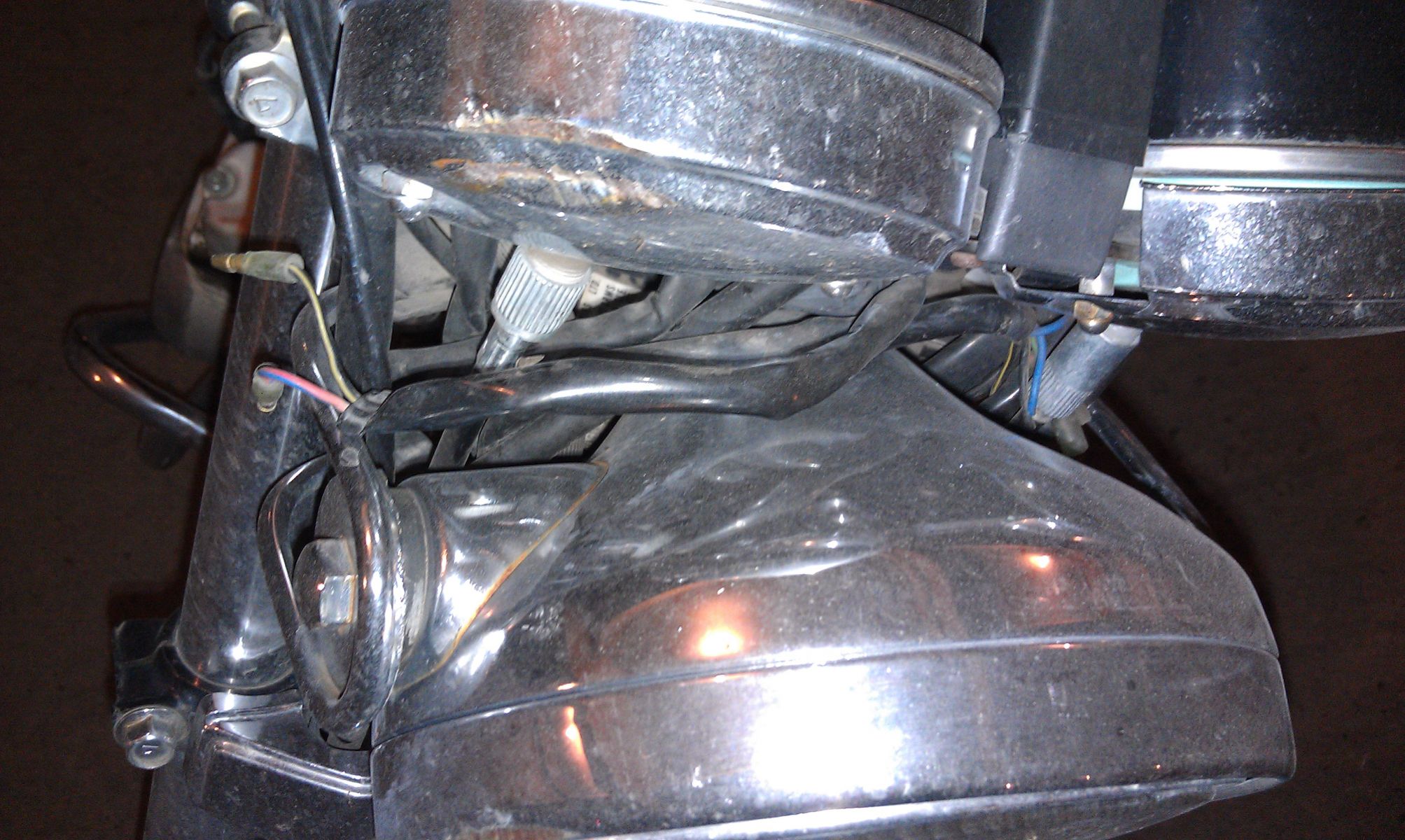

- clean up wiring (see picture of headlight)

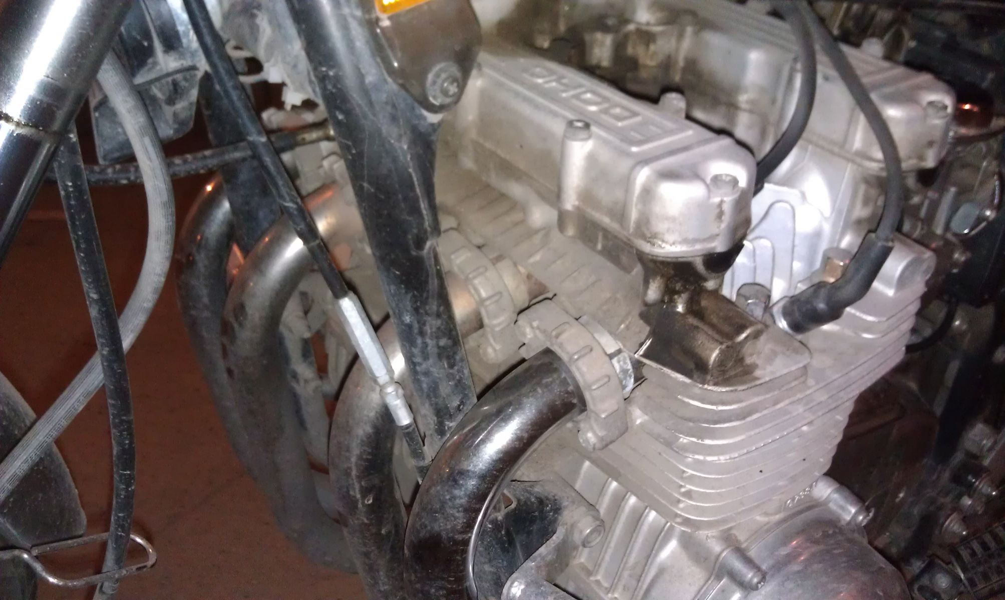

- figure out where the oil on the top of the engine came from. Looks like from the cam end plugs but last time I had the valve cover off I wrapped those up in teflon tape and they seemed to have sealed up well. (Maybe need a new valve cover gasket)

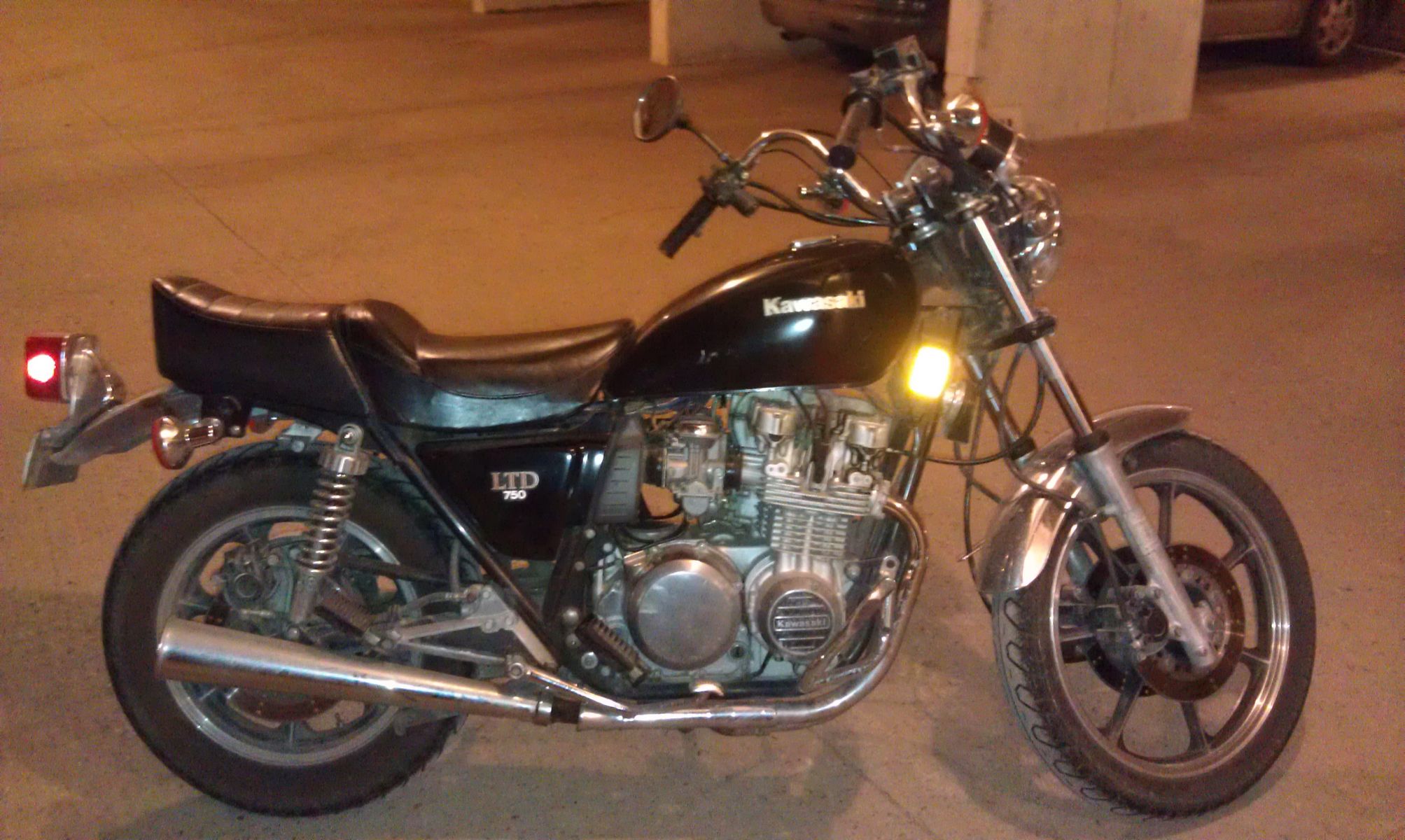

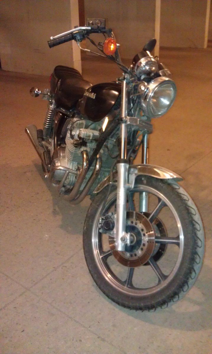

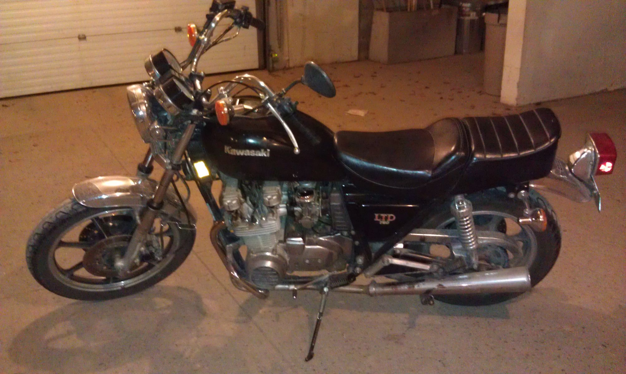

So, now pictures. It isn't much to look at, but maybe one day it will be.
