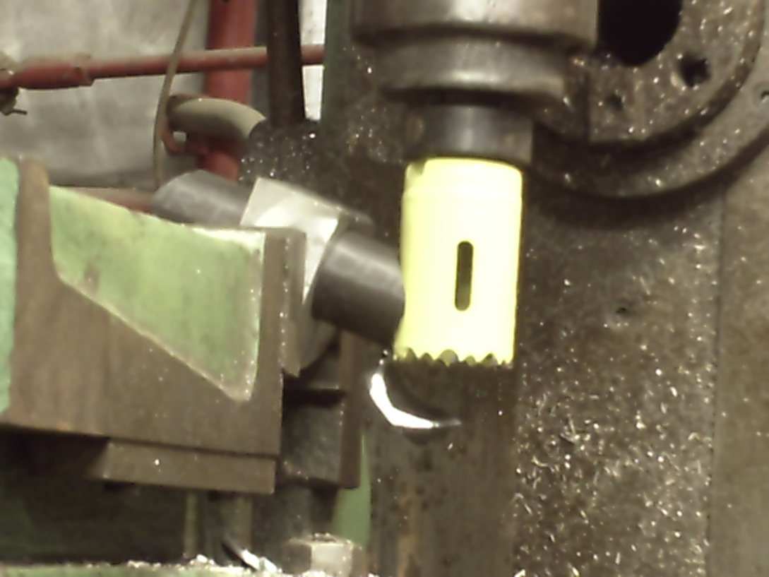

i use bi-metal hole saws for tube notching.
not that great of a pic :whistle: ,but you get the idea.
i bored a hole through a piece of scrap aluminum to use to clamp the tube with,hardwood could work just as well.
a small drillpress and vise will work to notch some tubing.
looks like you got along just fine on the tube notching.

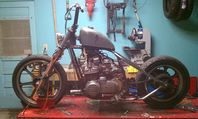

Yeah, Leon, I am agreeing with the ugliness of that modified swingarm. I was thinking of how to just remove it altogether but that would mean fabbing up the frame from the center, under the final drive back to the axle mount. I hate the whole swing arm back there and honestly, the chain slack adjusters are crap too.
I love your clamp idea. Gonna make something like that for my drill press.
Give me some suggestions of how to go about doing this without the swingarm. I would need some stock adjusters and pieces from a stock swingarm to use as the mount for the rear tire.

I guess this would be an answer. I feel like I could build something like this rear frame section if I take my time...

what size is the rear axle?
maybe a set of these,
www.lowbrowcustoms.com/index.php?l=product_detail&p=90
in kinda this sorta fashion,
perhaps :whistle: ,
perhaps :whistle: ,

a few custom made frame slugs,some axle pates or cut up an old swingarm and grab the axle plates..

Yes. That low rail running back to the rear wheel is a good look. I don't have a really good way of making nice bends except for torch heat. Any suggestions on a cheap way to do nice bends on 1" tube?
Now I gotta find an old swingarm for the plates and some stock adjusters.
I will keep my 'stretch' as all it amounts to, at this point, is some extra links in my chain. But I am 6'3" and want the extra room and want the bike to look 'bigger' under me.
Can you say 'rabbit hole"? What the he** am I doing?!! Lol! This project keeps morphing.
