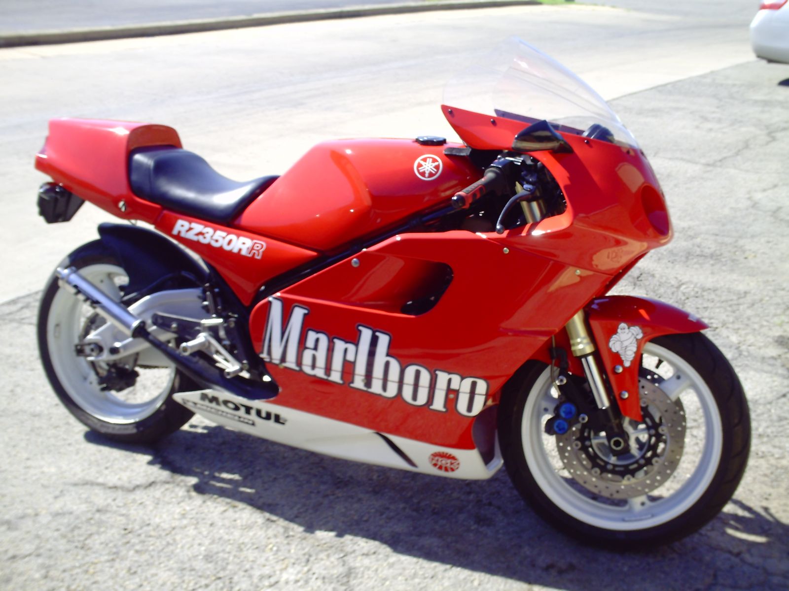

i can't wait to follow along on your build.
i hate to hear you have to sell something tho :sick: .
here is an rz a buddy of mine owned.
