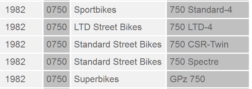

The info on kawasaki.com includes parts diagrams, part names, part numbers, models sharing same part, availability, etc. For example, here's an excerpt from one of the earlier screens which gives an idea about the various 750 models in 1982.
