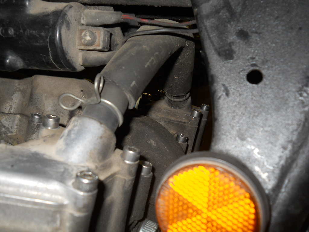

Just another question. It may have been a stupid thing for me to do, but I have totally ditched my exhaust recirculation system on my bike. Instead of buying the block off plates for the valve cover, I just ran a reinforced rubber hose from one side to the other, held on with hose clamps. Used a bolt and two washers with liquid gasket to patch the hole in the airbox. As long as there are no leaks, should this work? I am worried if there will be too much pressure in the hose. Im trying to think this out, but I am not familiar with what goes on under that valve cover. Is there a lot of pressure? Does it need to vent? Is my hose going to burst and cover my face with burning hot oil?
1979 KZ650B3

Cobura, the cross over hose fix works like a charm. 2 years and no problems. This is on a 750-4.

Cool!!! Looks just like mine now. Im glad to have some confirmation. Thanks.
