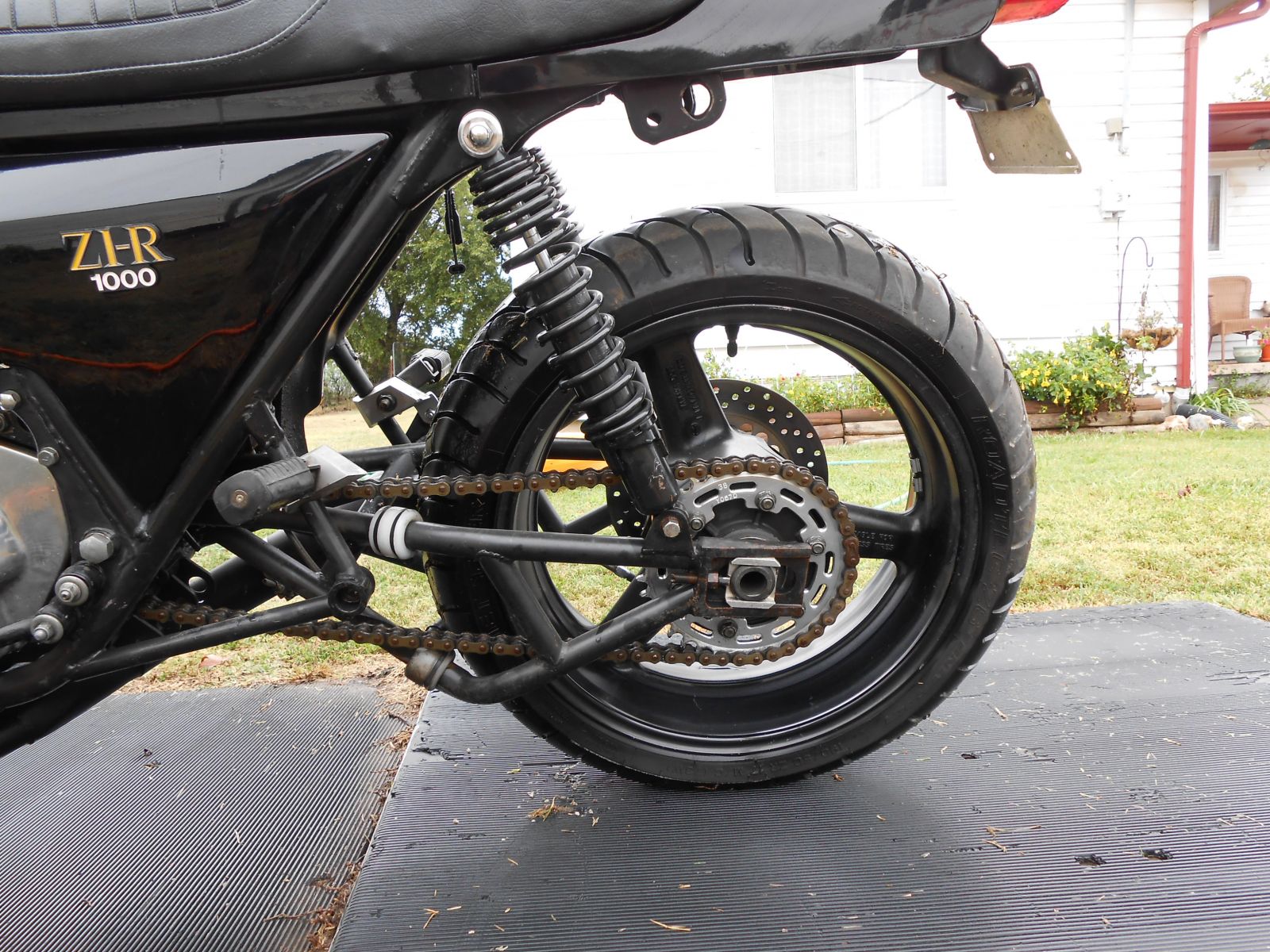

i have 13 motorcycles.
the black z1r in my avatar has a stock engine with some mild head work sir.
i built my own swingarm for it from chromoly tubing and shoved a rear wheel tire and brake from a 2000 r1 under the back end.
now you fly up to a corner and throw it at the pavement and start rolling the throttle open as it stands back up and goes flying down the road trying to suck you off the back :woohoo: !
no shakes,no shimmies just pure fun :evil: .
