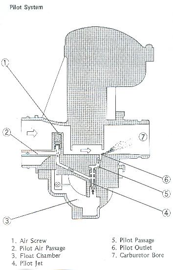

I don't think you should have used straight up lemon juice. I used 6 parts water and 1 part lemon juice and got very good results. As for the pitting, most likely it was already there due to moisture sitting in the carbs over the years. Or maybe do to manufacturing. But the lemon juice, especially the strength you used, will etch a little and bring out any pitting that already exists. You should be fine however. One of the main jet tubes and float towers were pitted bad on one of my carbs. Was concerned about the main jet seating properly but seems to work fine. Just as long as you didn't boil any of the rubber parts you should be good to go. I used carb cleaner and compressed air after the boiling process as well. Use Patton's pilot circuit cleaning method to spray the carb cleaner for that circuit. Also, clean the choke circuit as well with carb cleaner and compressed air. Don't forget the choke circuit passage in each of the bowls as well. Might as well go the extra mile while you have them apart. Good luck.

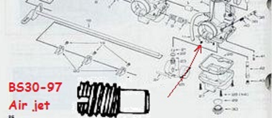

02 Aug 2012 17:56KZJOE900 wrote: I don't think you should have used straight up lemon juice. I used 6 parts water and 1 part lemon juice and got very good results. As for the pitting, most likely it was already there due to moisture sitting in the carbs over the years. Or maybe do to manufacturing. But the lemon juice, especially the strength you used, will etch a little and bring out any pitting that already exists. You should be fine however. One of the main jet tubes and float towers were pitted bad on one of my carbs. Was concerned about the main jet seating properly but seems to work fine. Just as long as you didn't boil any of the rubber parts you should be good to go. I used carb cleaner and compressed air after the boiling process as well. Use Patton's pilot circuit cleaning method to spray the carb cleaner for that circuit. Also, clean the choke circuit as well with carb cleaner and compressed air. Don't forget the choke circuit passage in each of the bowls as well. Might as well go the extra mile while you have them apart. Good luck.
In retrospect the lemon juice did seem too harsh, but even then it took several times to remove the film the pinsol left. In the future i will dilute it. The pitting that is there is almost not noticeable, except on the pot metal parts. I'm going to follow your advice and clean all the circuits one more time before I put them back together, just to make sure they're good.

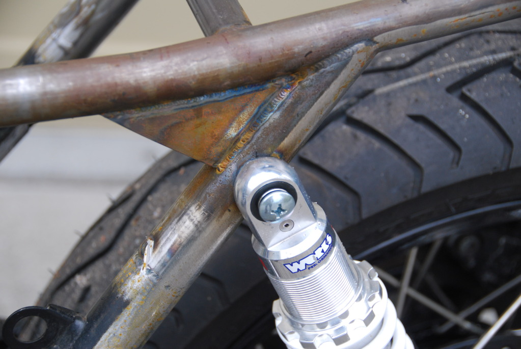

well its been a while since i got to post some progress in here. I got my frame back from the straightener and was able to get Eric to help me out a bit yesterday. I fit all the gussets and he welded them in. It started raining on my way back home so everything rusted a bit.
We also started on the shock mounts, unfortunately we only had enough time to get one done. eric turned a new mount, and changed the design slightly. It now has a bolt going into it. cleaned up the design a bit, I think it looks good, gotta get a cool fastener for it though. I still need to fit the two cross braces and two braces for the steering head. Hopefully I will get to that this week. feels damn good to be getting some progress done after sitting idle while it was at the straighteners

16 Oct 2012 10:37DoctoRot wrote: We also started on the shock mounts, unfortunately we only had enough time to get one done. eric turned a new mount, and changed the design slightly. It now has a bolt going into it.
