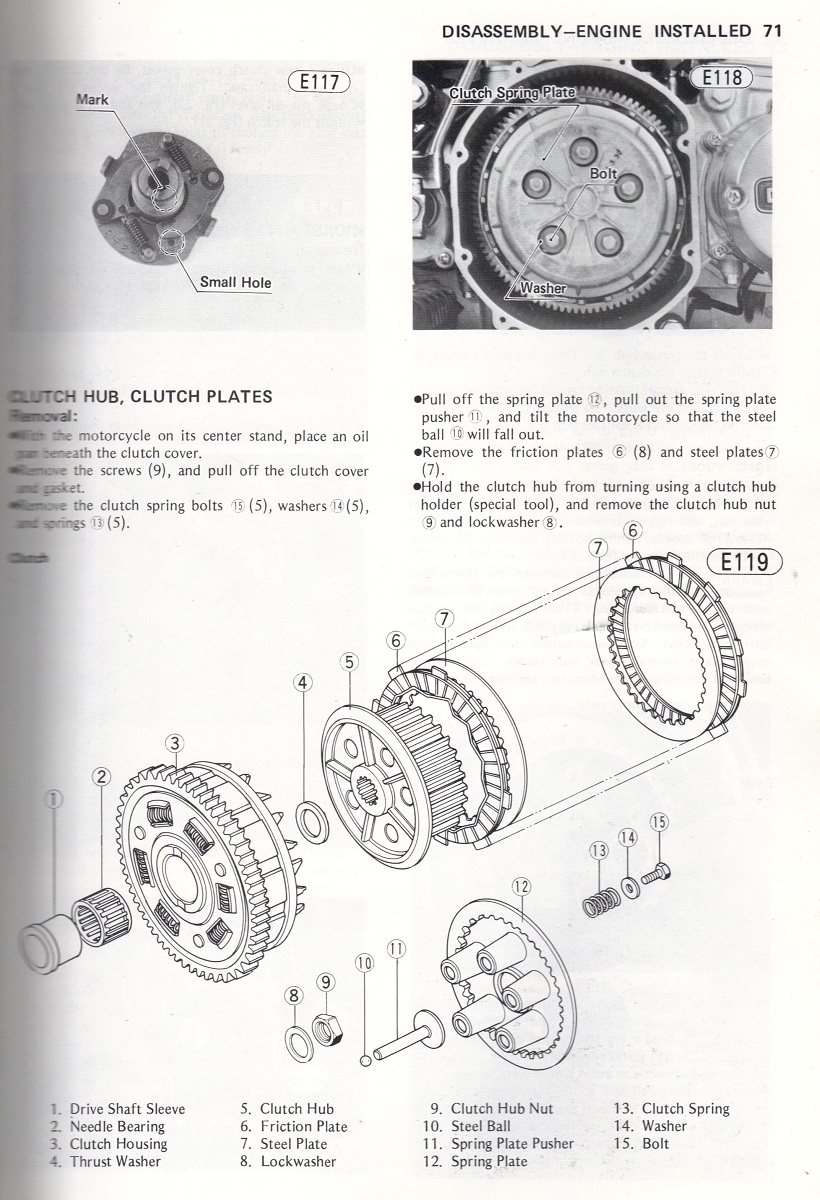

I went to install the clutch basket and found a large problem. the clutch basket must be assembled on the input shaft prior to the cases being put together. which now means I have to take apart everything I just did. :pinch:

i do not run my sound arrester and can tell no difference i could be deaf or just a dumba$$ but i can't tell the diff.
the clutch basket is made to be romoved or replaced without splitting the cases.
what makes you think it can't be?

Well I just held it up to the opening and it is much wider, i dont see how it could possibly fit in there without opening the cases. excuse my ignorance if there is something i'm missing. (i hope there is)

after reviewing the manual i believe that you are right sir.
you will have to split the cases to get the basket in there :pinch: .
