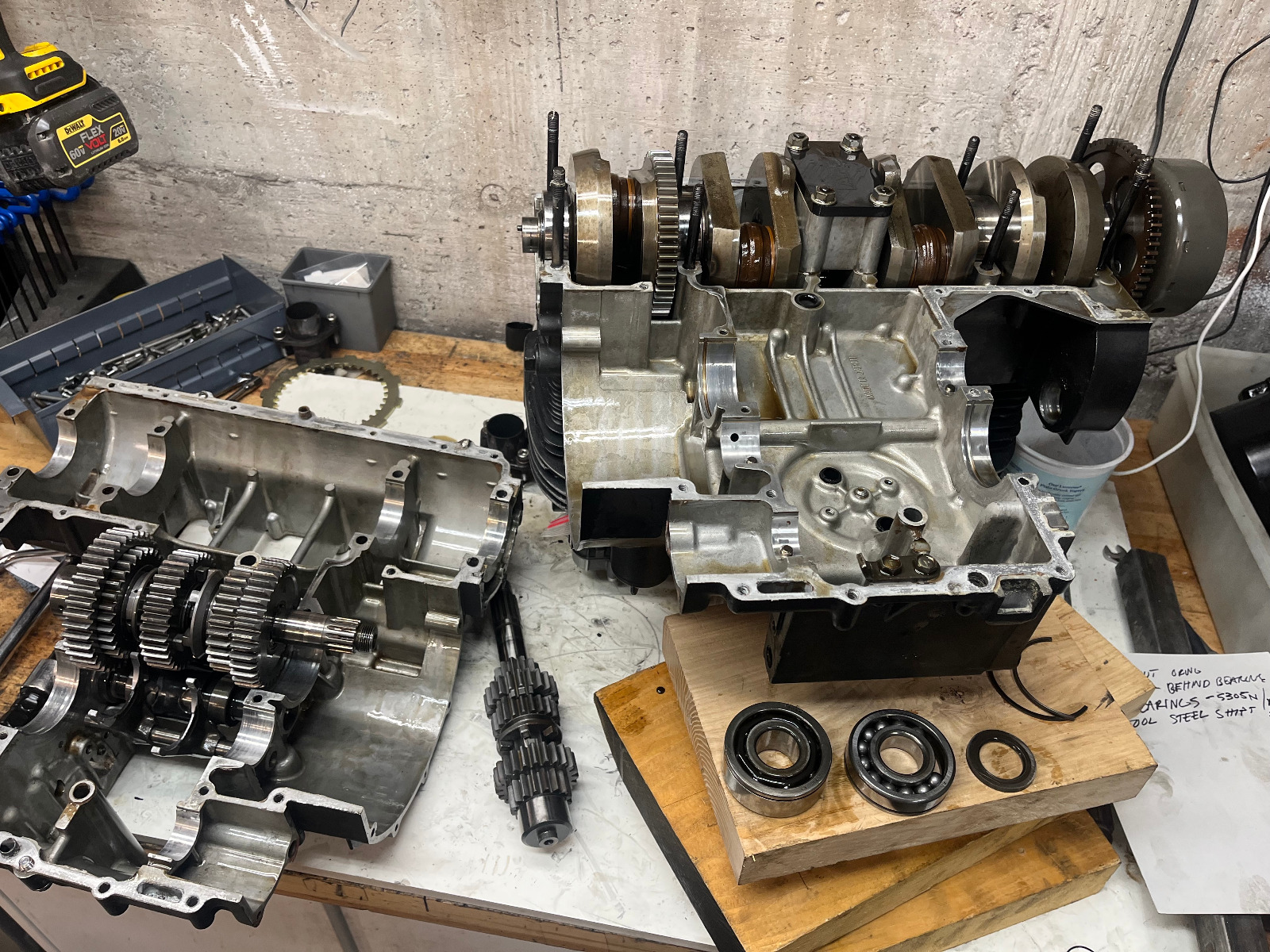

Engine pulled and cases split. Everything looks OK. It appears that i caught this bearing issue fairly early on. I'm going to replace both roller bearings on the trans, should i replace the needle bearings as well? looks like the outer race for one of the needle bearings is NLA.

Hi Doc,I would replace all the needle bearings, given all the wear and tear and small metal particles you showed us in the oil pan!
(It would be a shame if you had to redo the whole process because of another damaged bearing, so maybe it's a good idea to think about it, right?...and hope and cross my fingers that nothing has gotten between the rollers of the crankshaft's main bearings!.

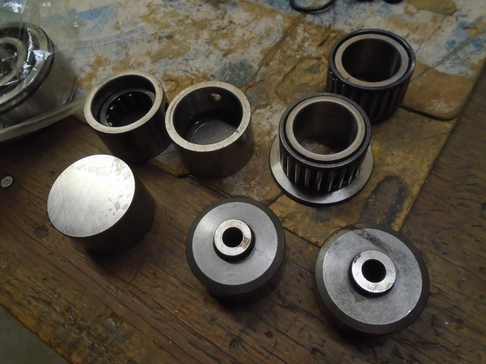

Might be NLA but they are out there Doc. I have cleaned-up spares for a lot of the different 72-80 style trans clusters. Big thing is of course, new roller and outer race are only as good as the shafts they are running on. I'm sure you're going to inspect but make sure your shafts are worth the money you plan on spending. Do You have the Mark2 trans or something different?

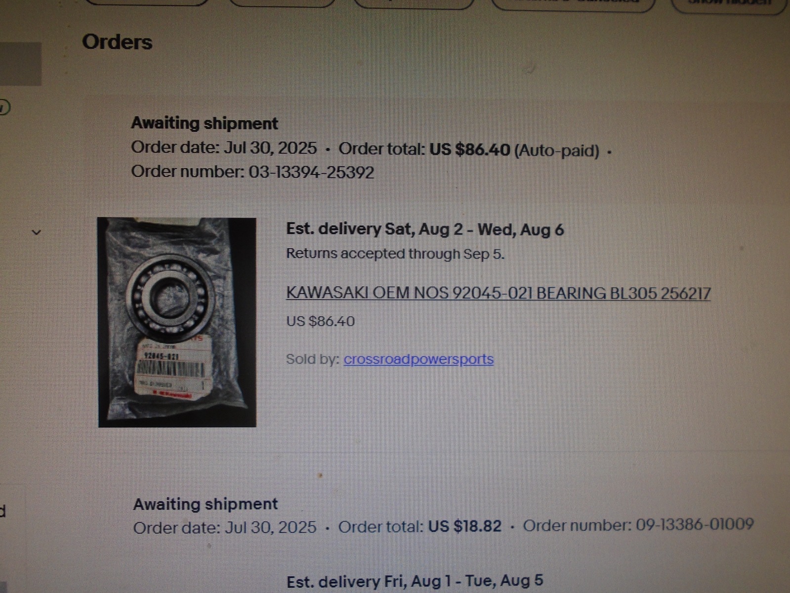

Not to be snarky Doc but You reminded i needed one of those bearings too!! Think i got the last one OEM one on ebay, ha. Rebuilding a Z2 Engine for a Friend in Virginia and he likes new shite.
