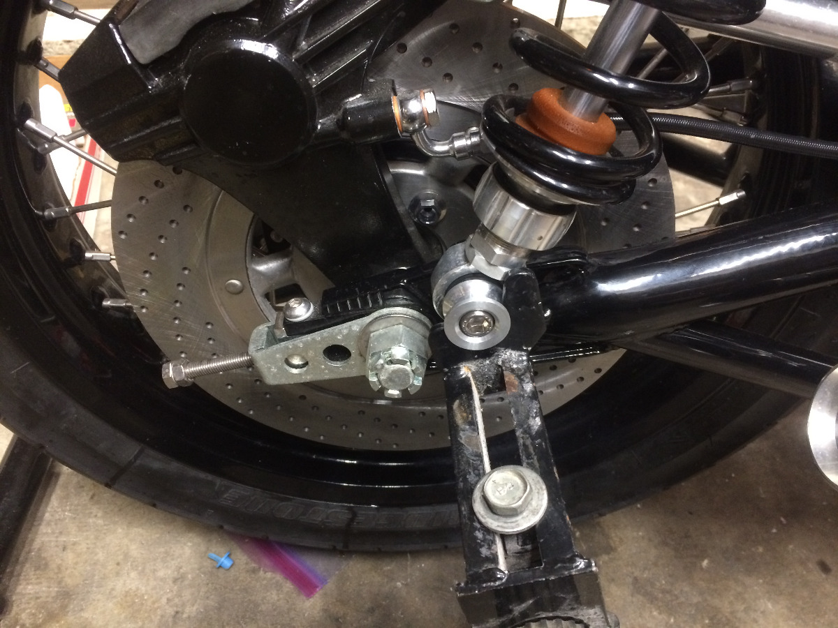

13 Aug 2019 20:10DoctoRot wrote: Lots of small things have been finished,including all the wiring in the front. Two things of note; One, I made some spools for the rear stand after knocking the bike off the stand. Luckily it fell into me and no damage was done but it damn near gave me a heart attack. With the spools and the stand it is VERY sturdy and cannot slip off as it did before. Two, I wasn't happy with the foot of the kickstand I made so I cut it off and remade it, the shoulder bolt also took some machining to get the spring to clear it. I made the stainless ball from scratch on the lathe for a throwback to the original kickstand. I think I might still need to add a tang on it to make it easier to kick out.
The only things left are:
Replace a few bolts with ARP to match
install clutch cable
install left footpeg/linkage
finish wiring.
6 YEARS LATER AND ITS ALMOST DONE
I have the same rear stand, and was wondering how to install spools to my 78 KZ1000.

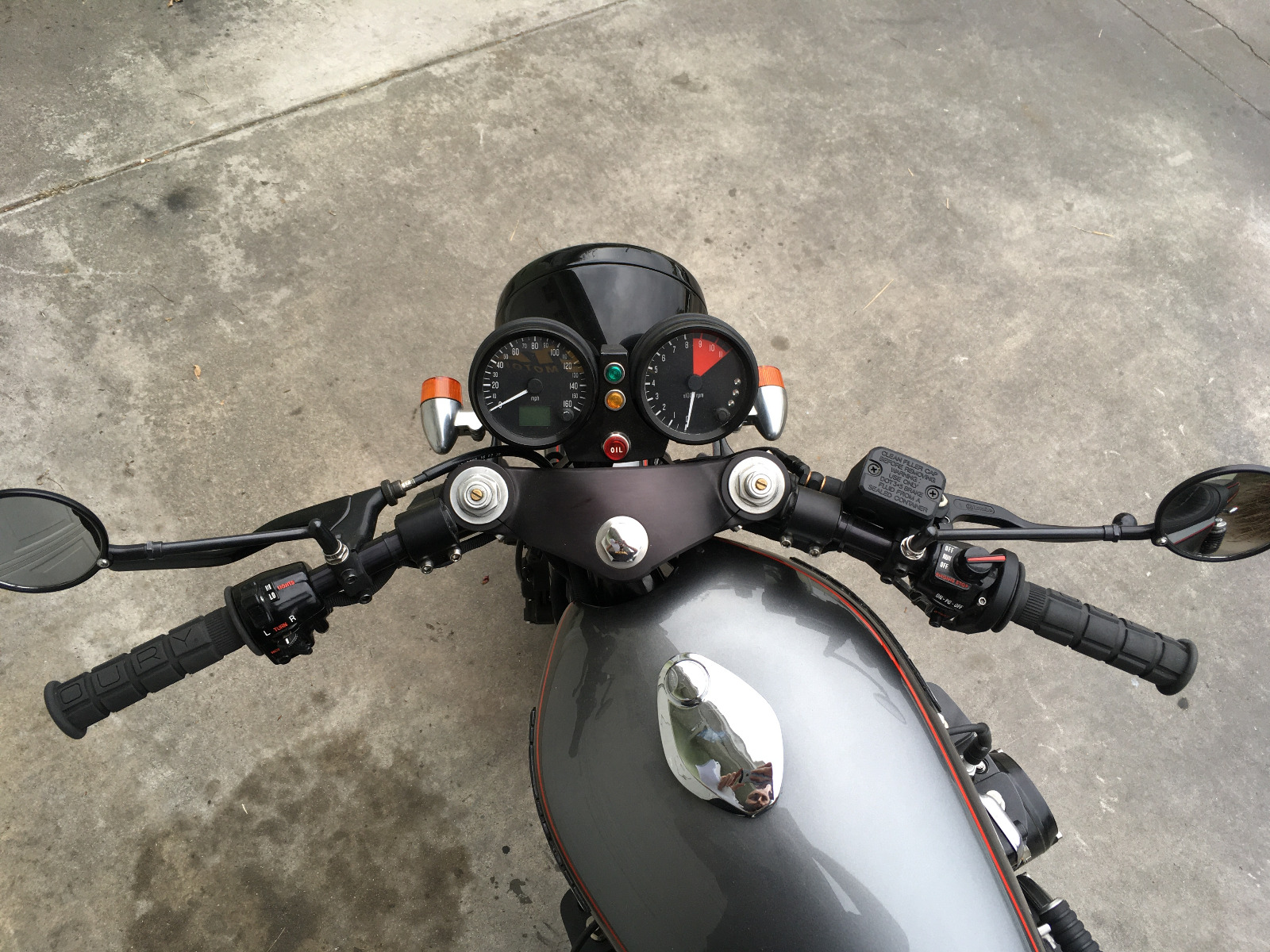

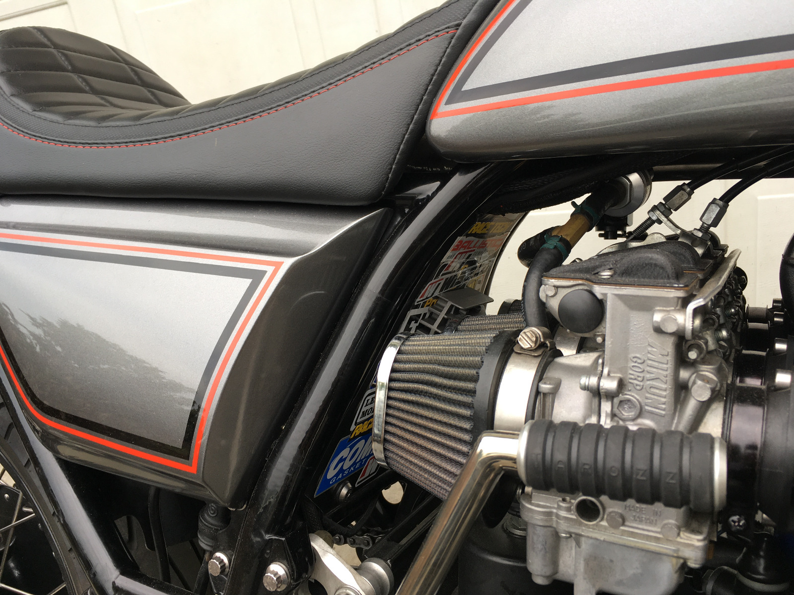

10 year anniversary of tearing this bike down the first time. I have been working on a slew of updates over the winter.

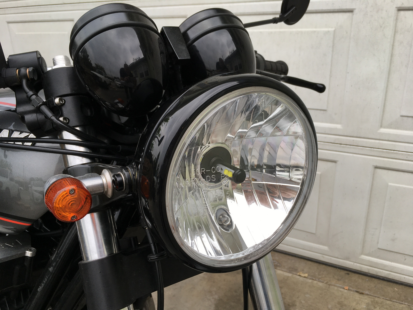

The wires from the HID unit were getting fatigued and mostly broken from having the inverter crammed in the headlight bucket. I swapped for an LED bulb. Its amazing how far this tech has come in 10 years. When I was first researching lighting I was turned off from the LED bulbs because they looked horrible. I don't mind this, its super bright and 1/3 the cost of replacing the HID.
the ZRX forks were fully gone trough by Matt Wiley from Racetech VIntage, now sporting new springs, gold compression valve, gold rebound valve - with HFR, and new seals and bushings. I also took the time to paint the lowers with 2K spray max black gloss. I thought the bike handled well before but I am truly impressed how this transformed the front end. It feels so much more planted at high speed and hard acceleration out of turns is vastly improved. 10/10 would recommend.

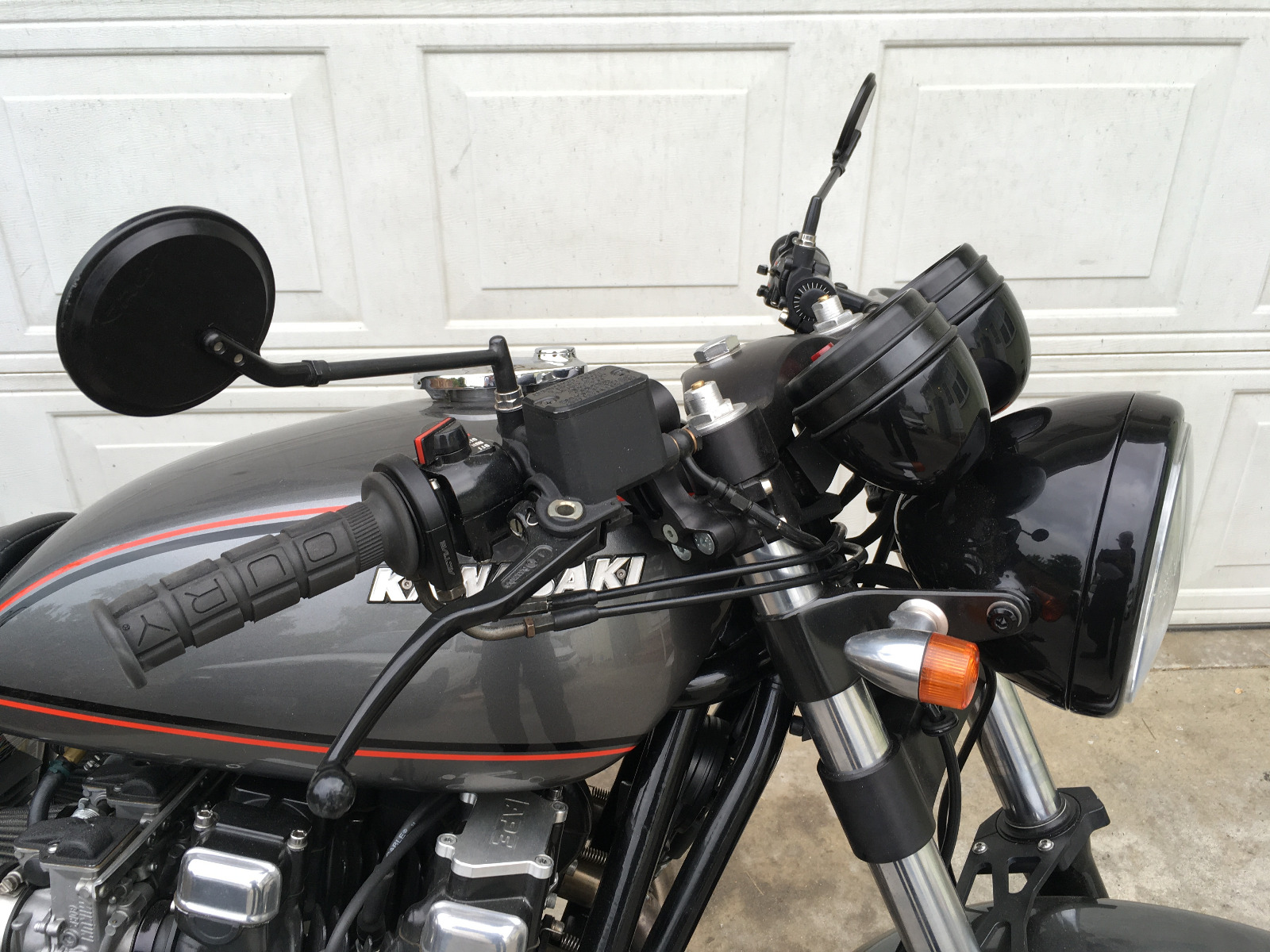

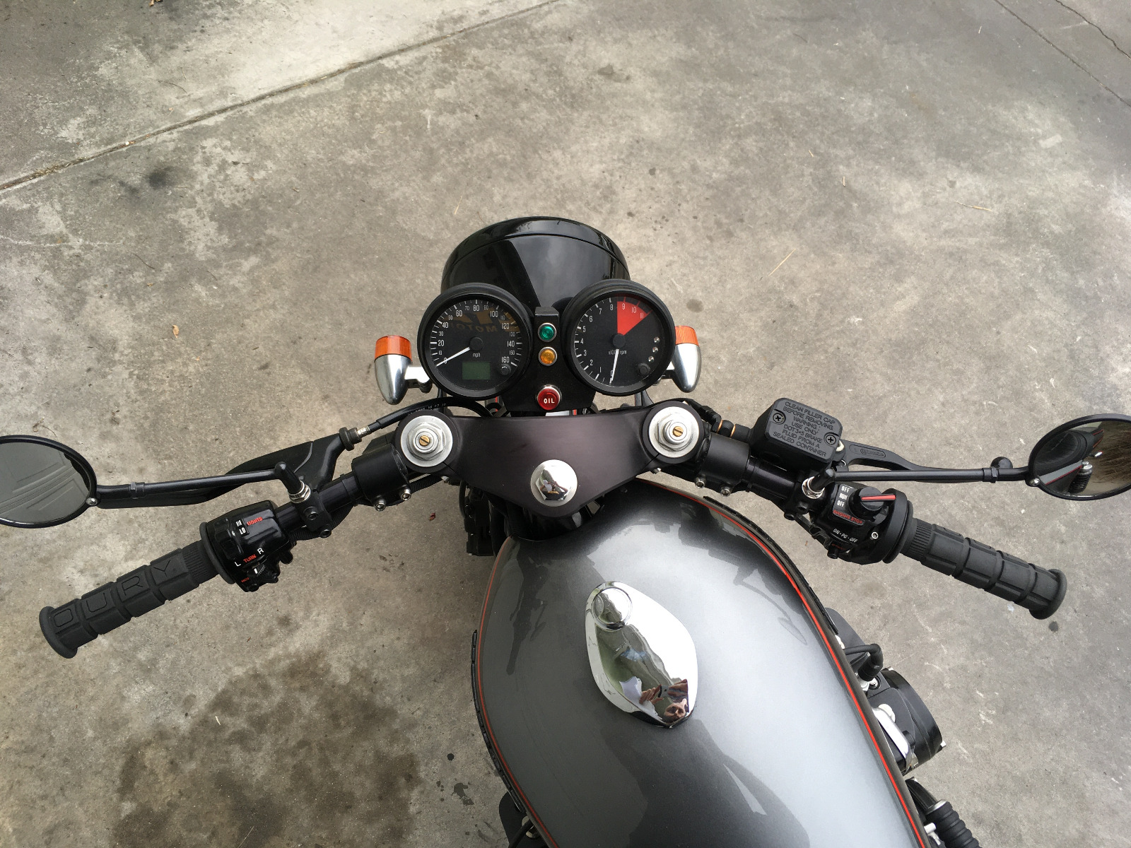

Goldilocks handlebars: Superbike bars too high, Tarrozi clip-ons too low, These new woodcraft clip-ons are nearly perfect with more rise and pull back. The riding position is more comfortable, and I love the way they look.
The new clip-ons required new brake lines. I had to change to a splitter to fit the MC on the handle bars as well. I took the opportunity to black out everything. Custom ordered from Graystone Systems - highly recommend these guys - good prices and fast turnaround.
The tach started having issues reading the pulses so I sent it back to Speedhut and they made good on their lifetime warranty. they upgraded the chip board to their new design.

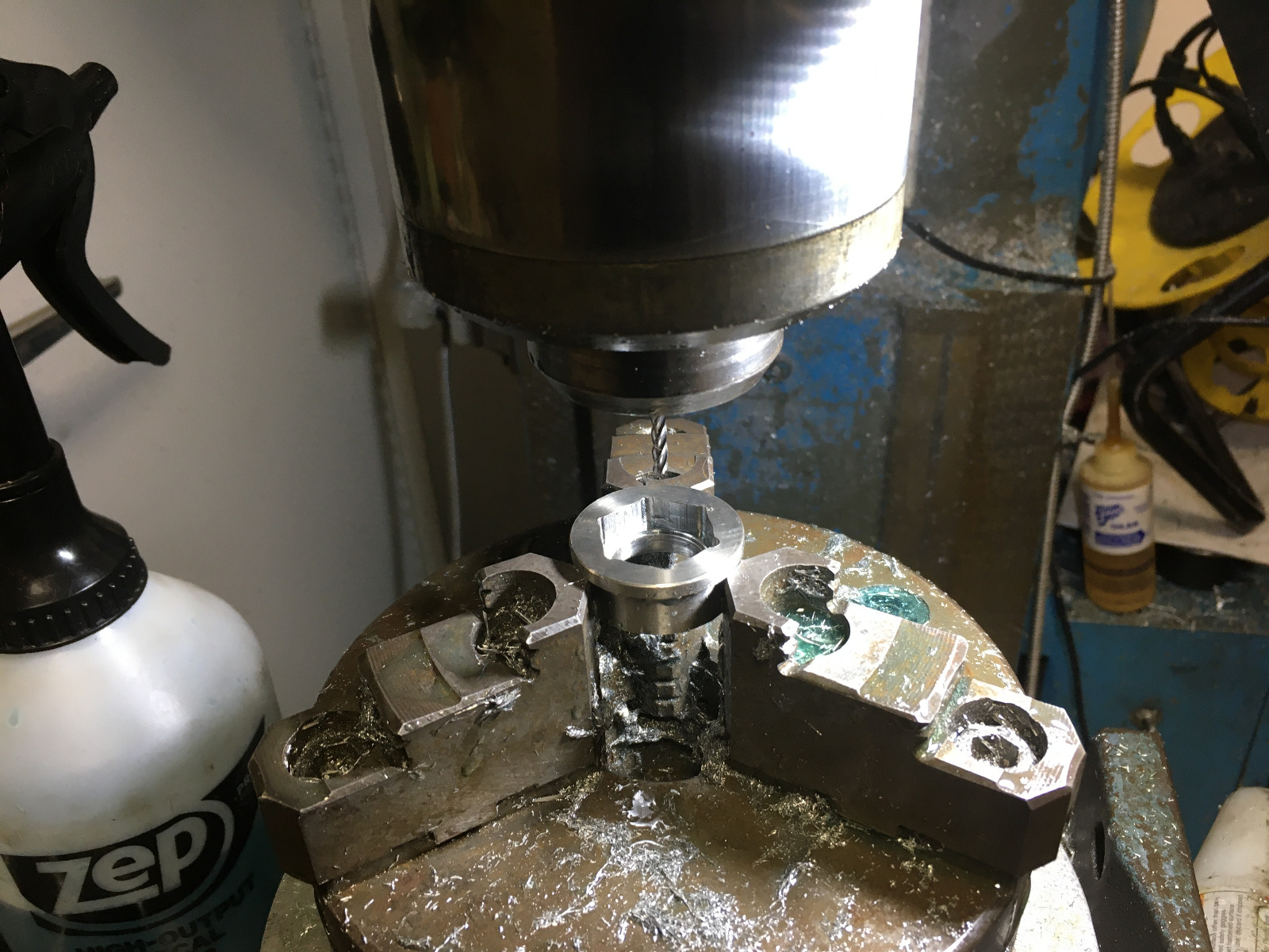

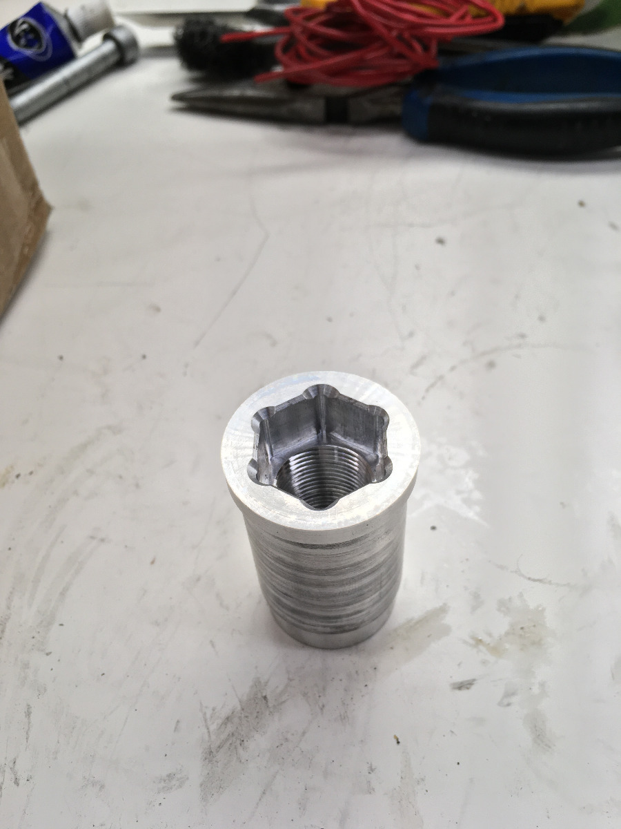

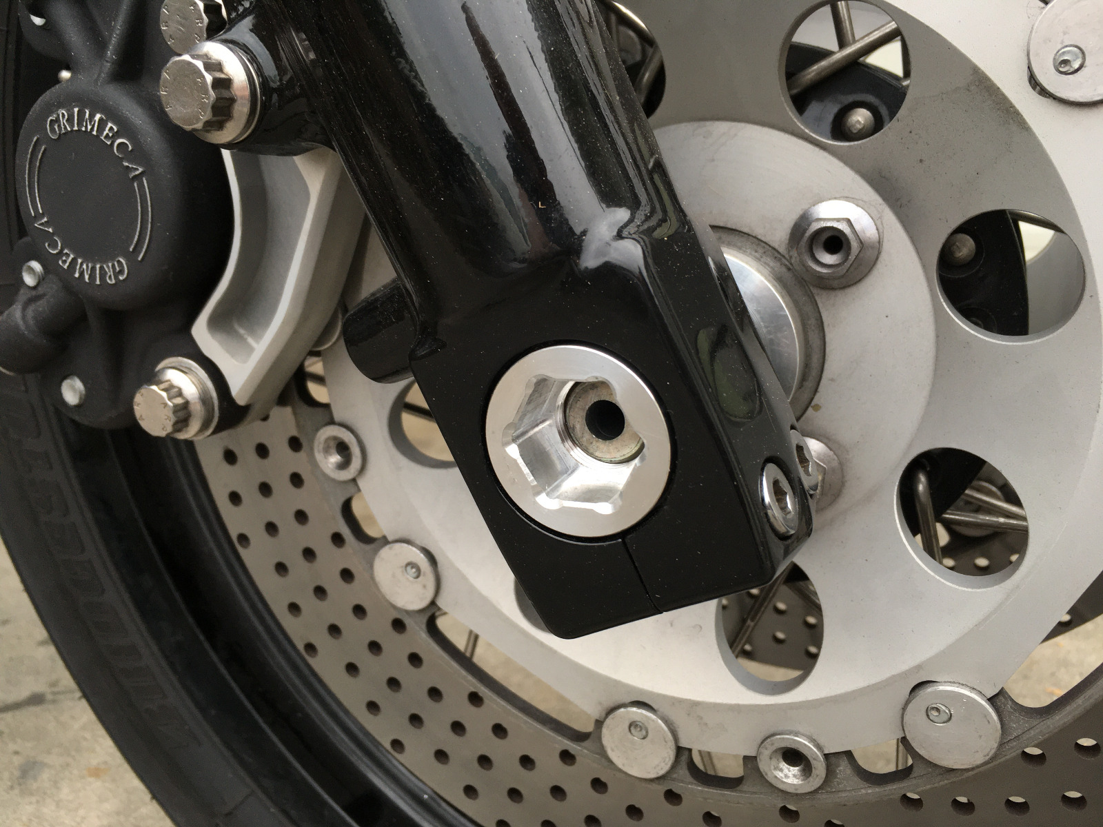

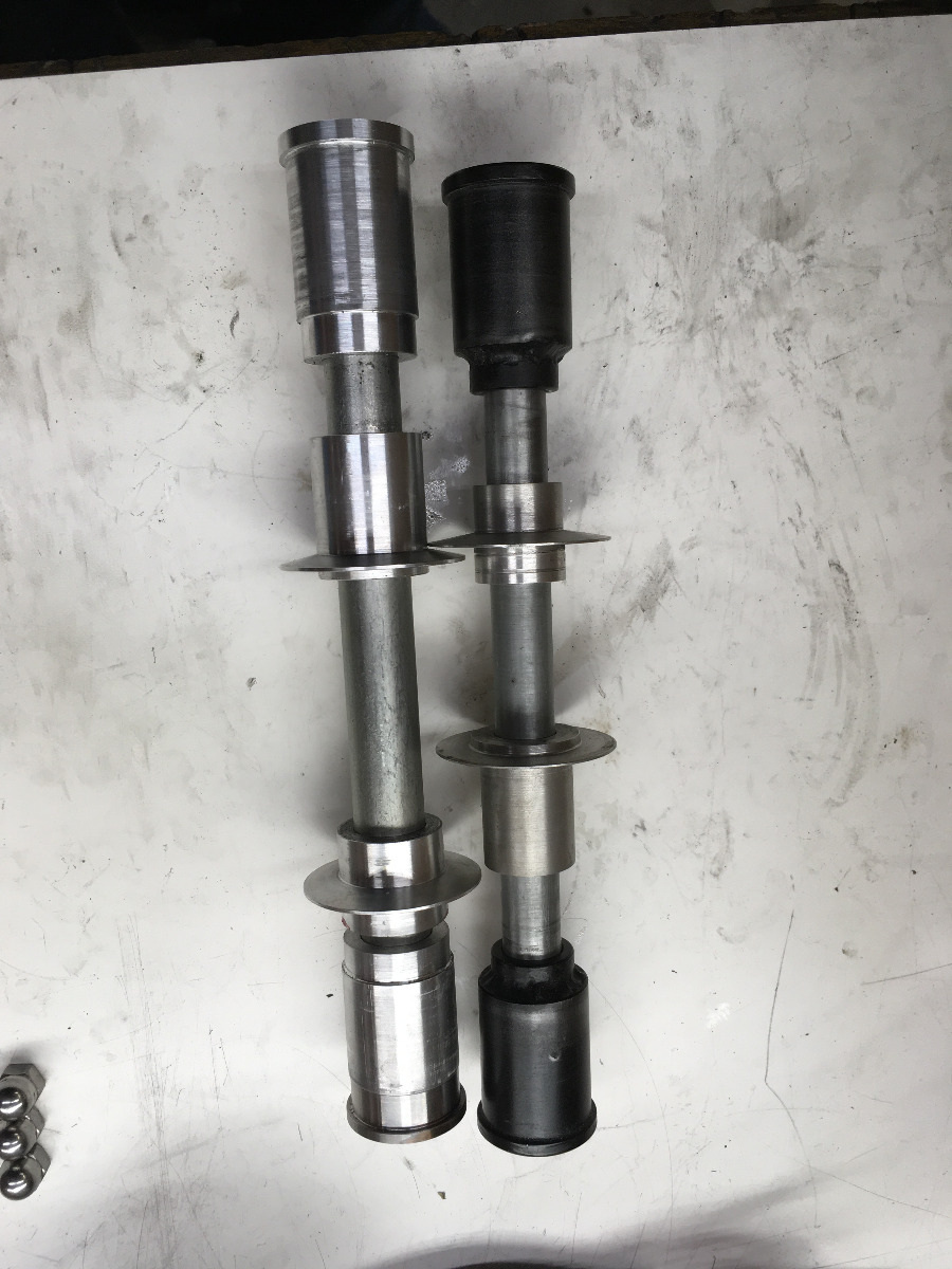

I fabricated a new front axle, increasing diameter from 17 to 20mm. I remade the spacers, and nut with aircraft grade 7075 aluminum, The other end has a 316 stainless nut i machined and welded to a hollow GSXR axle. including bearings the assembly weighs 8oz. less than previous. Making this axle is something I wanted to do for a while. I'm not a pro machinist so this took me 30+ hours of machine time with a couple screw-ups along the way. However it forced me to get better indicating parts using a 4-jaw chuck on the lathe. I love stuff like this.

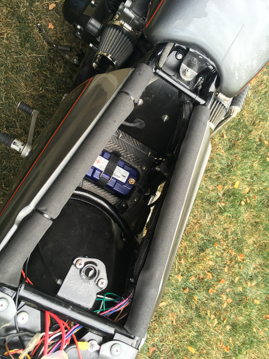

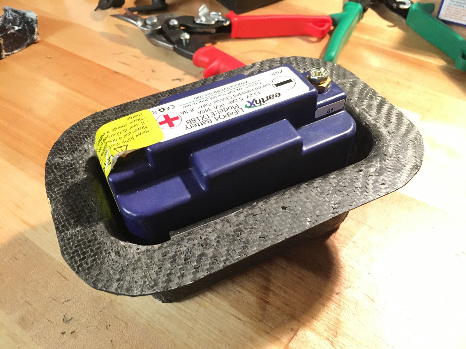

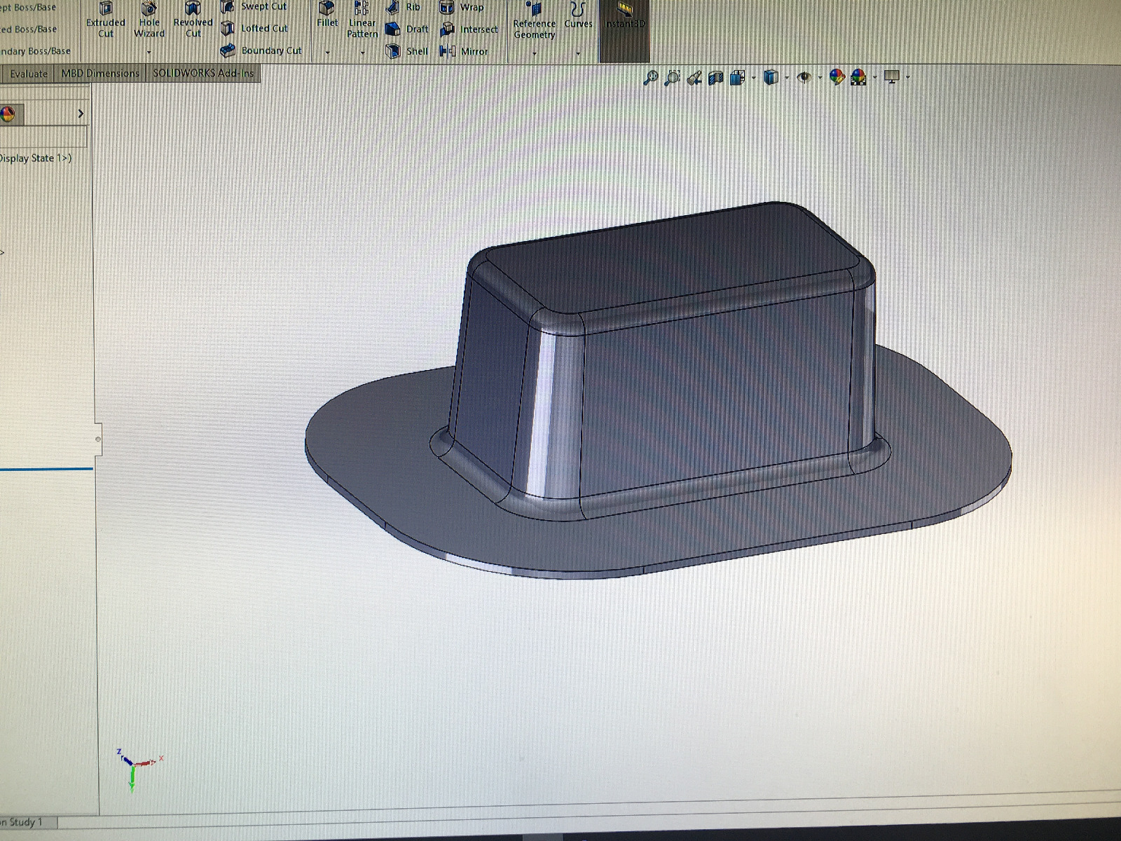

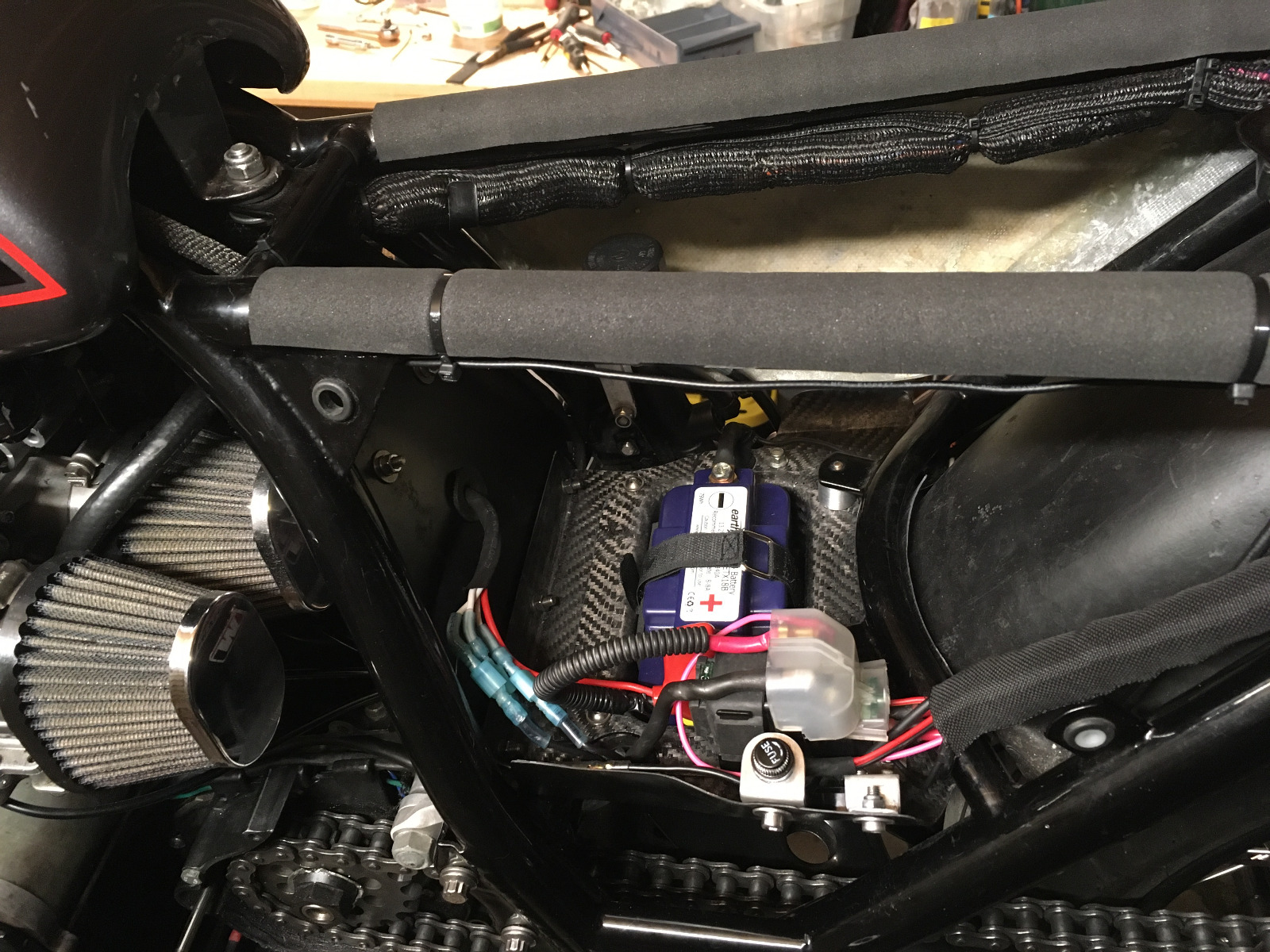

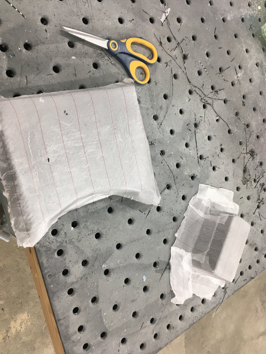

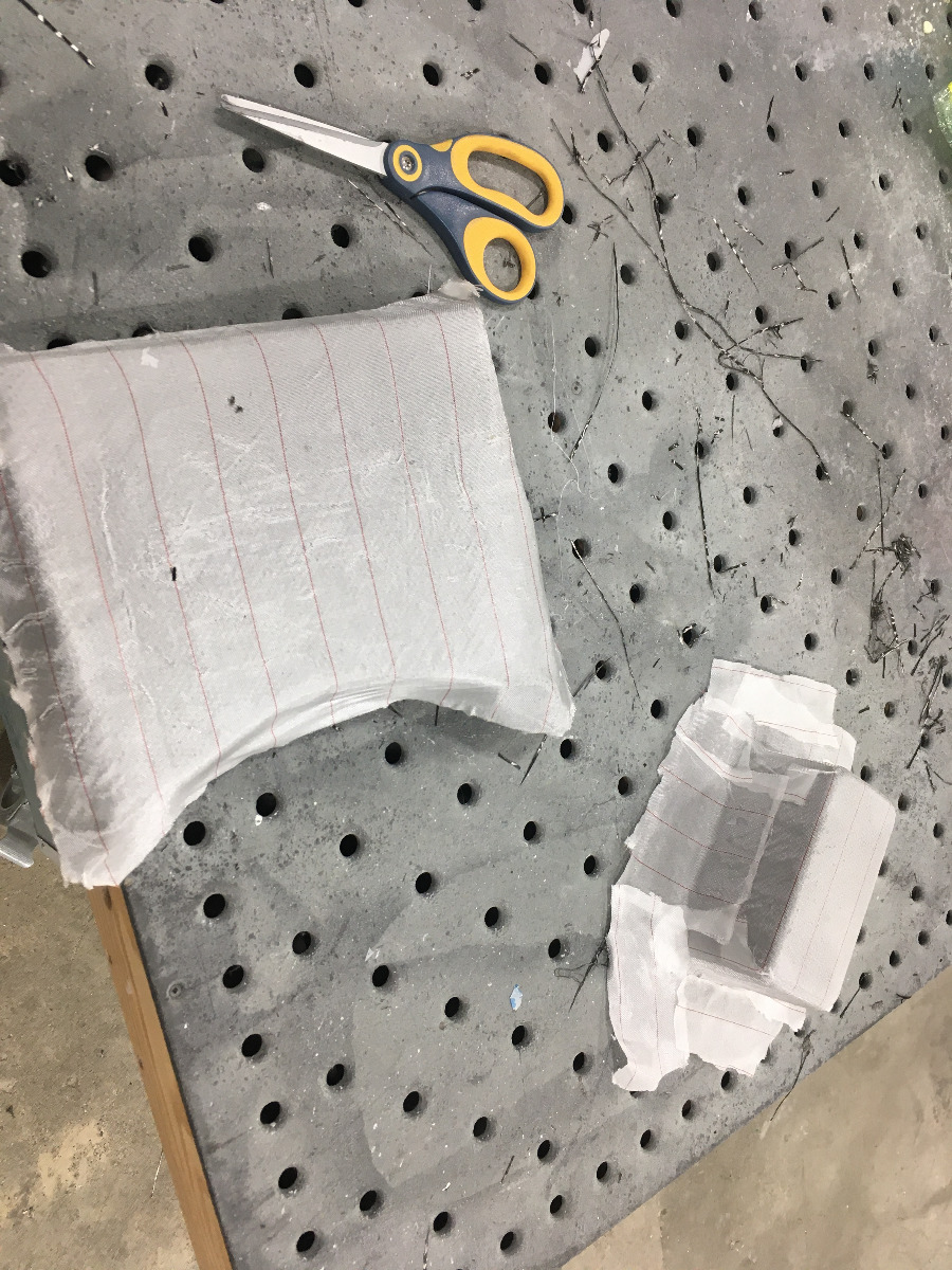

After 10 years and completely draining it a couple times the Ballistic Battery I was using finally crapped the bed. Unfortunately Ballistic is out of business and even more unfortunately all replacement batteries I wanted were bigger than the battery box I made previously. So since I had to re-make the battery box to accomodate the new battery I decided to re-make the entire tray and clean up the wiring while I was at it. I'm currently in a very small garage with no real fabrication tools available, but luckily I have cool friends and a buddy (Carbon Fiber Yoda) offered to help me make the tray and battery box out of carbon fiber.

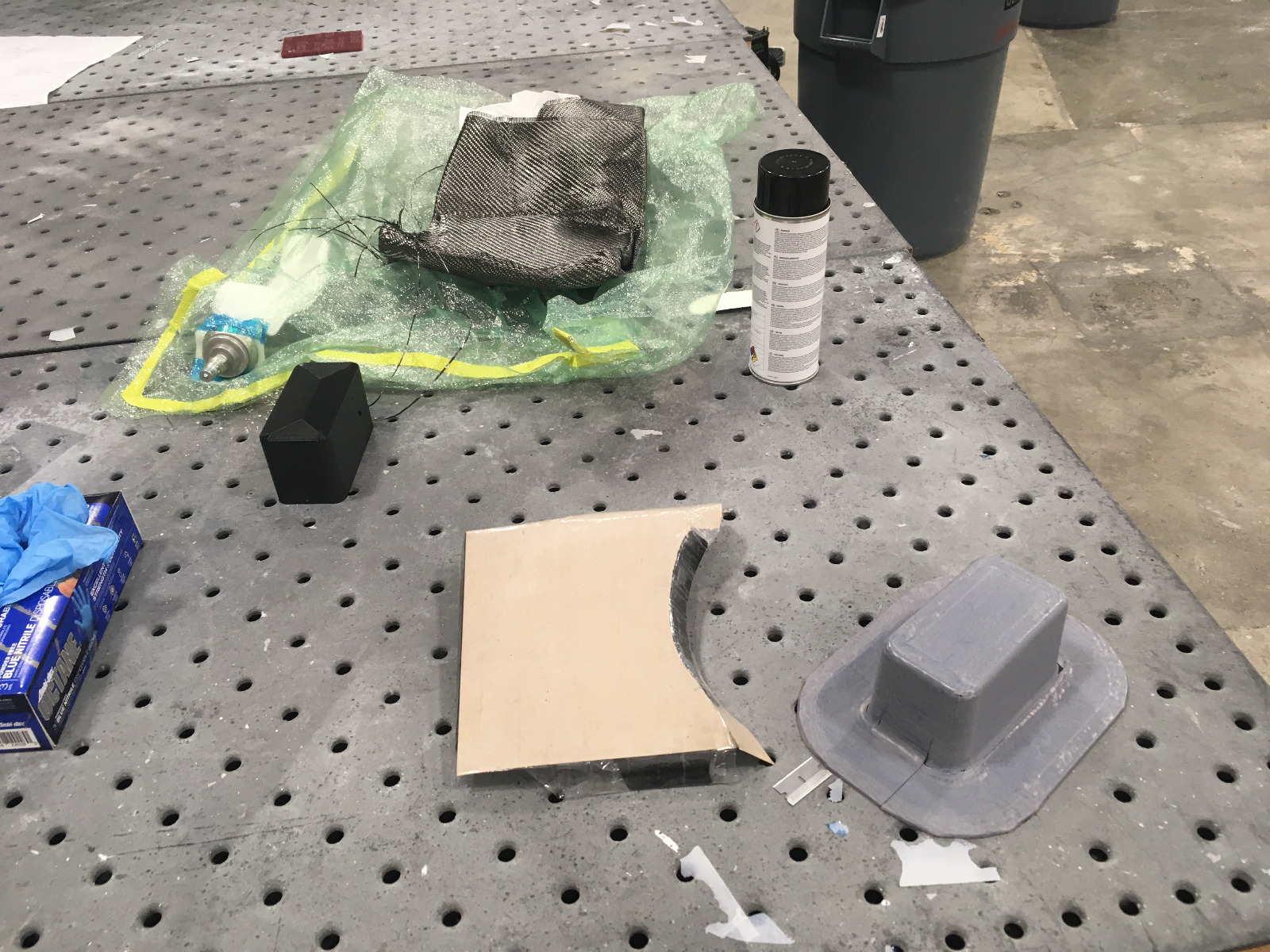

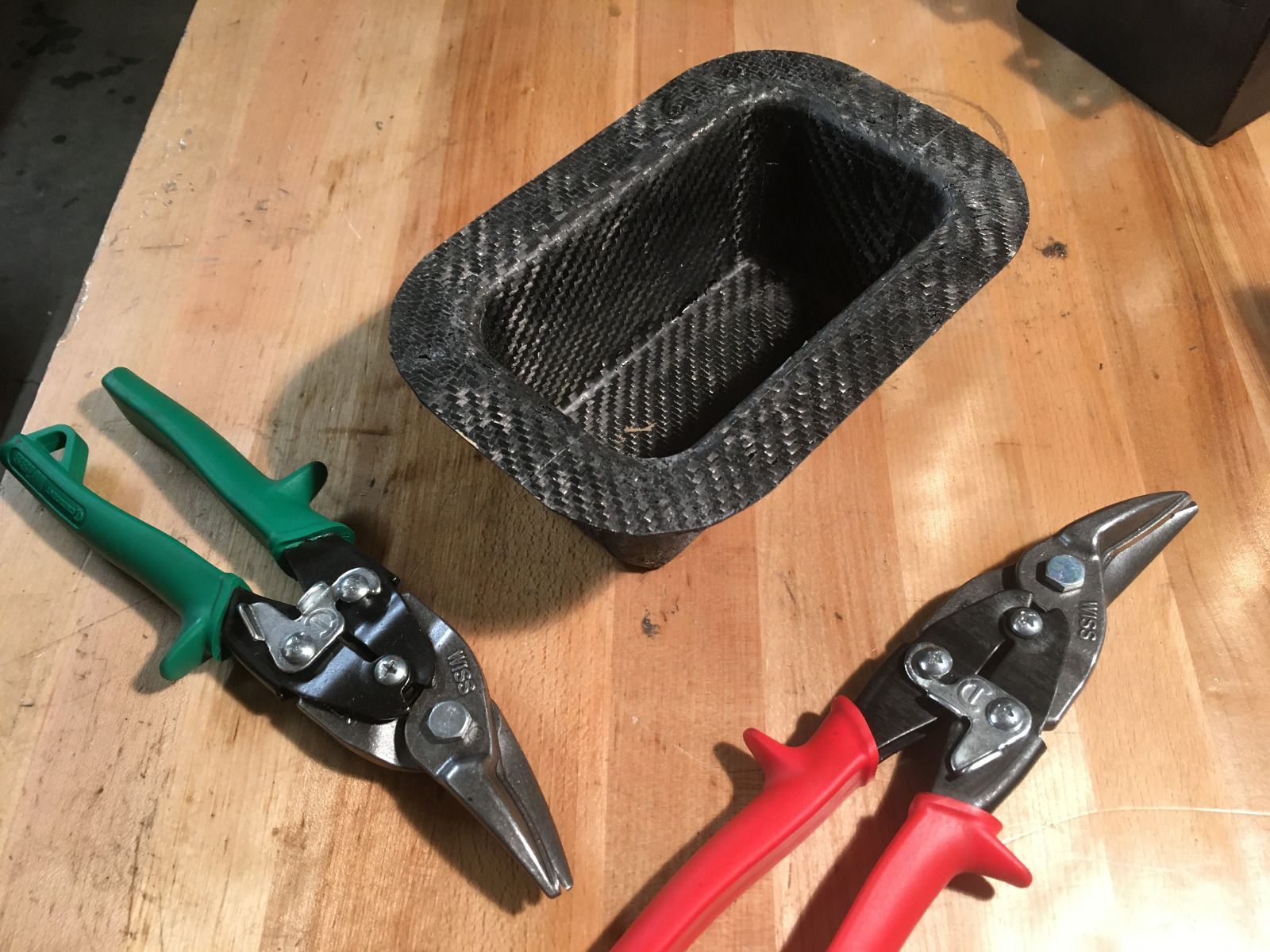

I went with an EarthX battery because they have a 3 year warranty and are some of the only batteries for power-sports that have an integrated battery management system. I drew the new battery box in CAD and designed it with 3% of taper to aid in removal of carbon positive. Carbon Yoda then 3D printed it, and then covered the plug with Teflon tape. I used the old battery tray as a plug and filled in the holes with cardboard before coating with packing tape.
We did a wet layup on the outside of the parts and vacuum bagged them both. The battery box is crazy light - 2oz! While i was at it I also replaced the OEM starter relay with a more modern Suzuki relay with integrated main fuse and power output. I re-made the RFID key mount and the fuse mount for that - this really cleaned the wiring up. I ended up painting the outside of the battery box black because carbon fiber bling is not wanted.
I love having this storage area under the seat; I use it to run errands because i can store small stuff. Its also great for storing a sweater/warmer clothes if im going to be out all day/night
