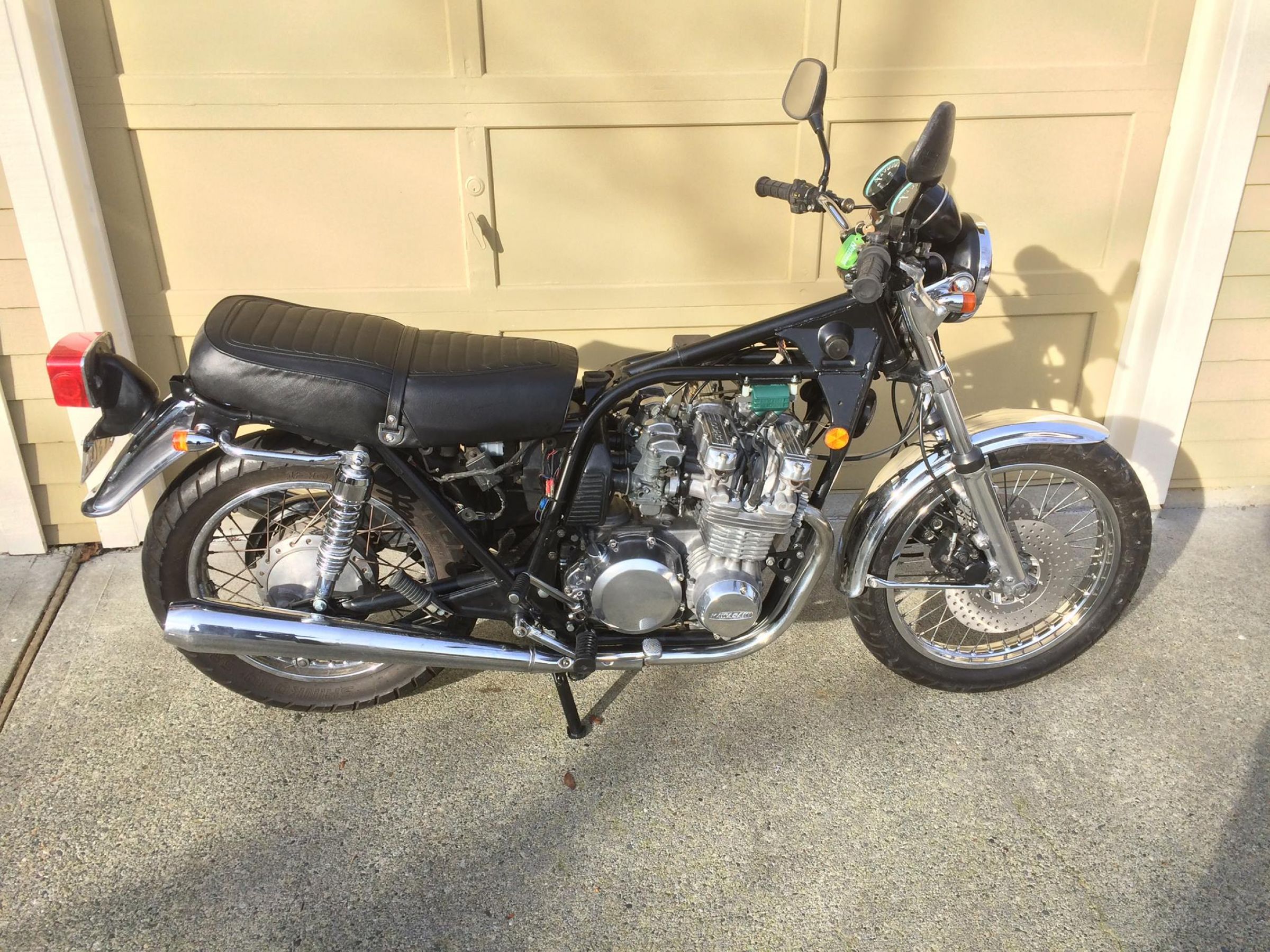

Ok time to get back on this thing. I have been distracted by work, school, the holidays, traveling...blah blah blah. I ended up doing some mods on a buddies kz650, polished the cases, new rotors, and new seat cover. body work is out for paint currently. Im jealous, this thing runs sweet.
Anyway I have made a list of stuff I need to do to get the 1000 back on the road.
> rebuild the forks.
> Re-install head. (I had to take of the head to drill and tap the emission ports for some set screws to plug them, also there were two stripped screw holes that i didn't see the first time around. so that needs to go back on.)
> Install carbs
> Finalize battery tray/ electronics position
> plumb the brakes
> install new chain
> WIRING
> tuning

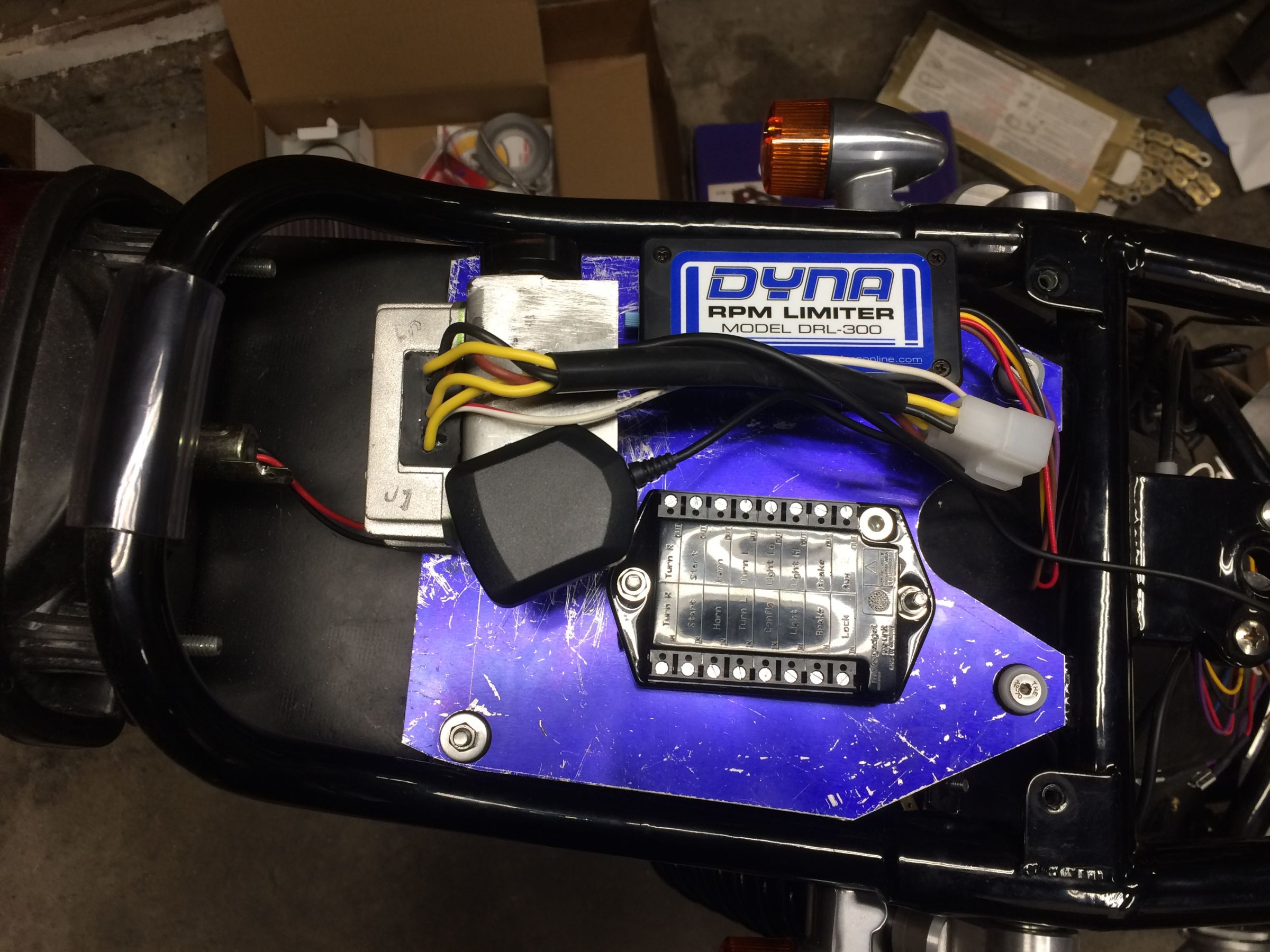

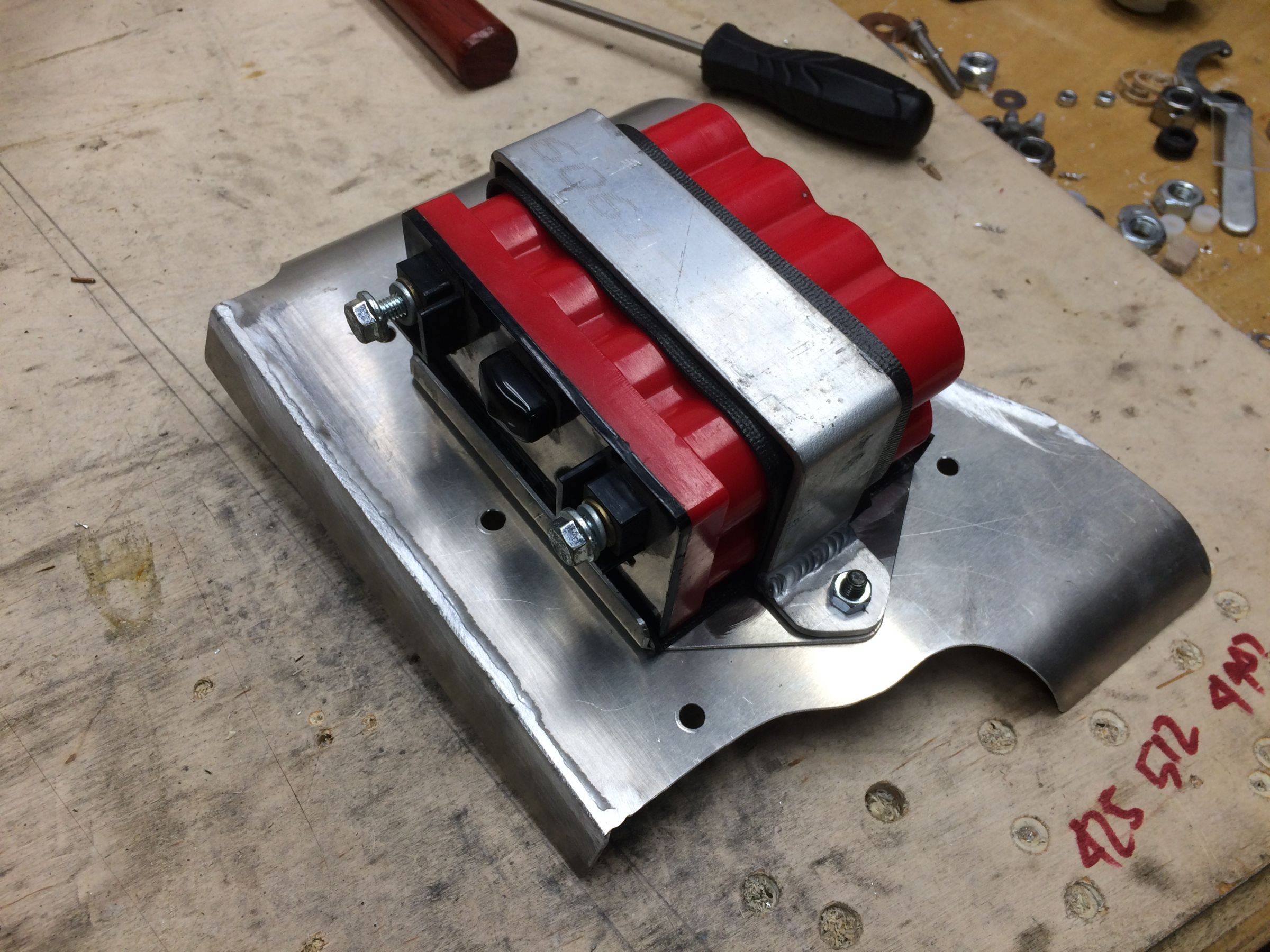

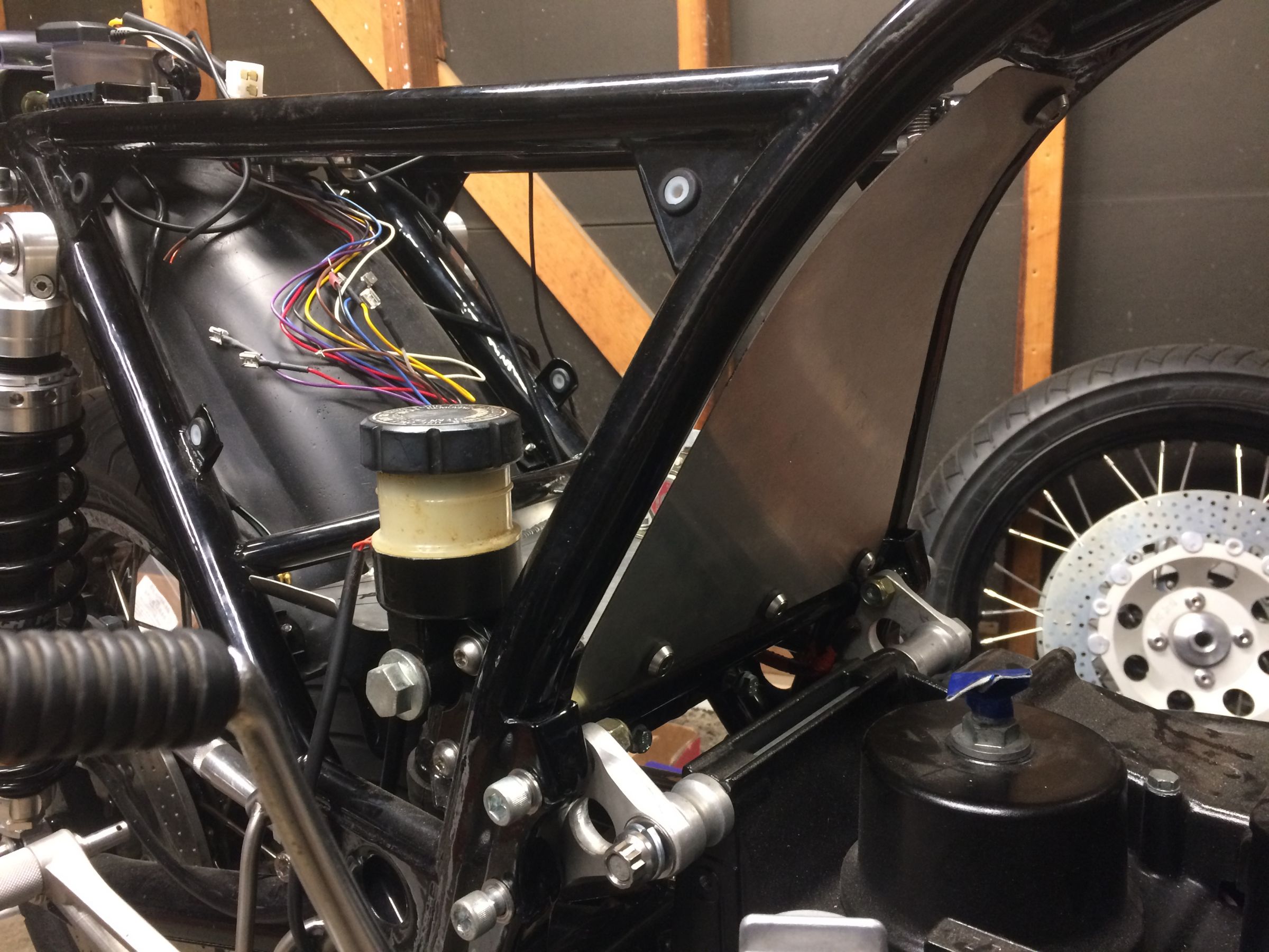

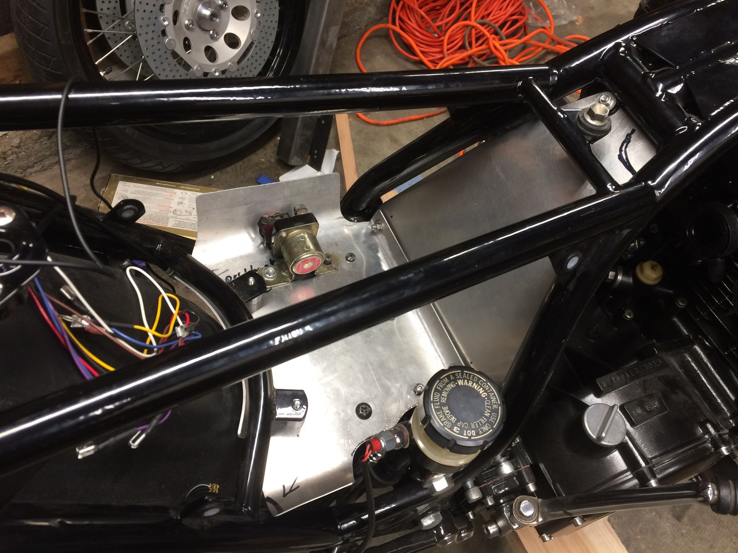

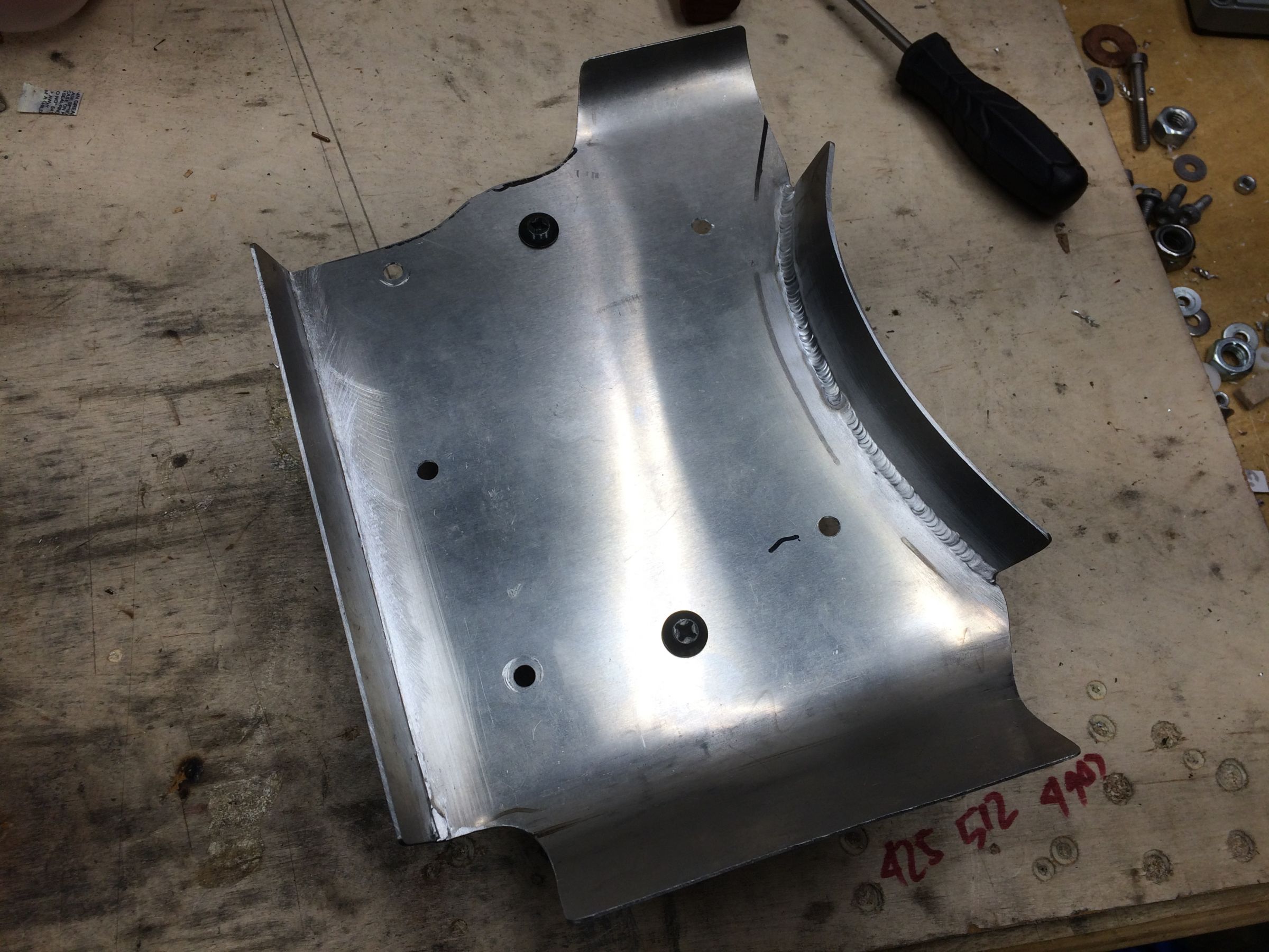

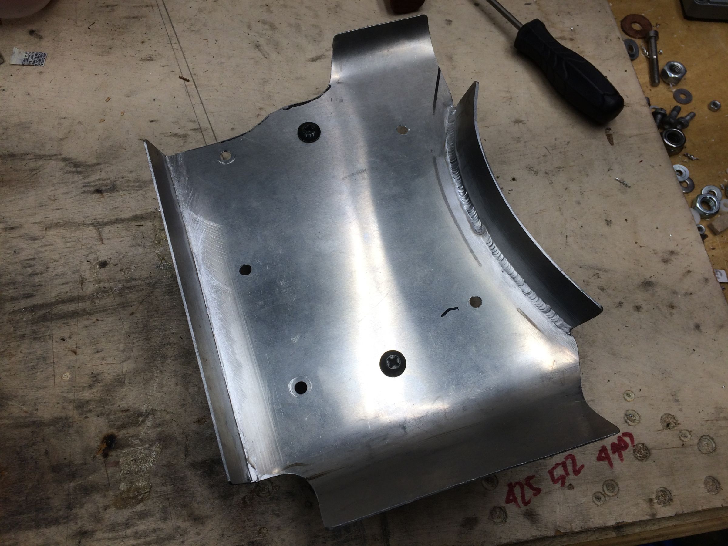

Battery/electronics trays finished and rubber mounted! gotta pull them off to massage a couple small spots and then paint. With the sidecovers on it will form a pretty big storage space which is something I loved about the stock bike. I can easily fit a sixer in there
Also got the head back on and the motor buttoned up.

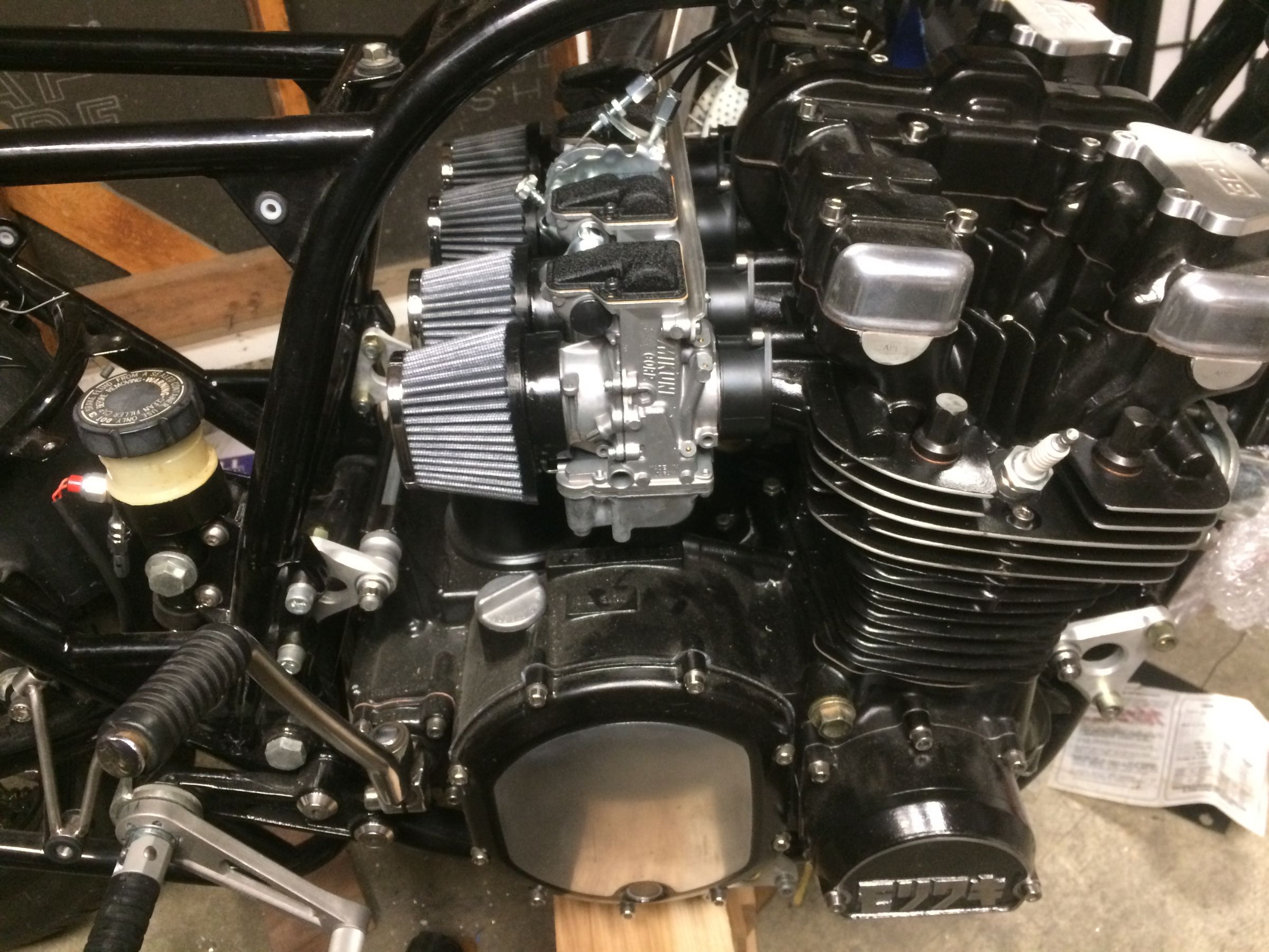

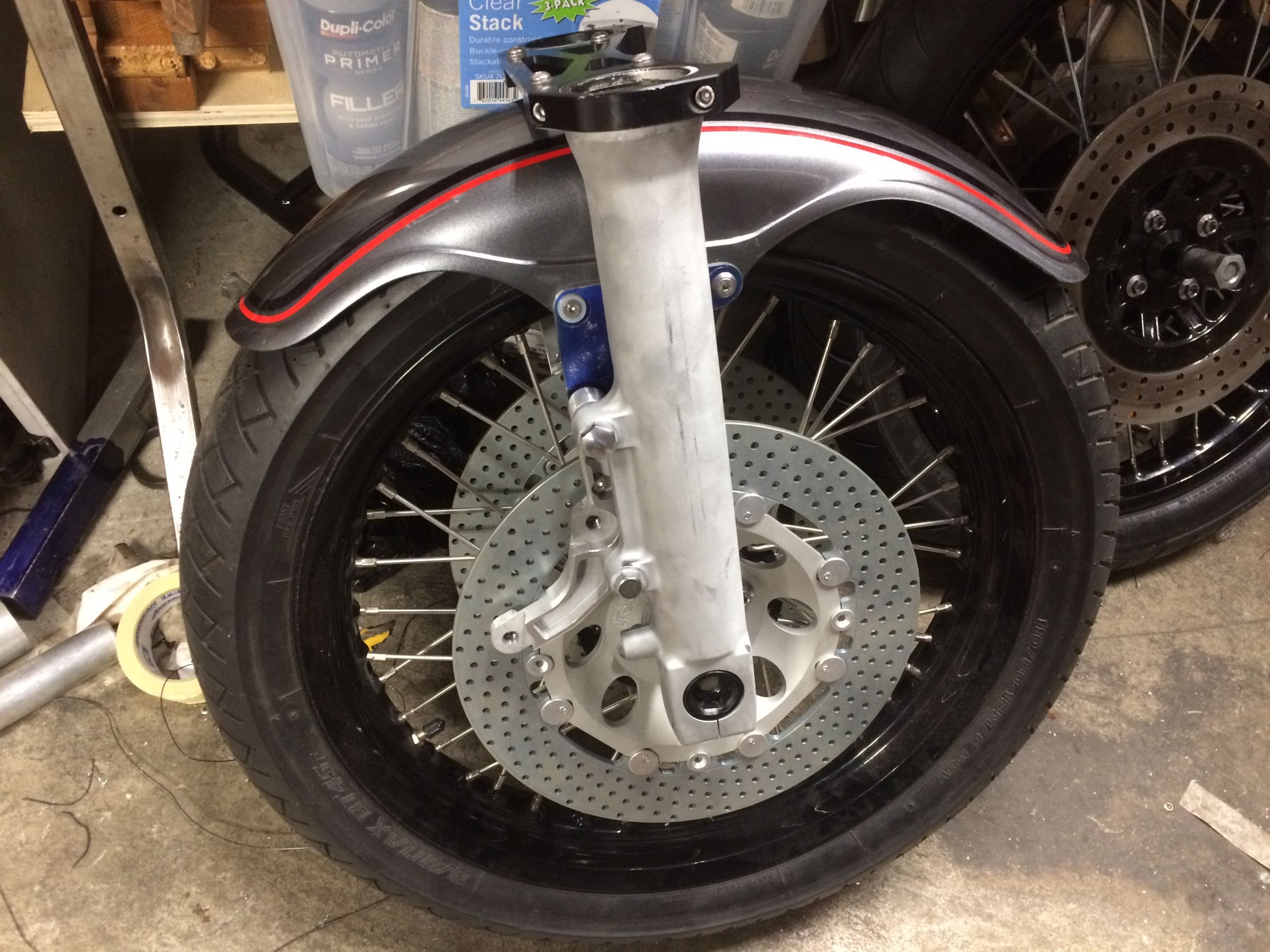

Rebuilding the forks turned out to be a bit of a debacle. when I got the dust seal off there was deep pitting on the stanchion tube which is what caused the fork seal to leak. It was surprising considering the condition of the forks otherwise. Tracked down a new set and am waiting on new bushings before putting them back together. Fork legs will get new paint.
Because I remade the caliper mounts with them on the inside of the fork legs I had to remake the fender mounts. They will get paint soon as well.
I splurged on these RS34 carbs this summer. I got them test fitted to check my cable length, and to figure out a support for them. Any suggestions where I should start with jetting? motor has Wiseco 1075, mild cams, street port and polish, and free flowing header.
