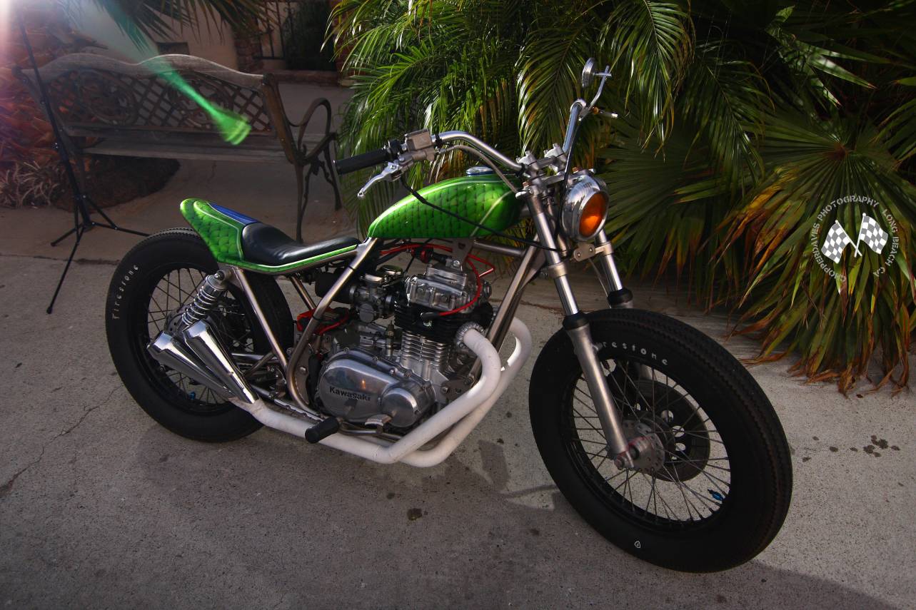

Thats a very pretty 400 leon... I'm looking to go an olive green. Not army green but kinda close.. I am hoping to tuck in her back lights and such and get a leaner look going but not sure how much stripping I wanna do as of yet...
