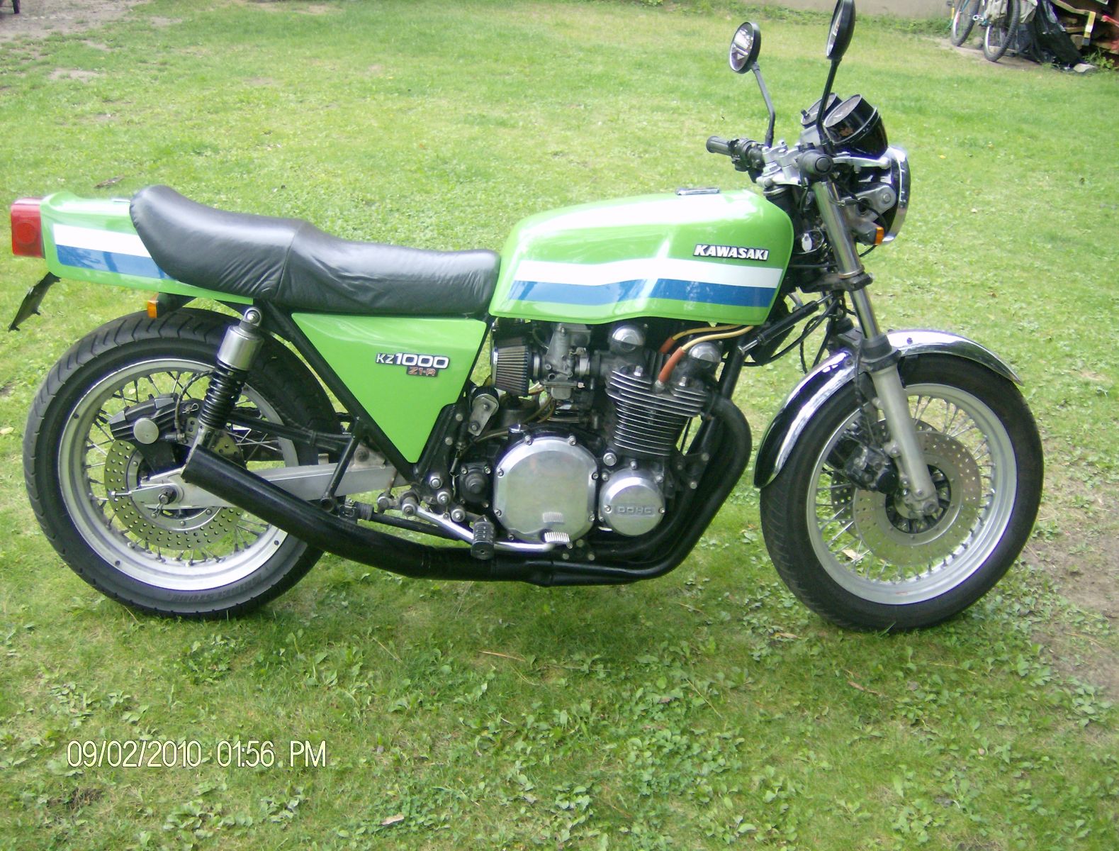

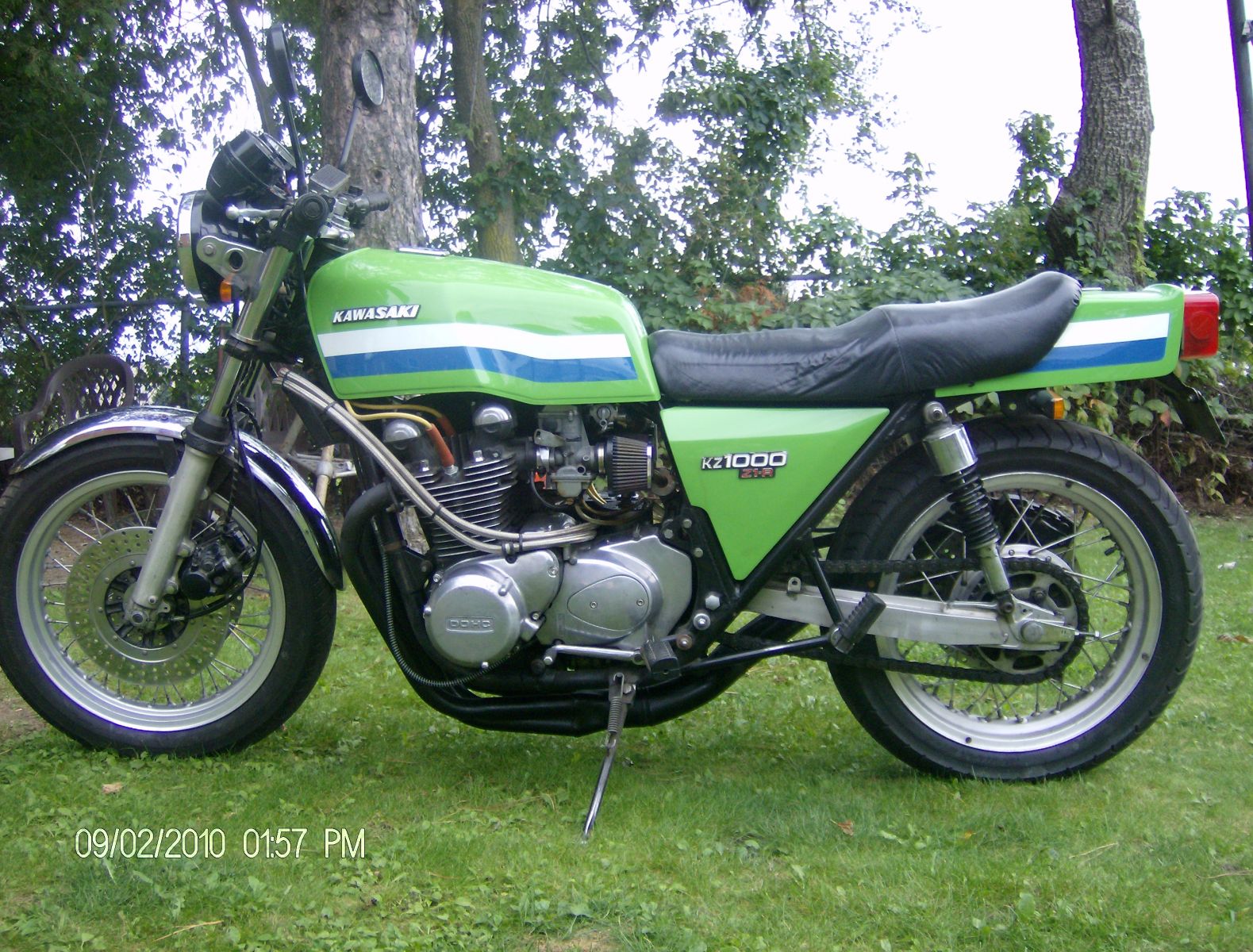

welcome!
i have to ask if the tank was freshly painted without anyone looking inside ? :sick:
as you have learned z1r tanks are hard to find.although they do turn up occasionaly.
you could do like jaffasaki did and use a tank from a j model/mk11 .
they do not look to outta place on z1r's in my humble opinion.
a pingle will take care of the petcock. z1enterprise can hook you up on it.
my fuel sending unit has never worked well enough to depend on it.you can cap it off with a flat plate.
i use my odometer for a fuel guage.can you clean the rust outta the tank and then pressure it up to check for leaks?there have been some pretty crappy tanks repaired and used.
p.s. les is right about ebay and
redlinecycle.com/ocindexmain.html

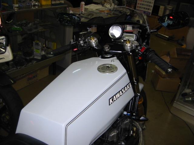

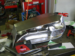

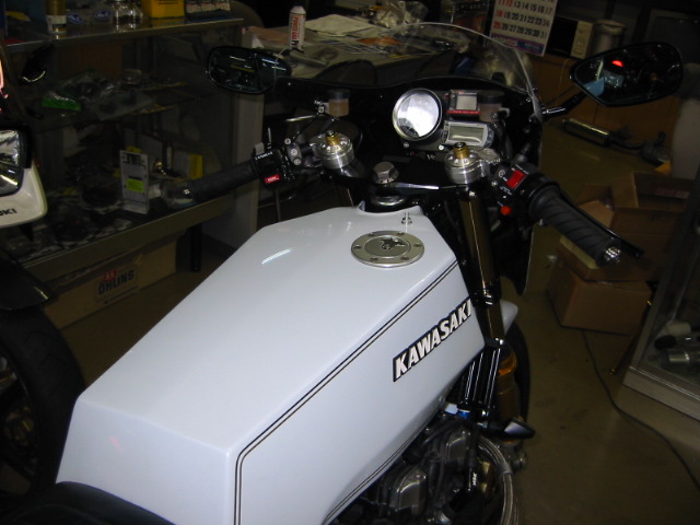

how tight are your fab skills ? :ohmy:
rob the tunnel out of a good kz,mk11,j-model square tank and fab the rest :whistle: .
as long as your carbs don't have any broken pieces they can probably be rebuilt.
