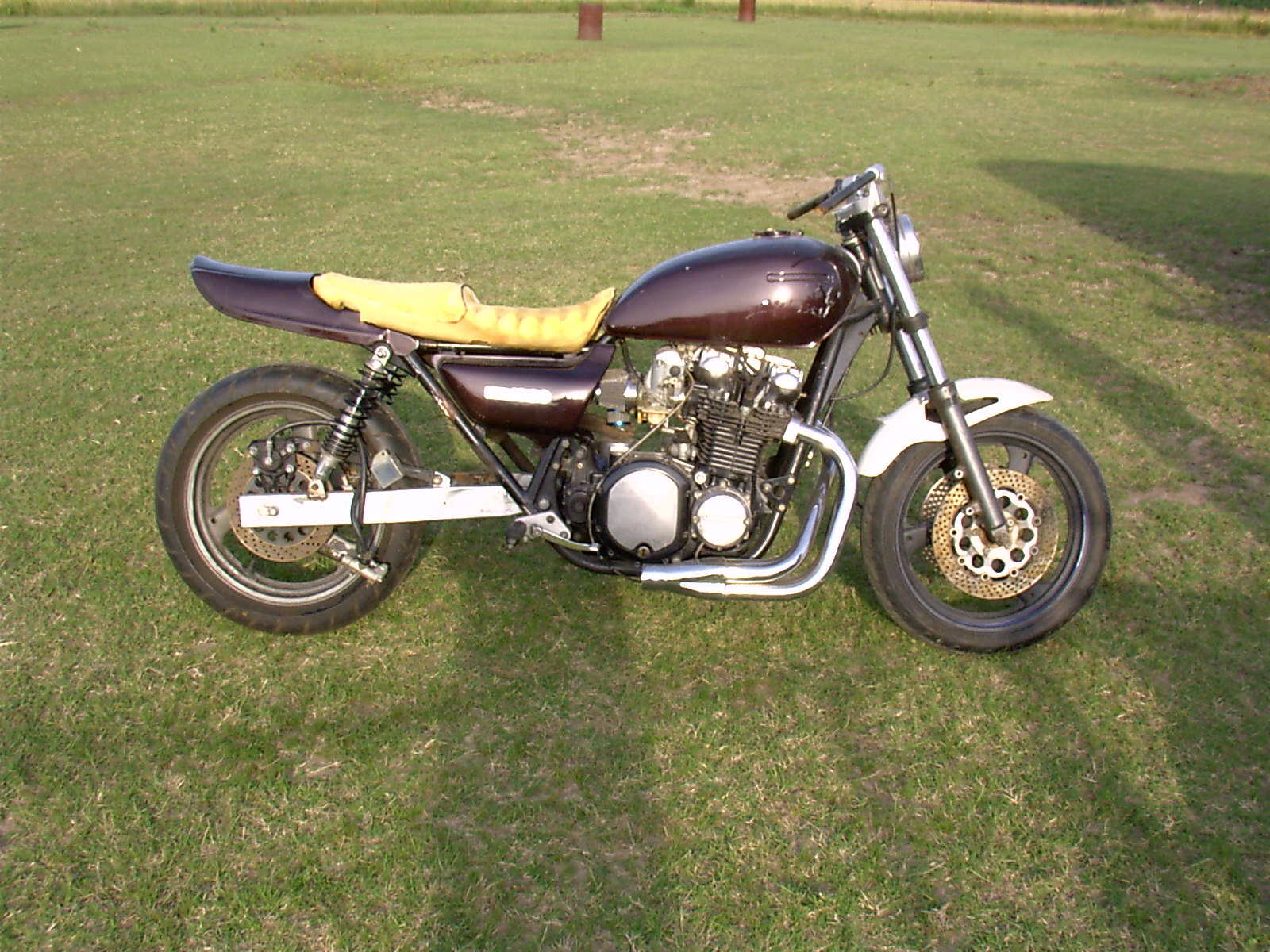

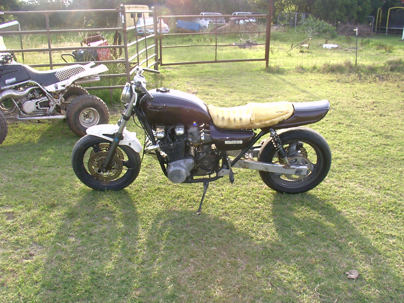

soo... i have slowly been obtaining parts to "upgrade" (in my eyes) my 1980 KZ1000 ltd... i know i am missing a few things such as clevis style shocks, chain, rear axle and some spacers, and rear tire 160/60/18... i was wonderring if anyone had some tips/advice/parts or anything that might help me in this process? also what length chain are you using with the gs1100 swing arm? heres a few pics of what i have...
parts list: suzuki gs1150 swing arm/1987 kawasaki ninja 750 rear wheel, hub/sprocket, rotor, and rear brake system

so it finally happened! the deal i have been looking for finally came my way. i picked up this 1993 Suzuki GSX600F for $250 delivered yesterday and plan on using the parts in my KZ project. i plan on using the complete front end to do a swap on my bike. and i may be changing up the GS1100 swingarm and using the swingarm/wheel & tire/brakes off of the 600 katana and welding some sort of mounting tabs for the rear shocks on the swingarm. has anyone used any parts off of this bike on their KZ? as always any helpfull tips/suggestions are greatly appreciated!

The Katana stuff is pretty much bolt in.
Conversion bearings for the forks, a little clearancing so the swing arm fits between the frame rails.
Add shock mounts and get the chain sorted out, and you're all set.
The swing arm is about 4" longer than the stock KZ1000 swing arm.

thats exactly what i was looking for! thank you... so for $250 i got the front forks/brakes/wheel/tire and the rear swingarm/brakes/wheel/tire and still have the rest of the bike to play around with parts or sell and get some if not all of my money back! i believe allballs.com would be a good place to find conversion bearings? anybody know of a better place that they have used with no issues? also from what i have found online it appears that the katana swingarm is steel not aluminum? is that the case? if so then perfect cause i can weld to steel not aluminum!

Sorry, I missed this post. The swingarm is steel and easy to weld.
Also, AllBalls is the perfect place to get the bearings you need.
