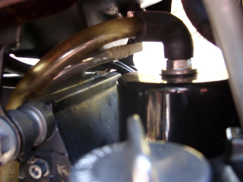

hello everyone ..just got my KraZy bitch out for the new season ......havent done much to her ....since last season ....but have plans for her real soon..the ???i have is after i put the pods on last season i rode it and such ....i just added a new breather filter ond hose fron the crank case where the hose went into the stock air box ...should i be getting any oil out of that set up i rode for 180 miles yesterday ...and at the halfway point i noticed a little spray off on my saddle bag right behind where i have the breather filter located .....after i got home i noticed it had more on it ...why would this happen ???

Would route crankcase vent hose to exit underneath the bike (see image below).
Imo, a filter on the hose isn't necessary.
Would sniff-test and examine condition of crankcase oil, to determine whether these is any gasoline contamination of the oil.
