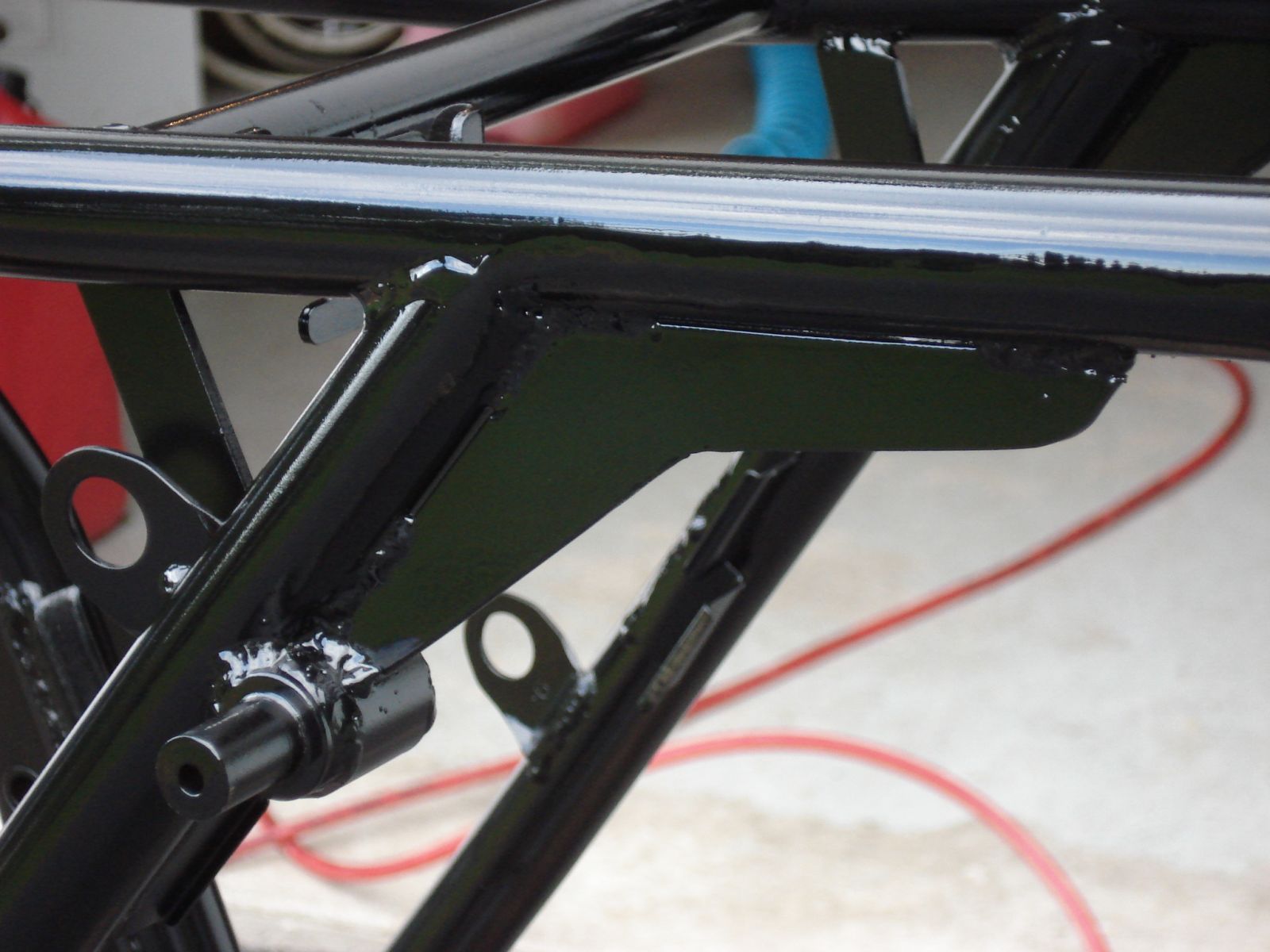

Version 2.0 on the shock mounts, I modded another frame. This time I did it a bit differently. It looks pretty similar, but I recessed the shock lugs 1/3 of the way into the frame tube, and I used one thin gusset, instead of two thick plates. The other two pics are stock, and the first set that I moved.
I'm back on the project full time til done. I'm hoping to be riding it next weekend.

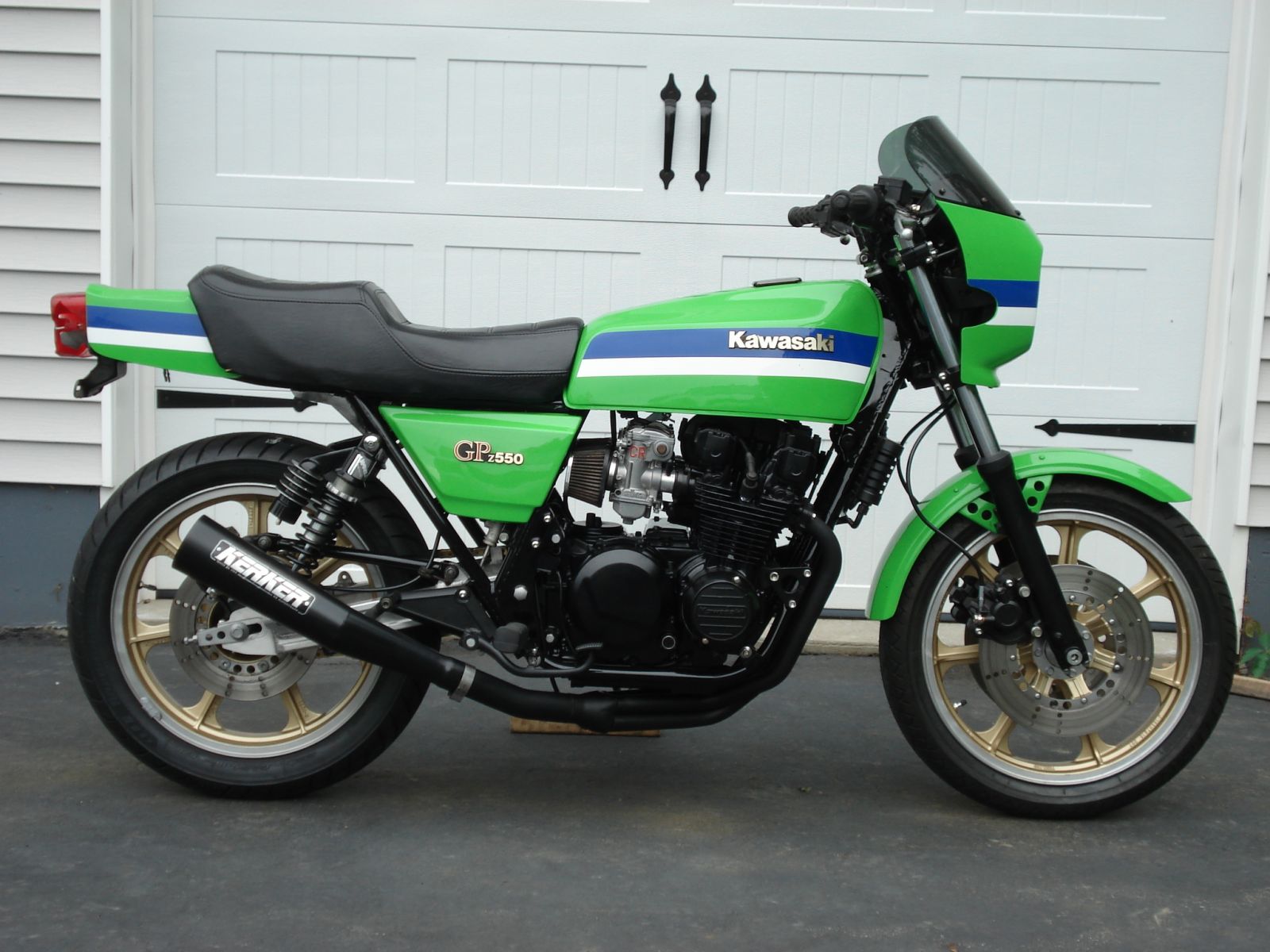

Almost finished. I need to cover some details, but essentially it's ready to be ridden (more like de-bugged and dialed in, anyway). I've spent about 65-70 hrs on it in the last 10 days, bring the total to probably 200 or so.
I'll probably get a flatter seat, and I've got to add some directionals.
