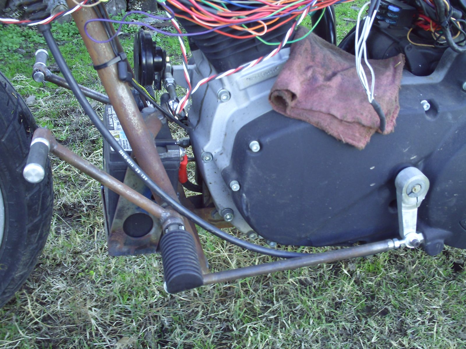

Got brackets made and rear sets mounted. Anybody have any ideas on connecting shifter linkage?? Where to buy linkage parts??

andrew i use 1/4 inch male heims from the local race car parts house in right and left hand thread(or not you just have to take one end loose to adjust,which is usually only done once).you can also just weld the nuts on the end of the tubing.i then use 1/2 diameter .090 wall chromo tubing fro the tubing.
the heim ends(rod ends) are also available through jegs or summit.
