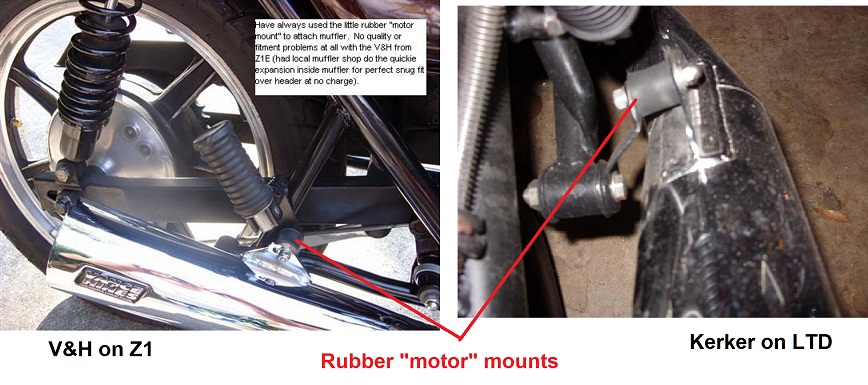

Carb -- Sometimes the pad at bottom of enrichener plunger becomes worn and fails to completely seal the starter fuel passage when the choke lever is pushed all the way down. Am thinking this condition might contribute to the excessive richness coming off idle.
Vibration -- If not already done, would assure that the header pipe or collector isn't touching anything underneath the engine, such as a drain bolt. And that the muffler is attached in a fashion whereby vibration doesn't reach the frame.
I use a small rubber motor mount between the muffler and frame, which make a huge difference toward reducing trasfer of vibration into the chassis.

BTW, my muffler to frame mount has 3/8" thick rubber bushings on it already, and the header doesn't touch anything else but the head. Another good idea that I have already ruled out.
