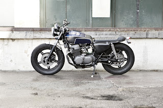

There i am. The next step is the seat and the tail light. It the biggest part of the project.
clubman, rearset, exhaust wrap, pod filter, turn signal, paint and bar-end mirror.
And the seat i want:

Gotta give you credit for how it looks now. I have a couple kz750 ltd's in my shop now. One for parts and one to restore.
I love the look of yours. I'm just getting one running for my daily driver and was wondering where you got the handlebars, and the exhaust?
Also, did you relocate the foot pegs and shift linkage?

Re: kz750 81
08 Sep 2009 15:31
Thank Circle_u!
Yep, i make rearset with help from guitargeek's post
kzrider.com/index.php?option=com_kunena&...71984&catid=5#171984
It's very easy and confortable!
I buy clubman from used part in montreal
and i don't know where come from the exhaust.
It came with the bike when i got it.

some update
To do list:
paint my rims / change tire
drop my front suspension
relocate ignition switch
change brake light
put my license plate on the side
and find a good idea for a beautiful 2 place seat!
Click on the pic, i have trouble with the photo preview...
To do list:
change brake light

Hey guys !
I'm new on this forum. I brought a KZ750 4 1982 this year and I'm changing a couple of parts to get a better bike. This project from Philk7 is really helpful for me! Now I'm looking to change my seat. I started some idea to make a costum one but I'm not sure it's a good idea if I dont cut the frame or change the rear fender...
So, I would like a seat like Philk7 have on the last two pictures. Can you guys help me to fing what it is ?
Thanks in advance.
Louis

It's probably a seat from a 70s standard model. Z1, KZ900-A, KZ650-B/C/F, 750-B Twin.
Chances are that the hinges on a different seat will not line up. I'd guess that an 80-82 750E Standard seat will bolt on, but those are not the flat ironing board type --- the passenger section is slightly raised. You could get yours reshaped & recovered.
