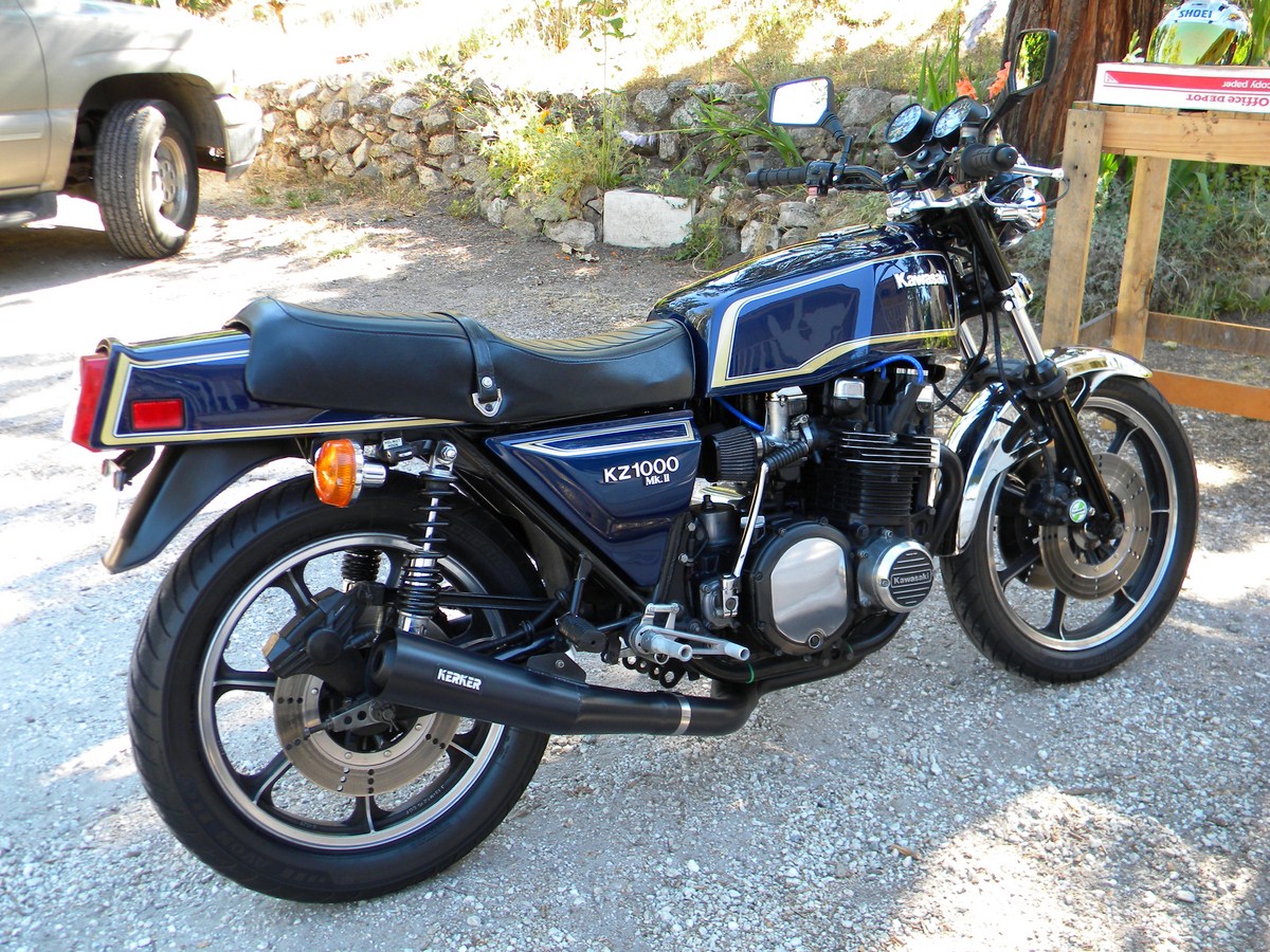

they sell some clean 1'-2'or 3' x 1" pieces of flat aluminum at smaller hardware stores...i used about 2 ' by the time i got the right 6" piece bent just right...it has compound angles to go from the passenger peg to the pipe mount hole....i got some cool aluminum allen screws and self locking nuts ,washers and the final product looked nice...the compound angles/bends were pretty hard to hand bend but some vise grips , rags ,hammer and bench vise ,drills,files,sander/grinder,and they came out clean....i drilled my mount holes on the last few tries first before bending and filing and rounding the ends,before they were breaking at the ends when i would drill last
