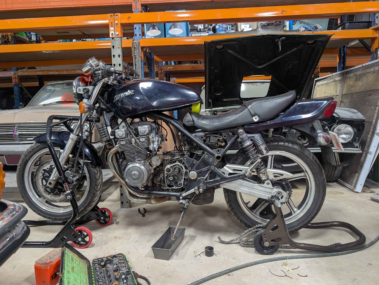

hi i recently got a zr 550 zephyr 1993
and its been dropped breaking the crank case and i was wondering if the 1982 ltd kz550 crankcase would work with the part out of the zr as i cant find anyone wrecking one thanks

Not had a 550 but all these ZR motors (except the 1100) are based on their earlier Z/GPZ ancestors so it is highly likely the 550 ltd cases will do the job.

Can you post a pic of the damage? You would be amazed at what is repairable!

at partzilla. 82 kz550D. 84 zx550A. 91 zr550. looks like most if not all of the gaskets are the same. cylinder base gasket. oil pan. transmission cover. clutch cover. LH & RH engine covers.

i blelive this should work but i can move it as if it was jello as someone in the pass has tried fixing it im in no rush on it
