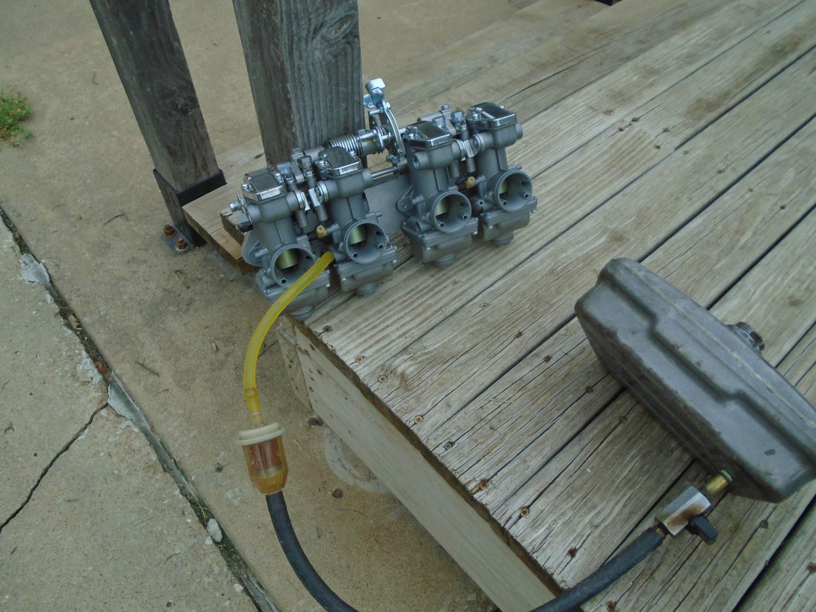

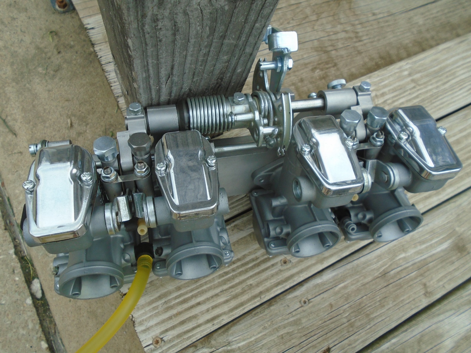

Chevy to Kawasaki, don't lose your mind ha. As Joe mentioned, earlier Mikuni 217 single spring late 74 and 75 VM28's work just fine too. You've a 75 engine already. Here's a set i'm just finishing-up, wet testing them before i ship them out. These are the earlier 2 spring 417 version but still 28's. Only caveat with this style is they don't hold a sync for too awful long, lots of moving bits in these for slide lifters. Otherwise function great as stated.
I've tupperware containers of these, just ask Ness (ED) ha.
The following user(s) said Thank You: MFP-Joe, sf4t7

Yes, Clay, synchronizing those 28mm carburetors was always a headache. Just when you’d managed to get it as good as possible... you’d twist the throttle twenty times, and all that work would be undone. As Clay noted: far too many linkages, pivot levers, ball joints, spring clips, and so on... but I loved those carburetors anyway. I wish I could buy a setup like that cheaply these days—I’d install it again in a heartbeat!
