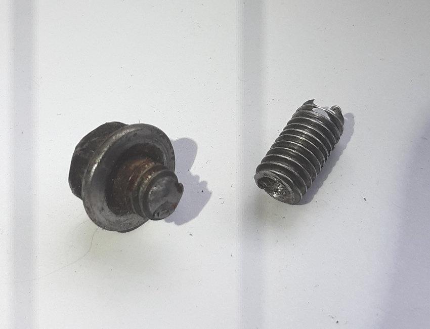

I've had the forks apart to change the stanchion oil seals, and then it of course helps to get the mudguard off. A friend assisted me with this, and noticed serious effort was needed to undo the bolts attaching the mudguard to the fork sliders. One of them just snapped . . .
Normally I would apply heat to alloy female threads when I notice a bolt is stuck, to avoid snapping them. Fortunately I have previous experience with drilling out such bolt residues

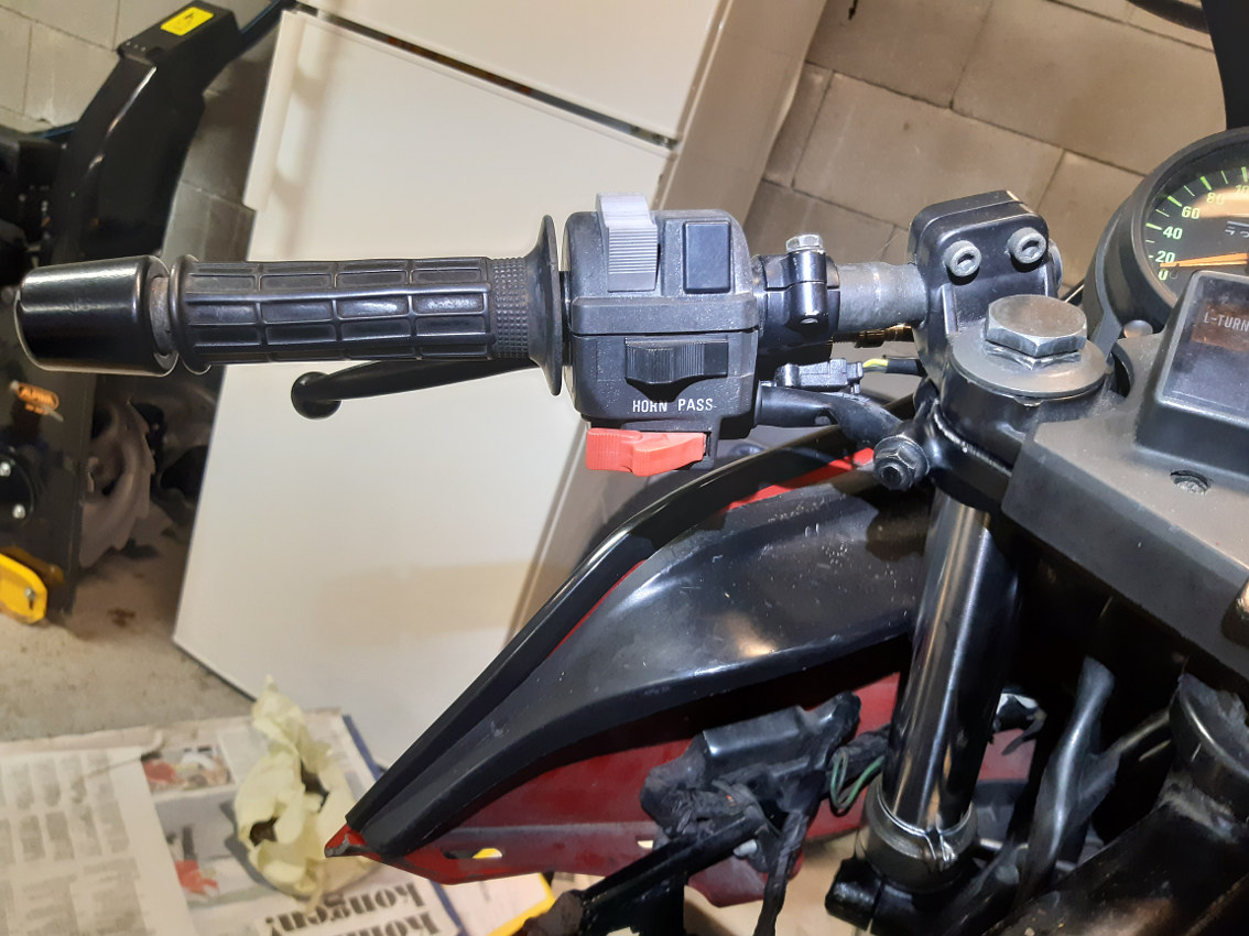

Sometimes I wonder if the previous 'mechanics' have used parts from other but similar bike models. The handlebars are angled where they fit the 'bar clamps, and the only orientation that allowed the handlebar control switch units to be fitted in a 'normal' position caused the handlebars to sit really low. So low that the brake lever hit the frame when at full steering lock to the left. This must have made the previous owner pissed off with the bike, particularly since the leaking fork oil seals didn't allow the air assisted forks to hold their air.
Now whilst going through other issues, I've ground off the locating tabs inside the handlebar switch units, so I can rotate the 'bars to a more upright position. But I wonder if this GPz originally came with straight instead of angled 'bars?

Hmmm. Some M8 bolts holding a plastic fender on. 105.7 lb/ft should be about right. Sheesh.
I am about 93% sure the handlebars are supposed to be perfectly straight. I wonder if there was an accident in that bike's past?

24 Jul 2026 02:37I doubt the 'bars have been bent in an accident, since both have the same angle near the clamps. If no other models came with "shaped" 'bars like that, someone may have modified them.Hmmm. Some M8 bolts holding a plastic fender on. 105.7 lb/ft should be about right. Sheesh.
