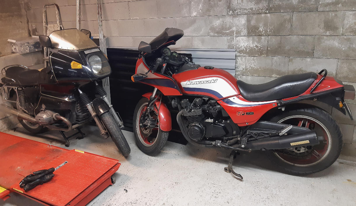

Nearly 50 years ago I took a demo Z650 out for a spin, but I haven't put a Kawasaki in my garage until recently. And since I like oldish analogous things, I ended up adopting an old GPz750 not long ago. It was obvious that the bike would need some attention, but since I like spannering, I thought it would be a nice addition to my other bikes, that, by the way, all have drive shafts instead of chains.
I know very little about the history of the GPz. It came with an old tax sticker indicating that in may have been imported from Poland. It already had some battle scars indicating low speed contact with tarmac, but also clues that a mechanic unfamiliar with the concept 'torque' (as in torque wrench) had been working on it. But it ran . . .
I've been looking at a couple internet forums for Kawasaki's, but most of them seemed to have died away when it comes to activity. That was until I noticed kzrider. So here I am

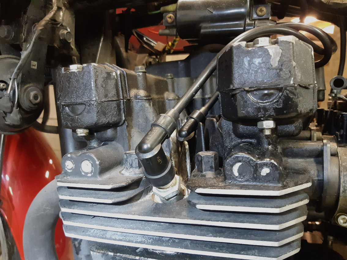

I must admit that I have never seen through-bolts and nuts on a cam cover. I hope that is the worst of P.O.'s bungling.

It's not uncommon for those threads to strip.
The alloy gets old and brittle and the threads can fracture and strip even before the stated torque is reached.
It's nothing a few helicoils shouldn't fix.

18 Jul 2026 10:56 - 18 Jul 2026 10:58Me tooI must admit that I have never seen through-bolts and nuts on a cam cover. I hope that is the worst of P.O.'s bungling.
www.kzrider.com/forum/11-projects/620005...tomod?start=0#895539
which shows the same 'fix' . So apparently not unusual, as zed1015 pointed out.

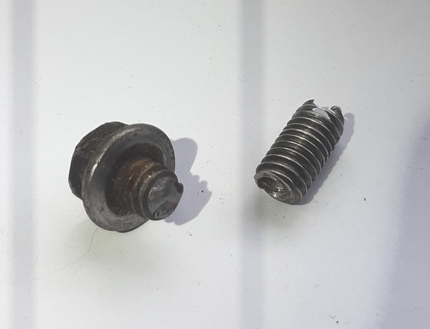

I've had the forks apart to change the stanchion oil seals, and then it of course helps to get the mudguard off. A friend assisted me with this, and noticed serious effort was needed to undo the bolts attaching the mudguard to the fork sliders. One of them just snapped . . .
Normally I would apply heat to alloy female threads when I notice a bolt is stuck, to avoid snapping them. Fortunately I have previous experience with drilling out such bolt residues

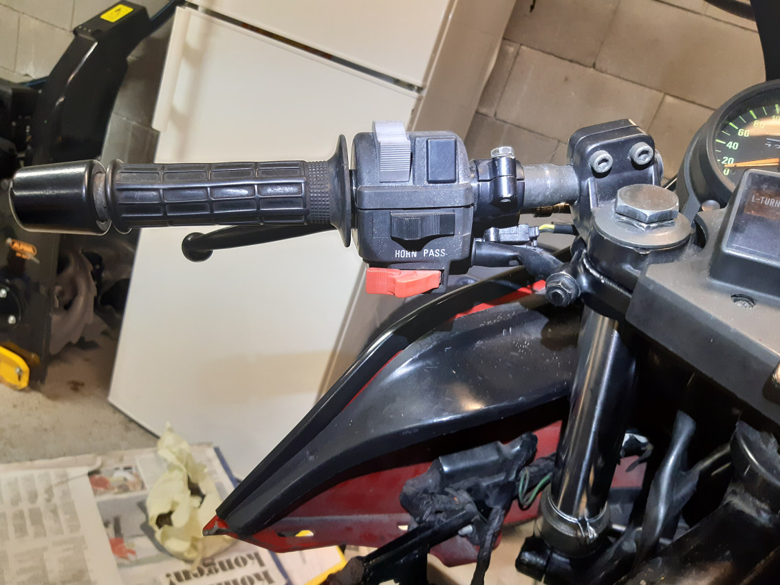

Sometimes I wonder if the previous 'mechanics' have used parts from other but similar bike models. The handlebars are angled where they fit the 'bar clamps, and the only orientation that allowed the handlebar control switch units to be fitted in a 'normal' position caused the handlebars to sit really low. So low that the brake lever hit the frame when at full steering lock to the left. This must have made the previous owner pissed off with the bike, particularly since the leaking fork oil seals didn't allow the air assisted forks to hold their air.
Now whilst going through other issues, I've ground off the locating tabs inside the handlebar switch units, so I can rotate the 'bars to a more upright position. But I wonder if this GPz originally came with straight instead of angled 'bars?

Hmmm. Some M8 bolts holding a plastic fender on. 105.7 lb/ft should be about right. Sheesh.
I am about 93% sure the handlebars are supposed to be perfectly straight. I wonder if there was an accident in that bike's past?
www.partzilla.com/catalog/kawasaki/motor...0-zx750-a3/handlebar

24 Jul 2026 02:37I doubt the 'bars have been bent in an accident, since both have the same angle near the clamps. If no other models came with "shaped" 'bars like that, someone may have modified them.Hmmm. Some M8 bolts holding a plastic fender on. 105.7 lb/ft should be about right. Sheesh.
