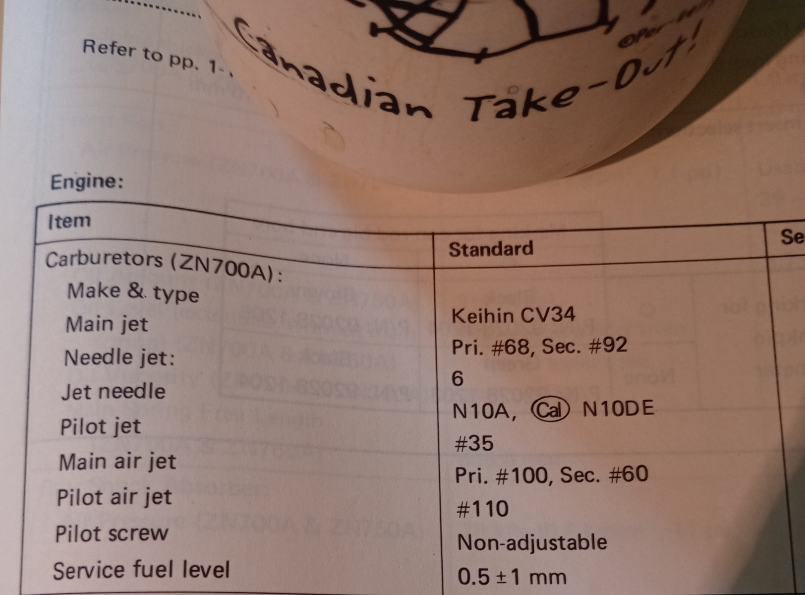

Greetings:
If your motorcycle is a shaft drive model, then it is actually a ZN700A1. If so, I have attached info from the Kawasaki Service Manual for your Keihin carbs...assuming they are original to your motorcycle. I have also attached photos of the service manual, front and back and I encourage you to acquire this manual...start your search for this manual on eBay and you will likely find it.
