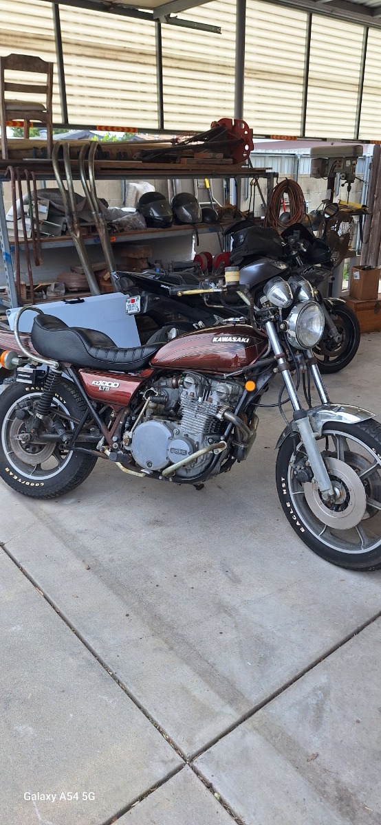

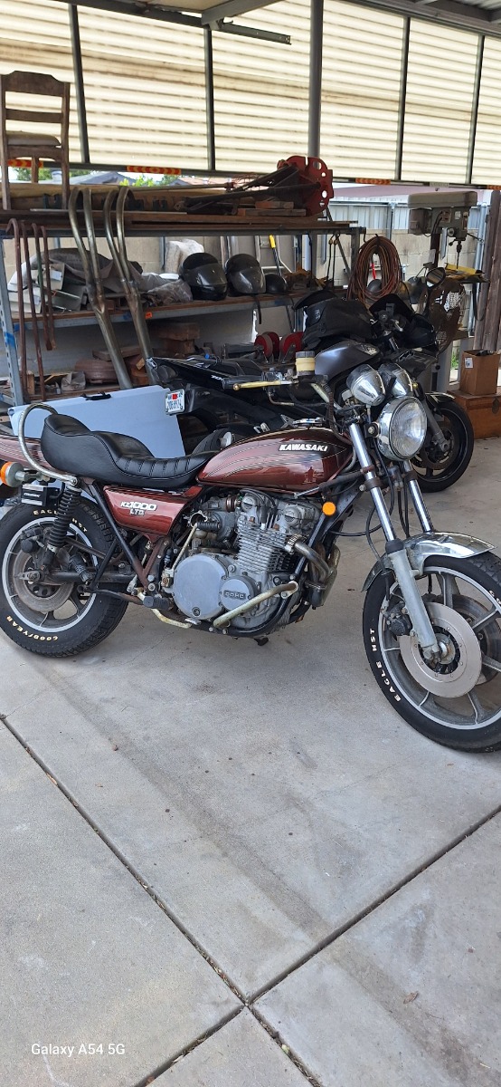

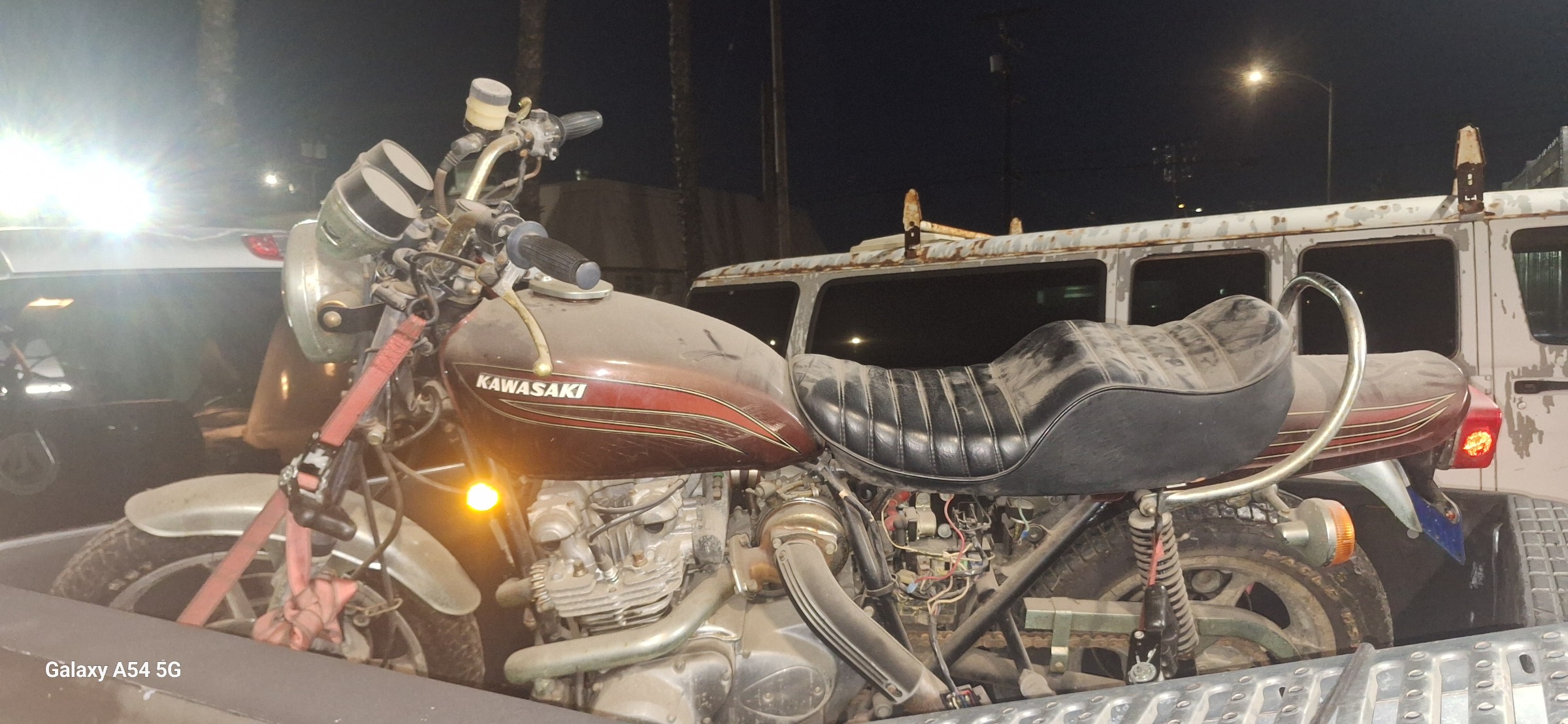

Hi, I just wanted to let everyone know that I'm new to the forum.
I've been riding since 1978 and have been through a lot of bikes since then.
I joined KZ Rider since I just bought a 1977 KZ1000LTD with an ATP turbo on it. It has only 7k miles on it, was owned by a doctor, then was parked in in a shop in 1987.
It cleaned up nicely, but still needs a lot more TLC.

Welcome to the fun! I agree it does appear to have cleaned up nicely. There is a lot of knowledge that is freely shared here. I look forward to seeing what you do with your project.

Welcome to KZRider...lucky man to find what you have.

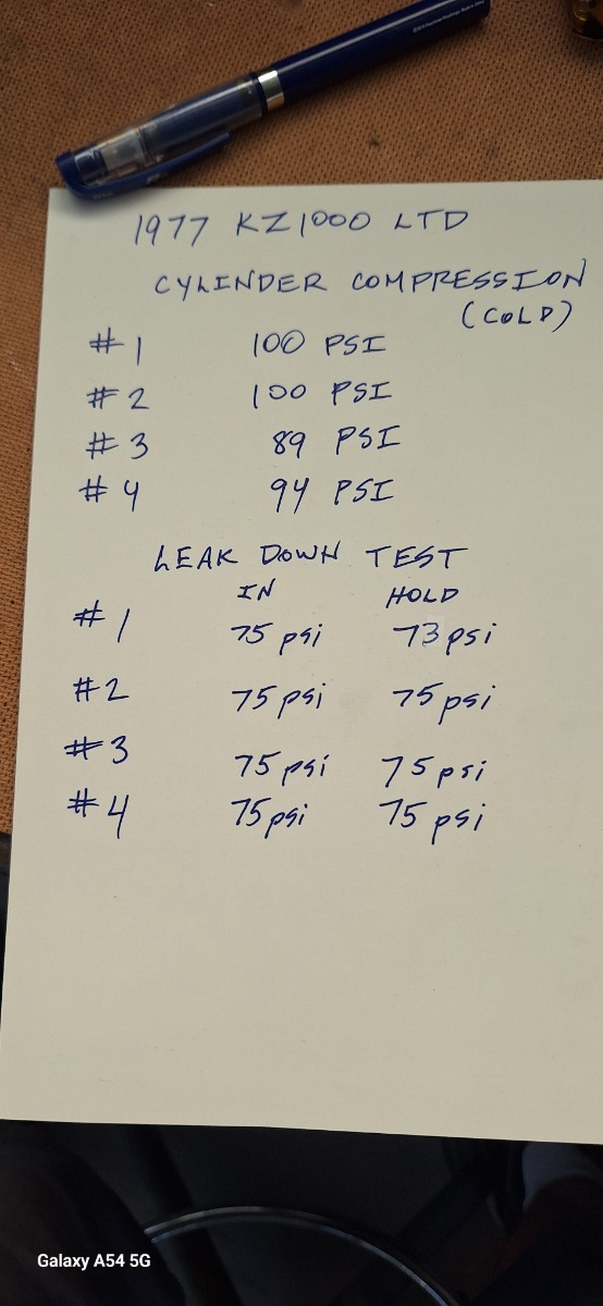

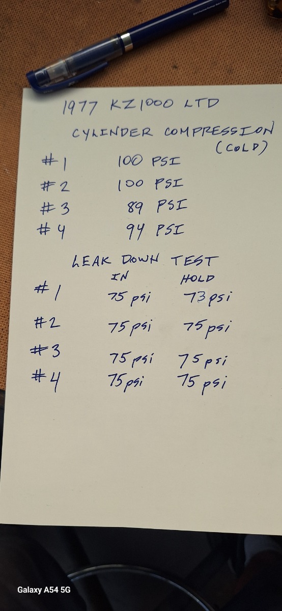

I just took the carburetor out and going to clean it up, new gaskets and stuff.
I did a cold compression test and a leak down test as well. I'm going to try and post that picture now.

I forgot to say that it hasn't run in almost forty years.

Have you had it running yet? Those numbers will change with some time on the engine.
