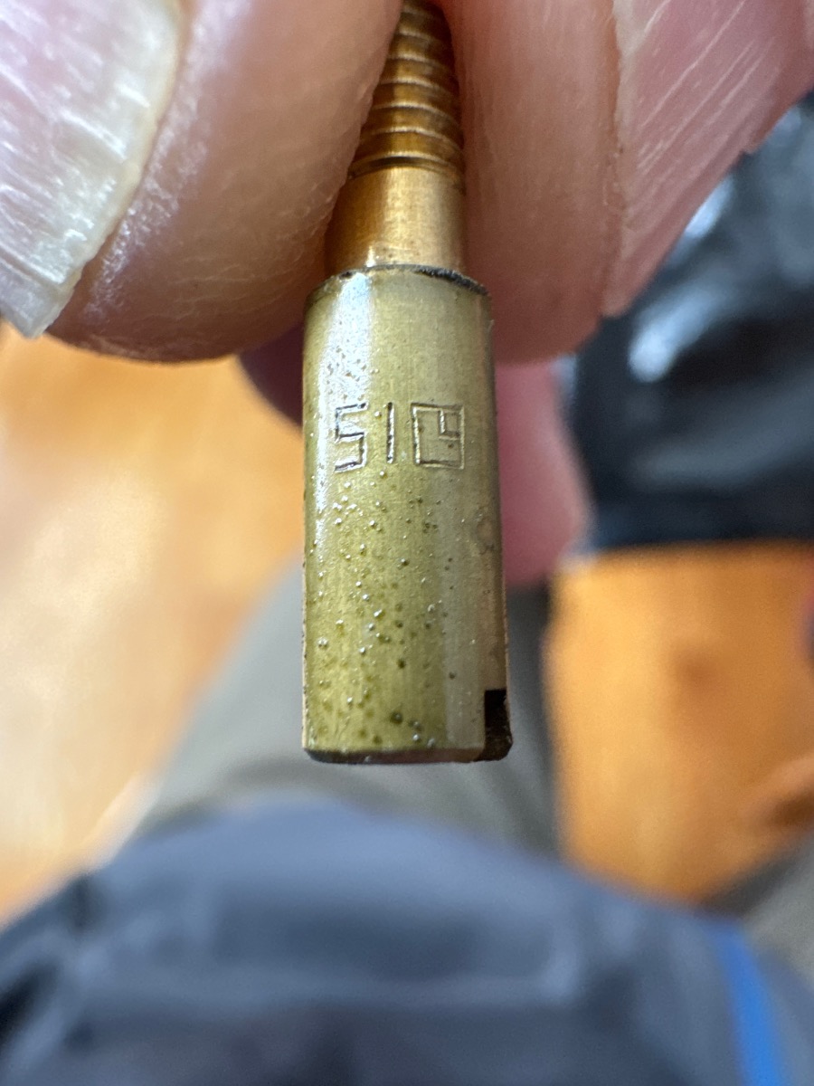

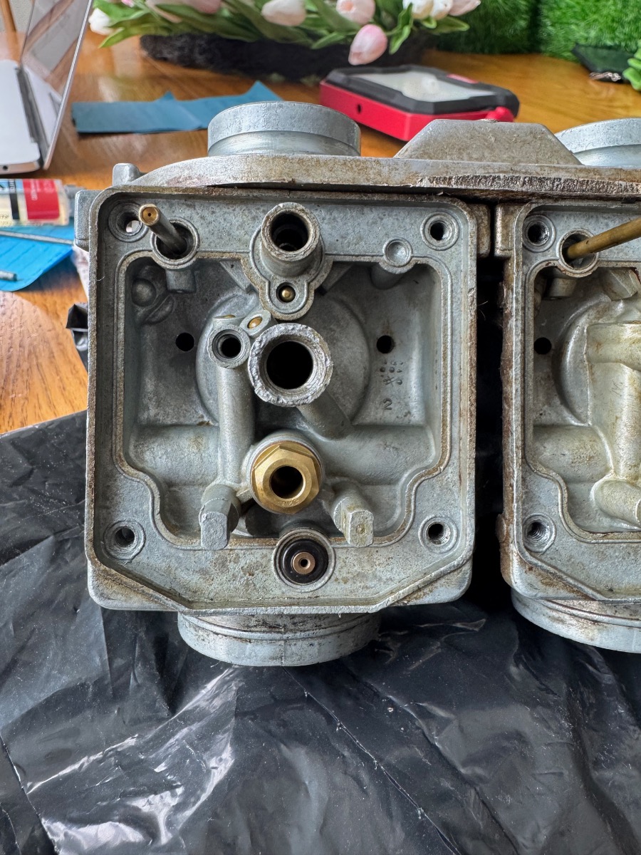

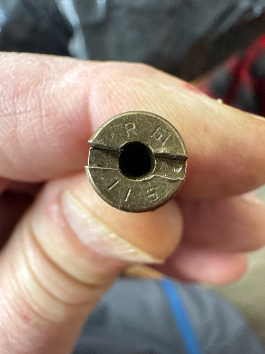

I have owned this bike since 1987 but it's been sitting for the past 15 years. Trying to resurrect. I just got the carburetor slides freed up using a heat gun. Now I am trying to figure out what my setup is. I can't seem to read the main and pilot jet sizes very well. Any help would be appreciated.
In order to fully clean the slides/bores should I remove them or just do that in place?

My old eyes see a 15 pilot jet and a 118 main jet.

What my old eyes saw as an 8 could well be a 5.

15 Pilot.
115 Main..

Thanks all. From what I'm reading this bike came with a #15 pilot and 102.5 main jet so the main jet has been upsized at some point. I really don't know when that was done. The pilot jet seems to be stock at #15. I do recall the bike running really well when it was tuned (use to take to a good local shop) so I will probably stick with these for now.
It does have a 4 into 1 Kerker header and the stock air intake is gone. The only thing I recall when last riding it over the years is some occasional popping.
Thanks again.
