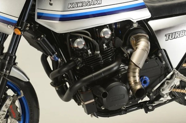

I guess what you are looking for is something like this turbo header and intermediate pipe ? I think unfortunately you would need to have it fabricated as I don't think there is an off the shelf item for a 750 ?

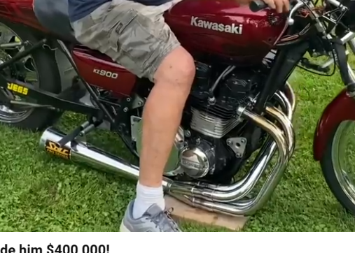

thanks for the answer but thats not quite wat i was lookin for ... I've seen them on drag bikes and they just go to the right side and go straight into a collector i need to pull a pic out and paste it. and i'm willing to get one for another bike and weld my head mounts on them.

Ah I know what you mean, I think they are called "sidewinders". Only issue I see is they are "drag" inspired and will have very restricted clearance on right hand bends

Nobody ever made a sidewinder that fits a KZ750. You can get one for a KZ1000 and modify it to fit, but it requires some work.

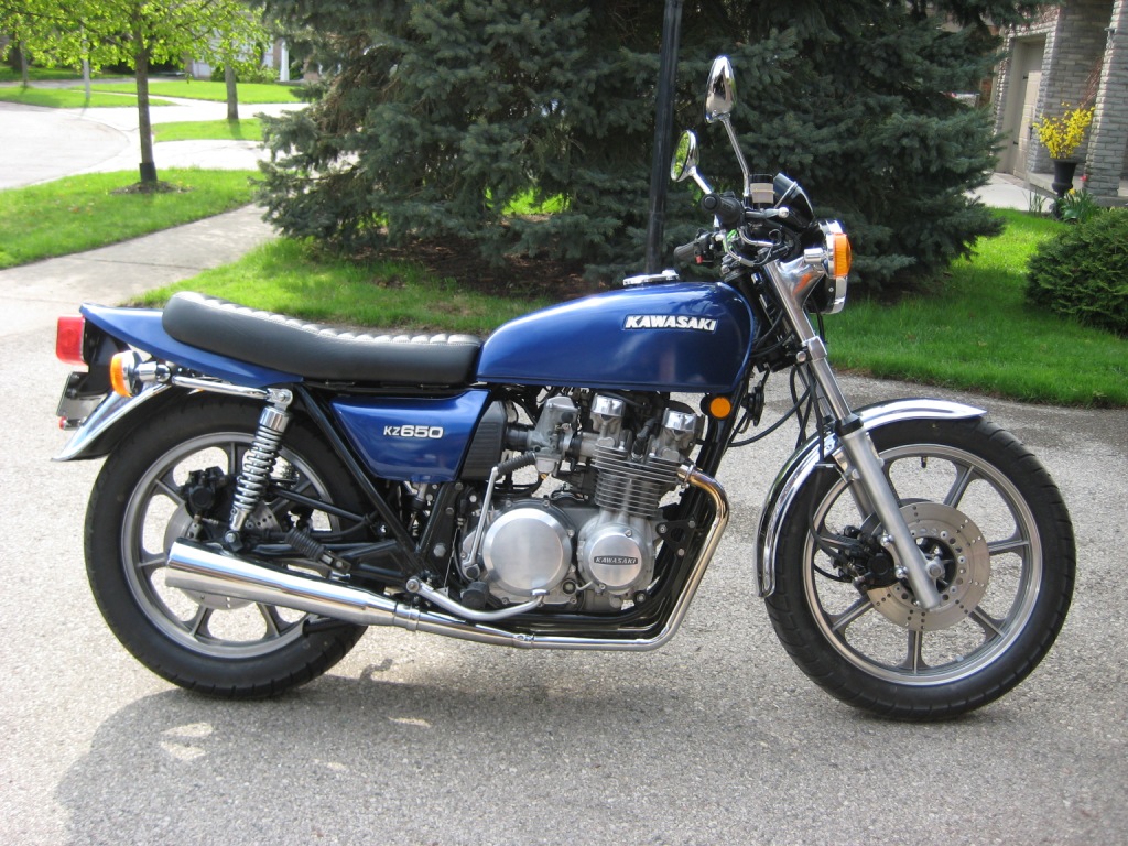

You may be better off finding a MAC 4 into 2 system, they fit up closer and they made those to fit 650/750 engines. The 4 into 1 collector on the side is taller than the 4 into 2 system. Like Wookie mentioned you can't really corner with those.
Below is my bike with a MAC 4 into 2, that bike is lowered by 1" on both ends but it could go lower. You can also cut out the seat foam and get it a lot lower, can easily get another 1-1/2" or more out of the seat.
Most of the lowering you see in that drag bike picture is coming from suspension and seat lowering, the exhaust is out there because the oil pan is only 3" off the pavement (legal race minimum height) The use 3" static because of rider weight and fork give. When your riding it's more like 2-2-1/2"
