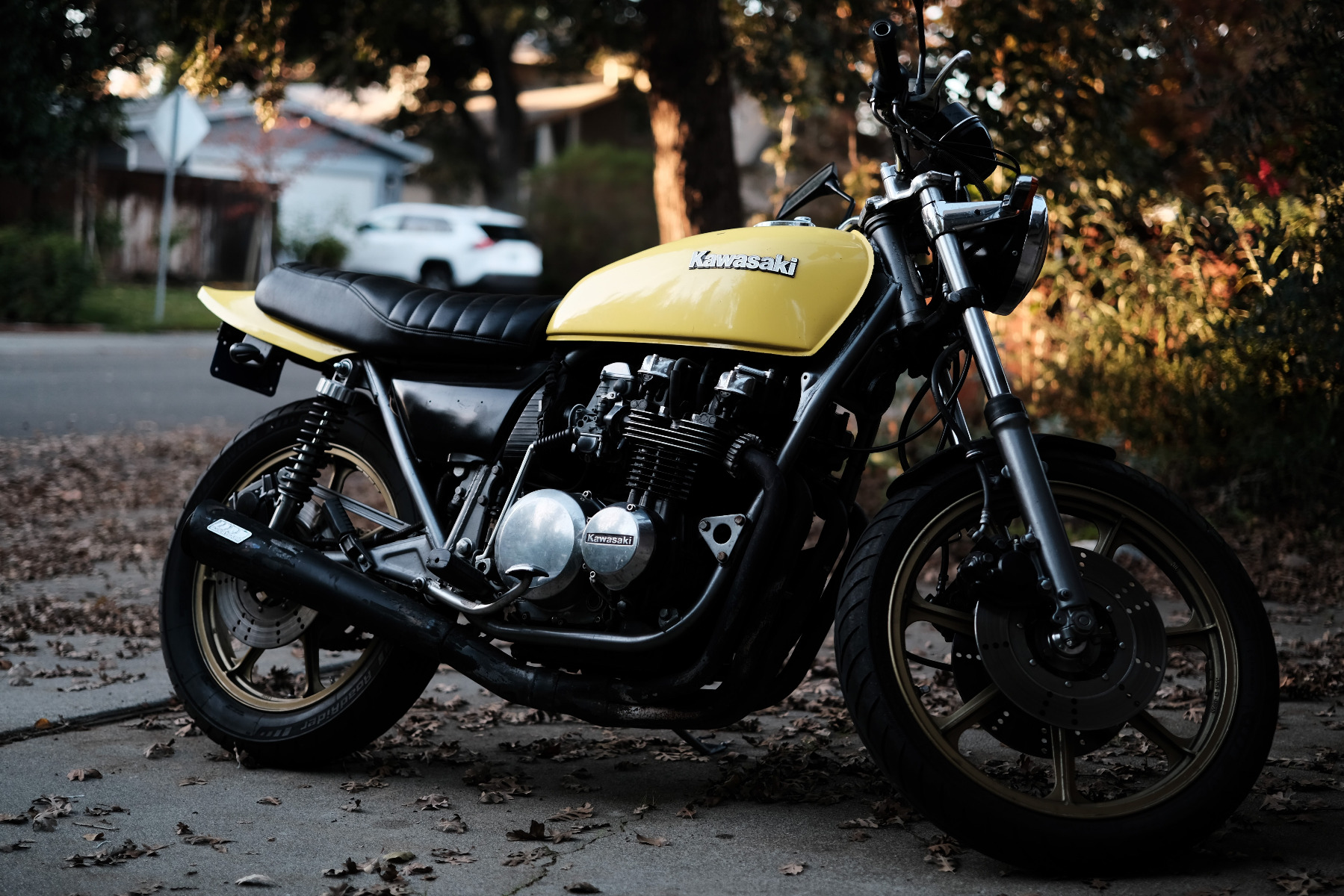

Hello all y'all,
I just got my first bike, a 1979 KZ650 this year and it's been full of good learning so far. Took that motorcycle safety course since I've only ever ridden two stroke bikes off road, found out which local bike mechanic is good and which one is really not good, and have finally landed on working on this bike myself with some help from Clymer and KZRider. Here's the bike!
And I guess my first question is hopefully about timing and advance, but we'll see. First, I'm currently having two issues: intermittent low power that shows up in various ways and gets worse after thirty minutes of gentle riding on flat land, and gas getting dumped into the exhaust cooking the paint off my exhaust pipes.

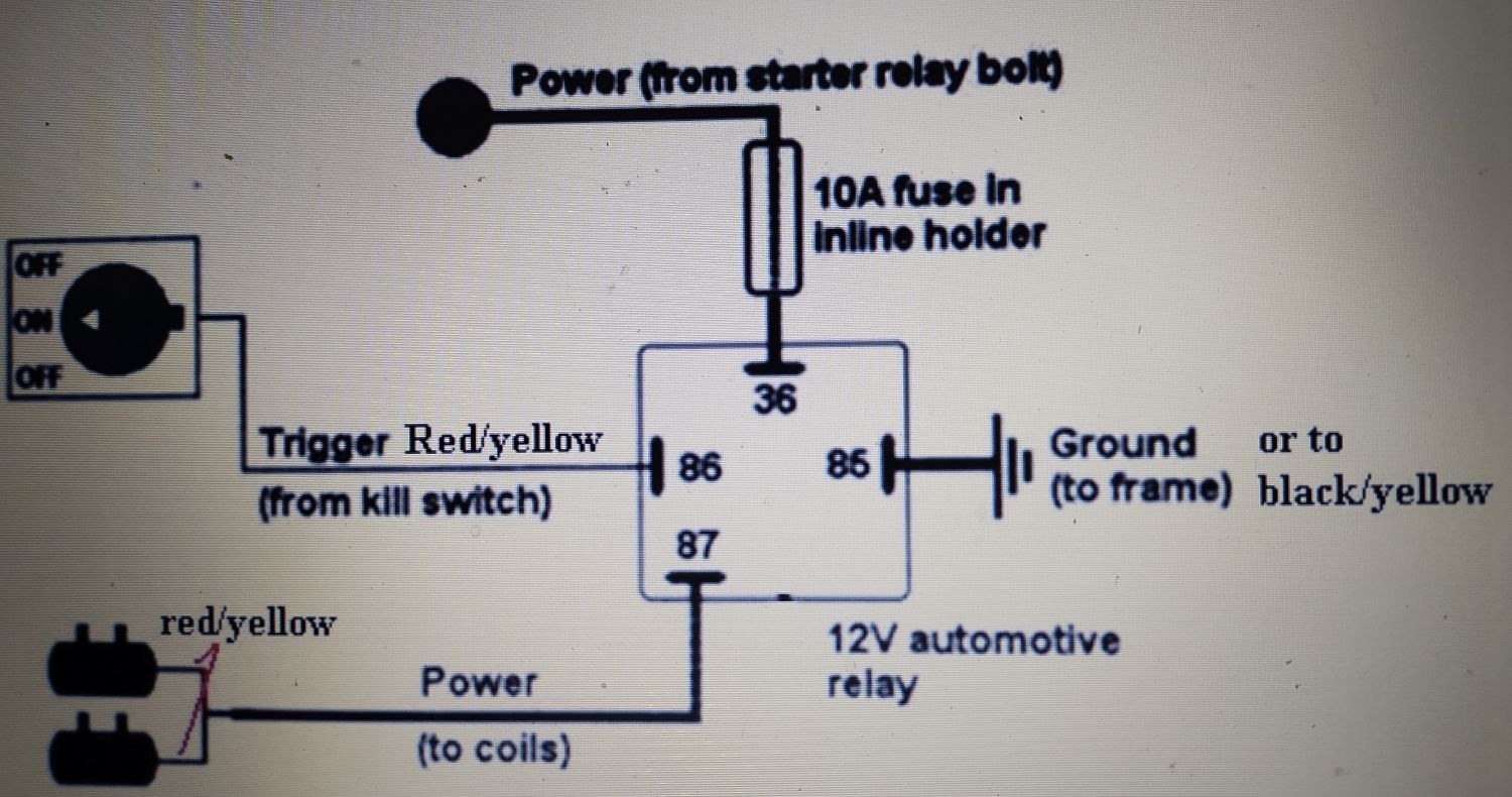

You could check what voltage is making it to the coils.
Ideally you want close to 12 volts, but some stock wiring will loose some power, giving maybe 8-10 volts at the coils.
In that case, a "coil Mod" may help there.
Where a relay is utilized to power the coils more dirrectly, giving more power.
