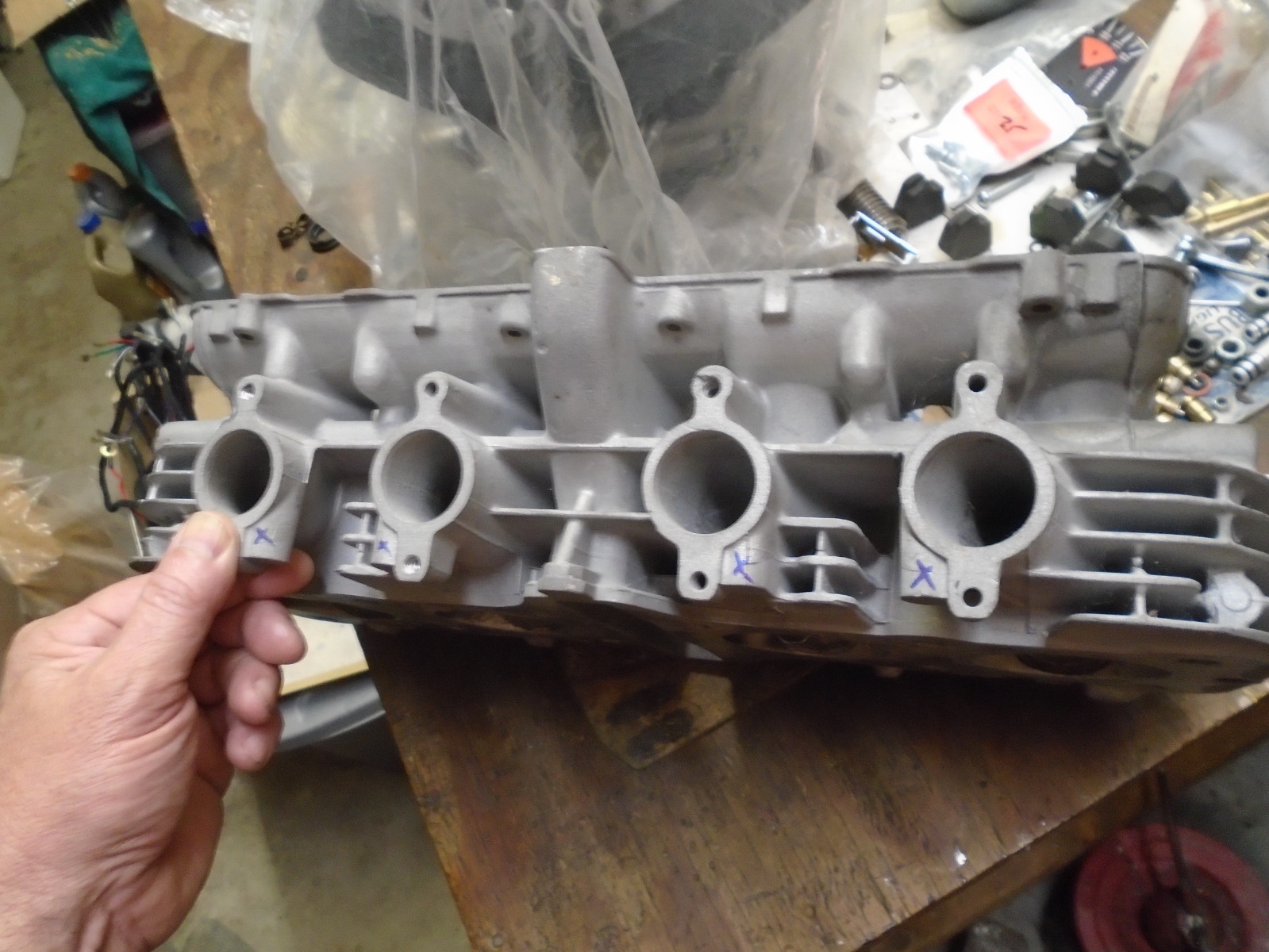

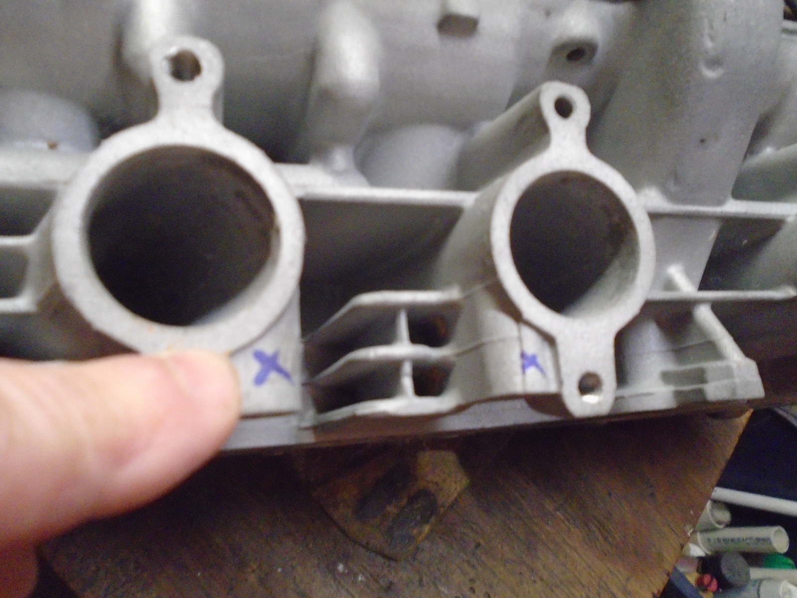

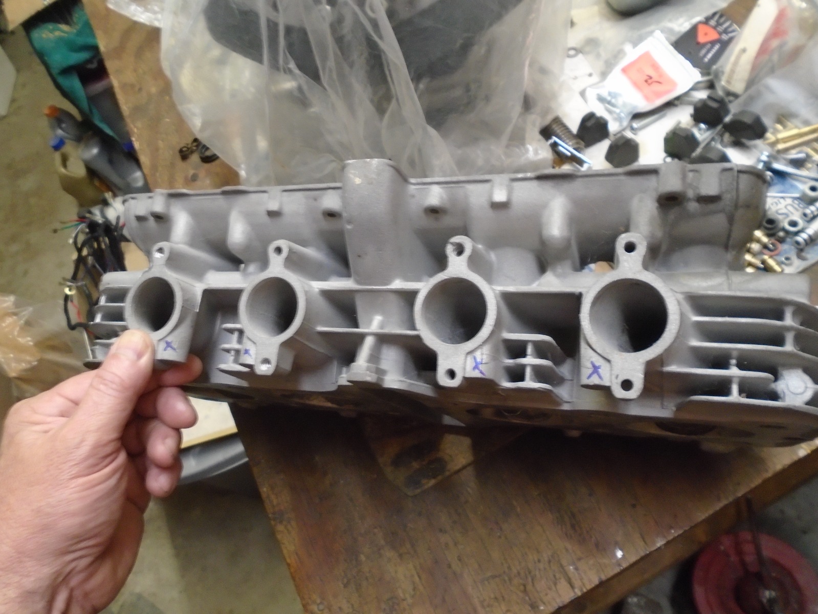

Well that "Basket/boxes" sounds all too familiar, that's usually the way i get them! Pickings from ebay are slim these days, don't know what facebook market has, have never been there? Being a 73 there are kinda unique properties of the head cylinder specific to early production. You didn't if Your 73 is the early or late version. Here is what a 1973 head should resemble, note the "X's" on the intake extra material carried over from the earlier Z when they were used for sync ports. This extra chunk of casting although not drilled and tapped is what you'll be looking for as replacement head. Of course any Z1-KZ900 will work. Did the "EX" get pissed and throw your stuff in the dumpster!! Keep up the Faith, you'll get it together!

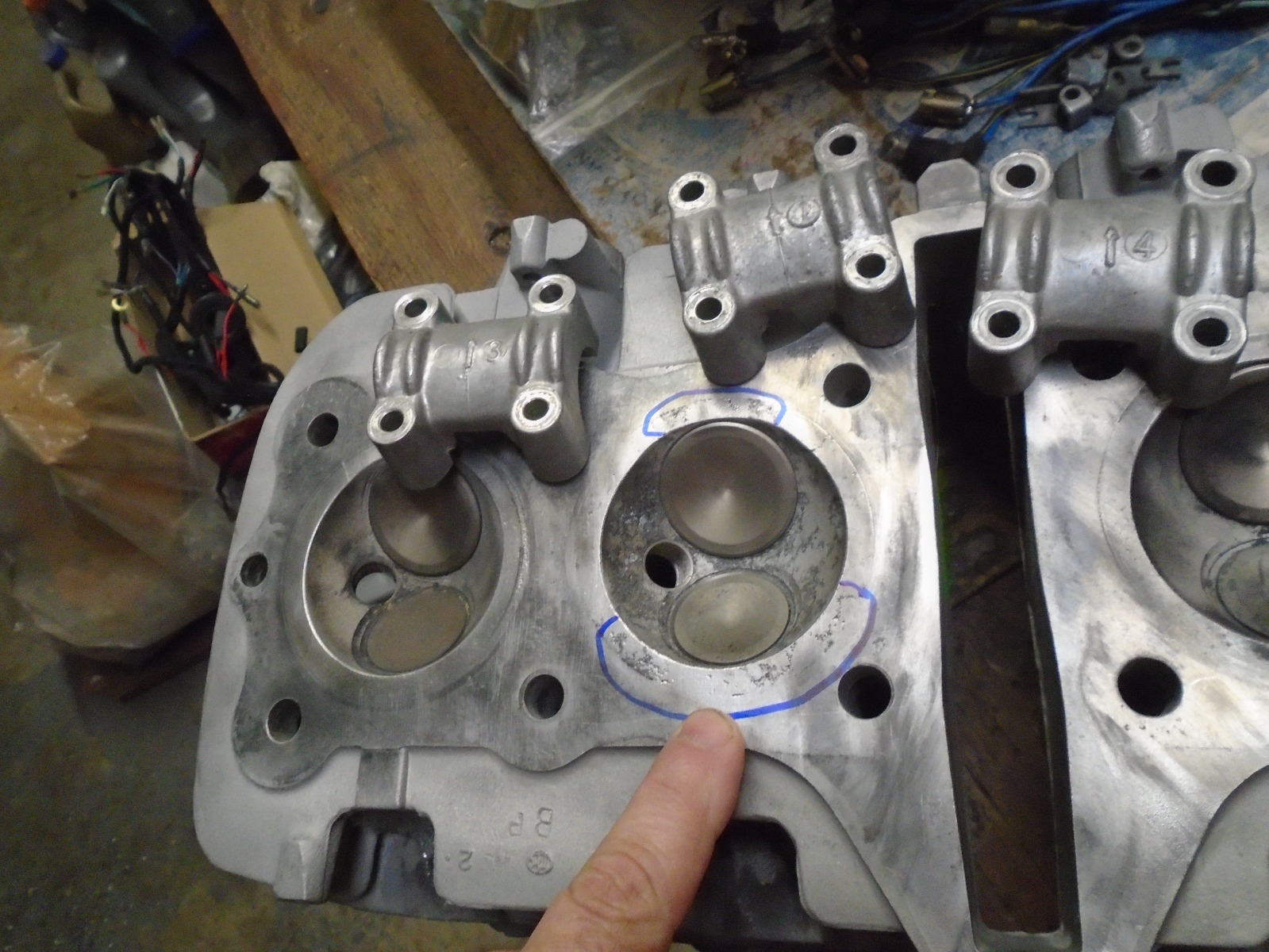

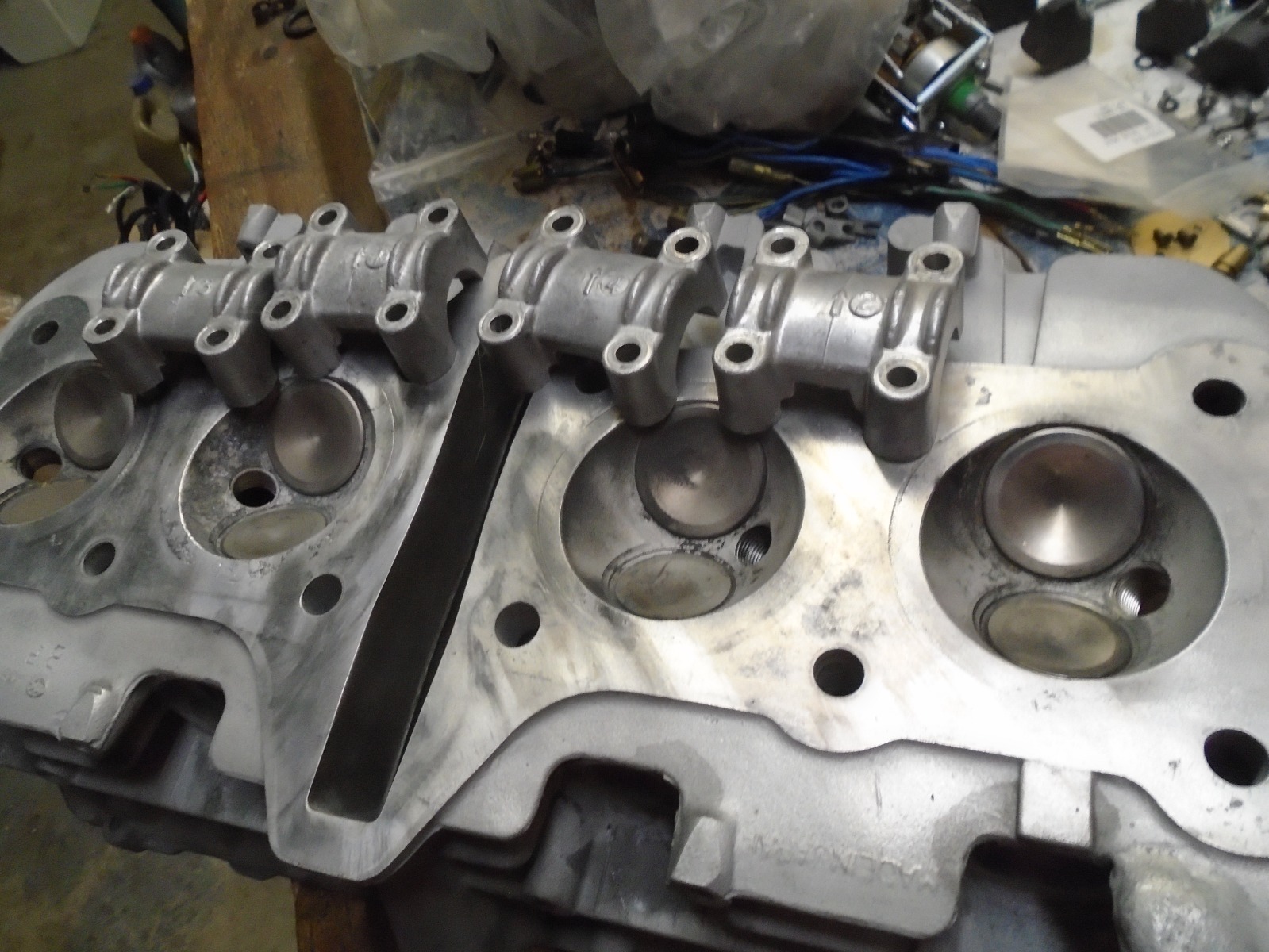

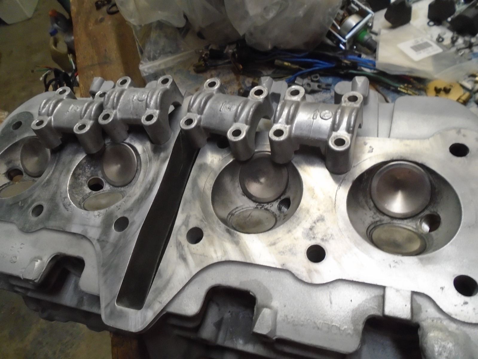

I suppose i can mention also. This a proper head for your needs, came from some old racers inventory. My Buddy from North Carolina sent it to me as seen, have done nothing to it since it arrived. Does have Stainless Steel valves id just noticed and no cracking between sparkplug holes and valve seats. Comes with cam caps but don't know if original to the head? Easy to check though once cleaned-up. A bit of pitting around the one cylinder shown, surfacing of approx .003" should clean it up. I do these all the time, peak Your interest? I don't know Your personal capabilities or resources?

13 Jun 2026 20:04Hello Clay, thanks very much for the reply and apologies for the late response. I would be interested in this head as long as you think it will make a rider and as long as the caps are original to the head. I will be building a rider and not a 100% period correct Z1 so I don't need a strict early head. My frame number is 17814 and the bike has the factory dual front disk brake setup. If you think this will make a decent head, let me know what you want for it. I would send it to Chris Schumann for inspection and rebuild. There are several bare heads on ebay but none with cam caps. I have discussed the cam caps issue with Chris and he says if the cam caps are not original to the head, it is very difficult to line bore a different set of caps to the head such that enough meat will be left for the journal bearing to work properly, or if enough meat will be left to overbore for bronze bushings or needle bearings. So if the caps are not original I don't think I can make this work. Thank you sir, very much appreciated.I suppose i can mention also. This a proper head for your needs, came from some old racers inventory. My Buddy from North Carolina sent it to me as seen, have done nothing to it since it arrived. Does have Stainless Steel valves id just noticed and no cracking between sparkplug holes and valve seats. Comes with cam caps but don't know if original to the head? Easy to check though once cleaned-up. A bit of pitting around the one cylinder shown, surfacing of approx .003" should clean it up. I do these all the time, peak Your interest? I don't know Your personal capabilities or resources? Clay
