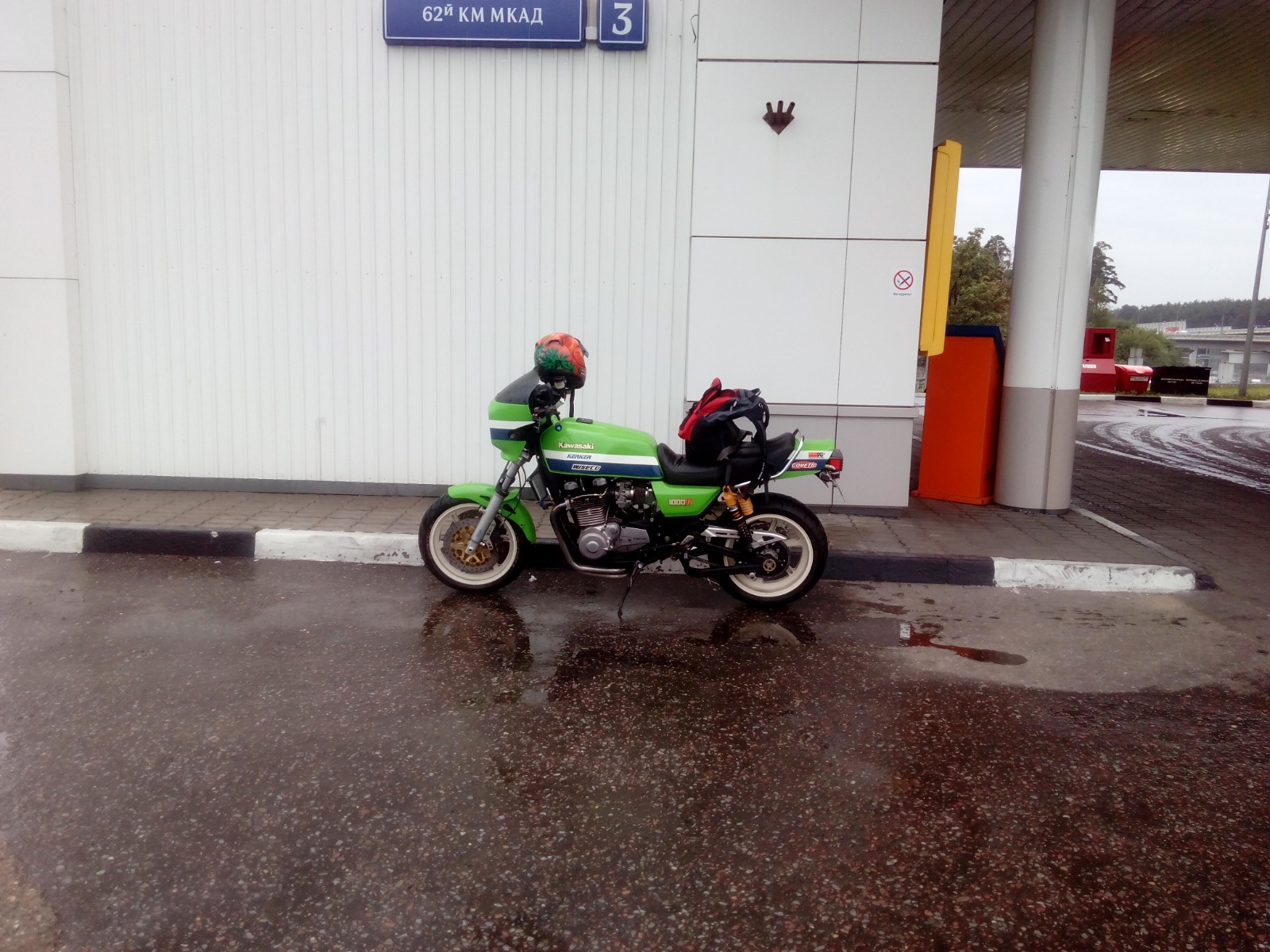

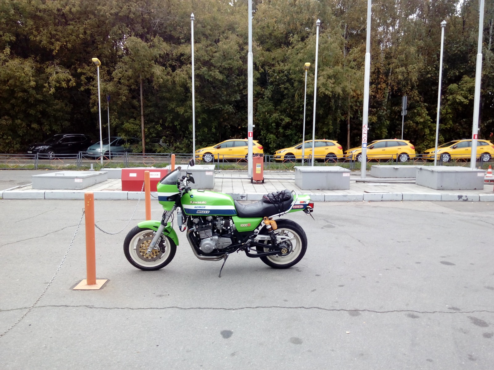

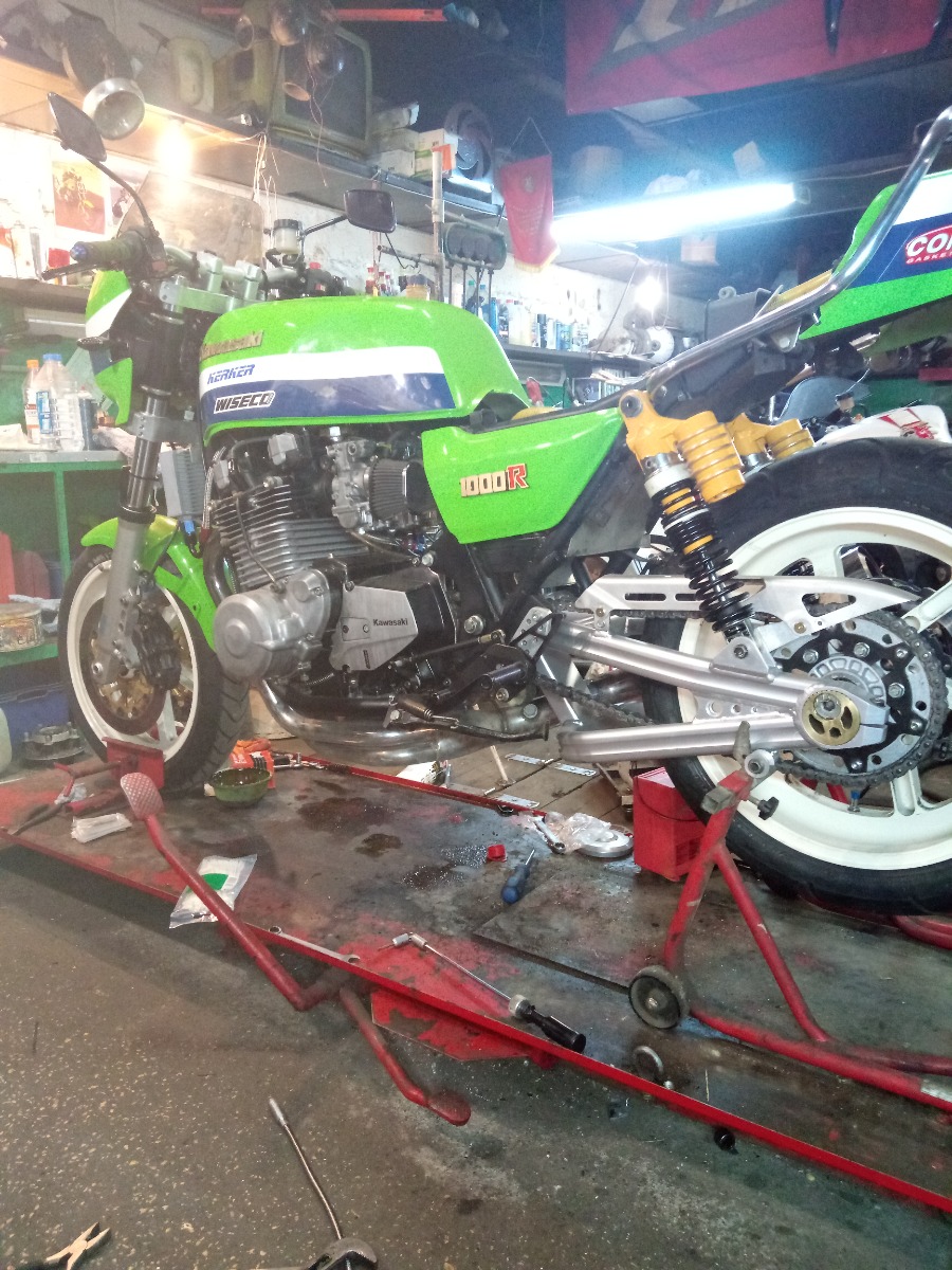

Hi everyone! This is my first time writing; I was able to find all this information on the website.My motorcycle is a Z1000R ELR. I've had it for over 20 years. It now has a big block, large valves, ports, etc.

Welcome in!
It looks like it has a Zrx1200 swingarm but not Zrx wheels. Edit: I zoomed in closer. Hi-point wheels?
Any more pics? (These members are pic addicts!)

Hi Doug.Yes, the zrx1200 pendulum is modified, I don't remember the shock absorbers. In my showa 330 mm, front fork yamaha fjr1300 first generation with race tech cartridges, traverses high under 3 bolts, wheels yes, hi point. They were made to order for some Japanese tuning company. Brakes, cast iron discs ~ 310mm, support 6 pistons, MV Agusta F4. Engine volume 1385. Large valves 40х34.Now I want to install a 3x camshaft, but there are problems)I apologize, I am writing through a translator.
