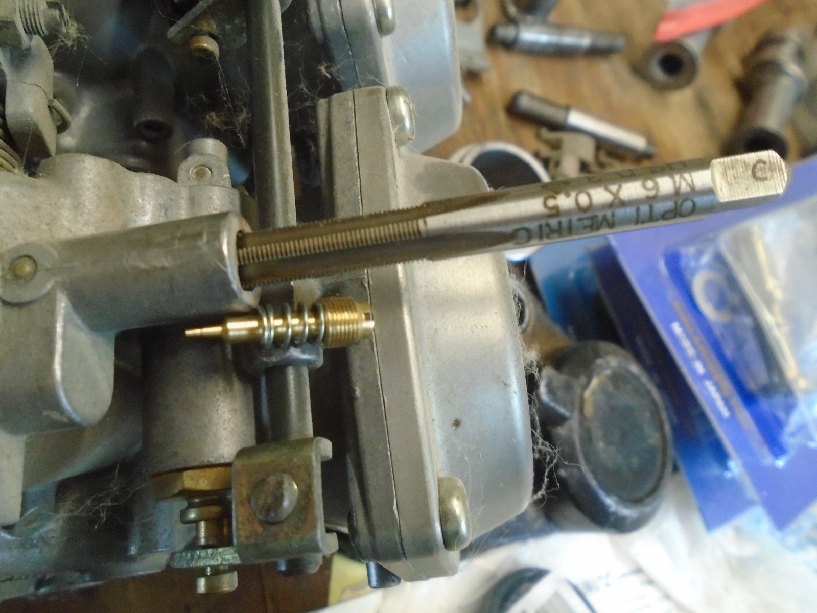

You can but be careful and don't just jam the tap thru the left-over brass!! Take a half a turn, back-out, blow it out, repeat. Tap size is M6 X 0.5. Have FuN. I do them all the time, ain't that hard but be conscientious about what you are doing!!

Here's a sample photo to guide you. Noteworthy though, you must to of just "kissed" the existing casting threads for this to work. Too much left over brass and you'll be fighting it.
