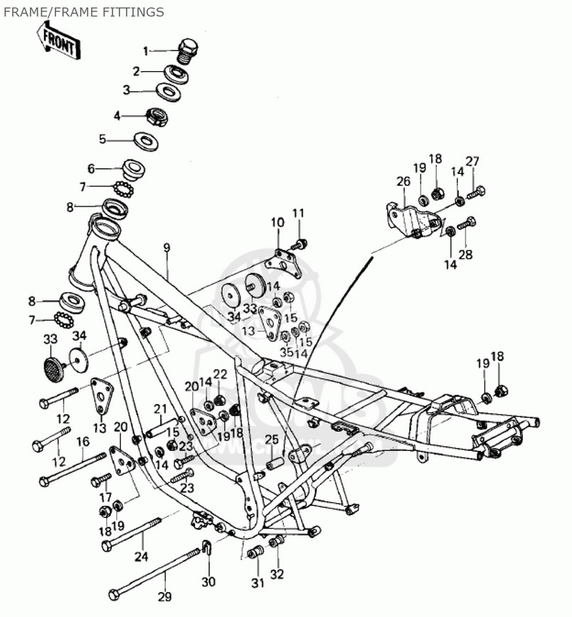

HI all,
I have recently purchased a 79 kz400 that the PO had started to build into a cafe racer. I am restoring it to factory condition, but the rear end of the frame was modified.
The parts manual doesn't show where the seat brackets attach. If anyone can send me a photo of the frame showing where the seat brackets, latch, and rear frame arch are
so that I can fab and weld them, I would be grateful.

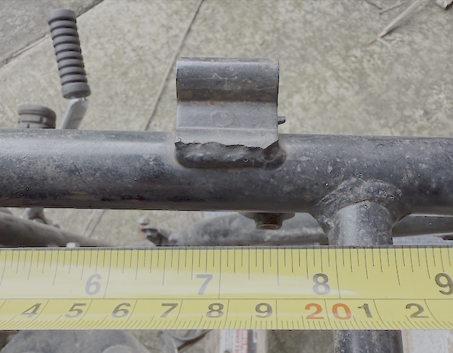

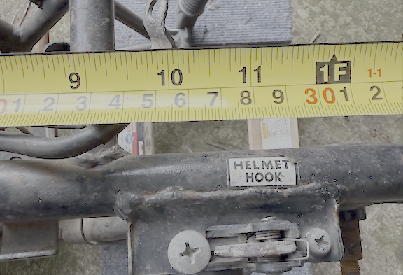

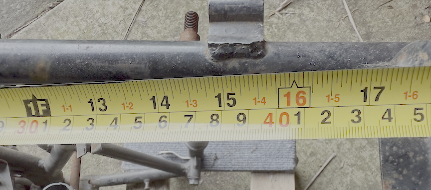

These are measured with the end of the tape against the back of the rear fuel tank support, where the frame narrows. Hope they help!
Edit: sorry they're so dark - not sure why that happened
Rear seat hinge
Front seat hinge
Helmet hook
