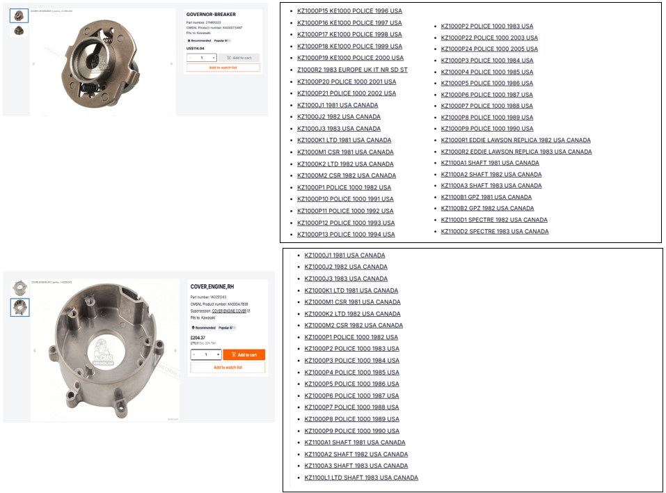

As I see it you have a couple of options depending on budget (swopping the igniter from a different model may cause "flat spots and poor throttle response as the advance/retard map is built into the igniter)
You could have the original unit repaired (in the UK this is around $200)
You could do the reverse of what I am dong with my build - fit a engine cover and mechanical advancer from an earlier model then use a "copy" Dyna-S (many guys on here are running them without issues and they are approx $60 on ebay) I have shown the advancer and cover below which are pretty generic so should be obtainable for sensible money.
Just out of interest - before you spend your money how have you diagnosed the igniter as being faulty ?
