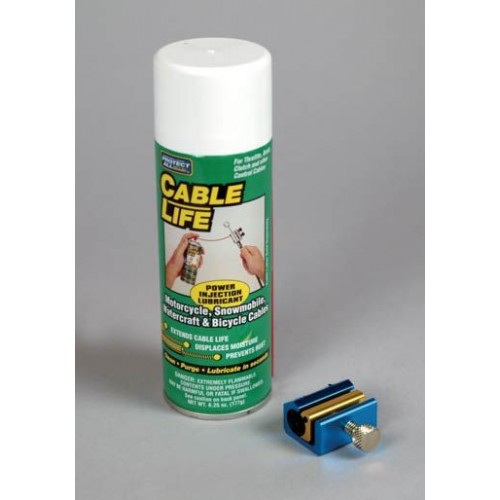

Re: First Post throttle cable
30 Jun 2025 19:53
