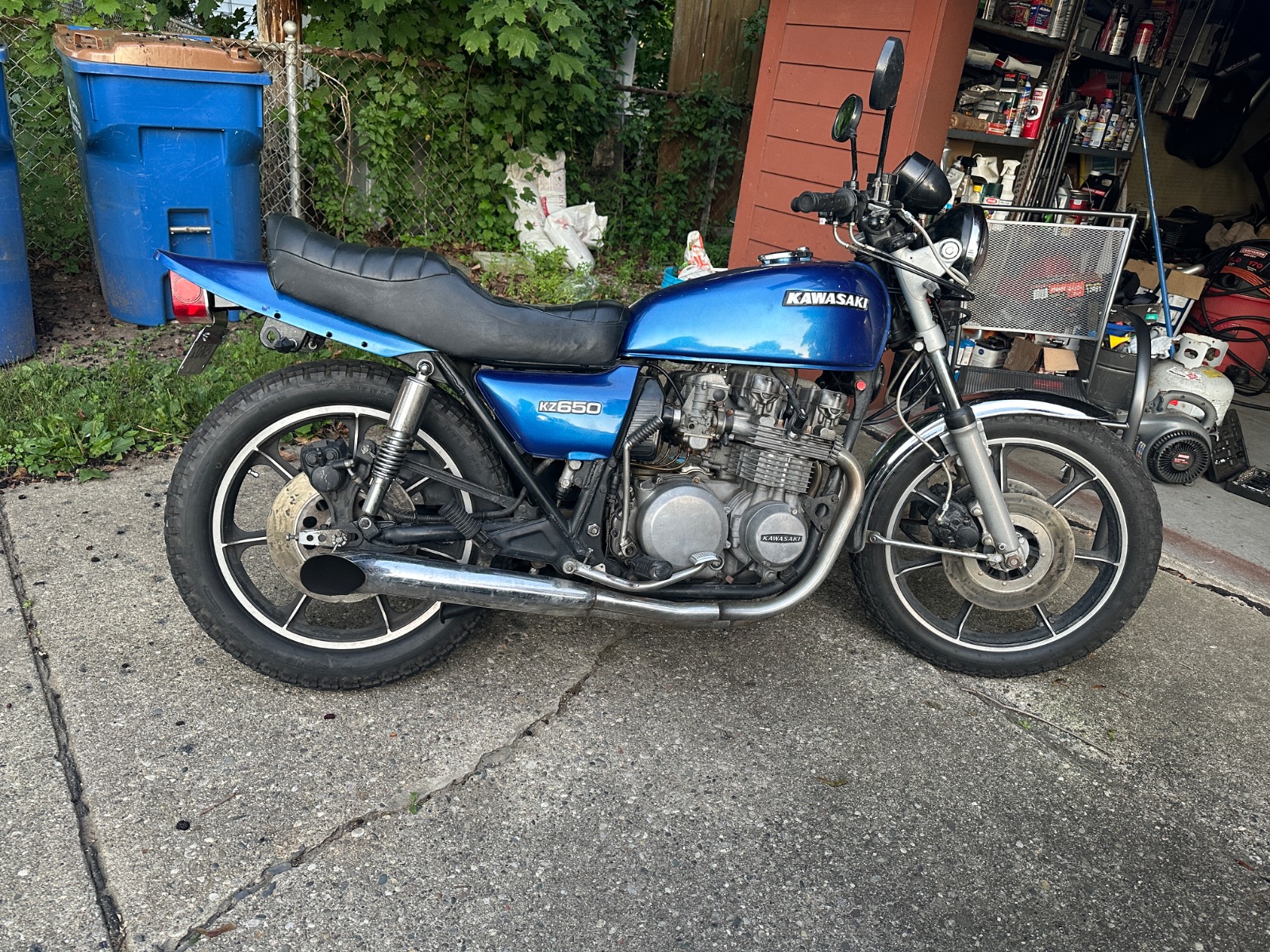

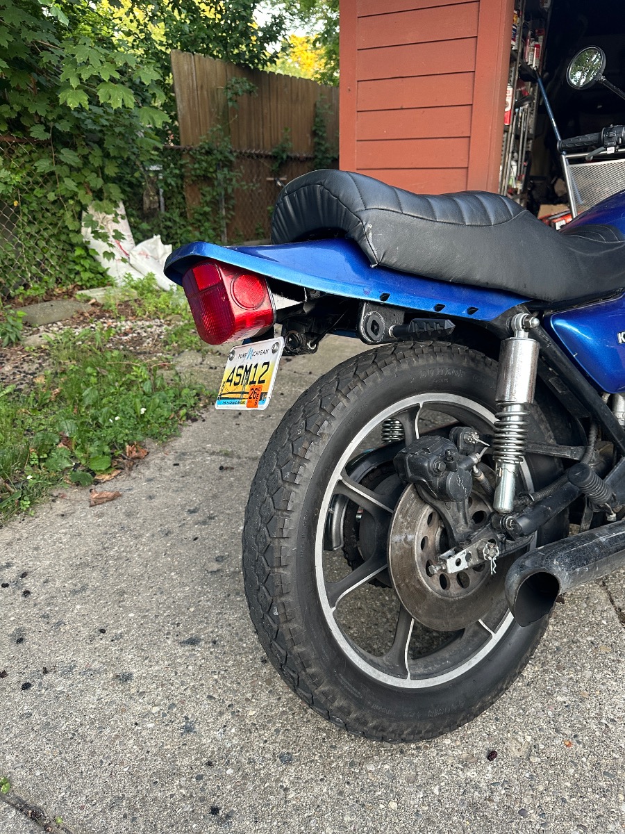

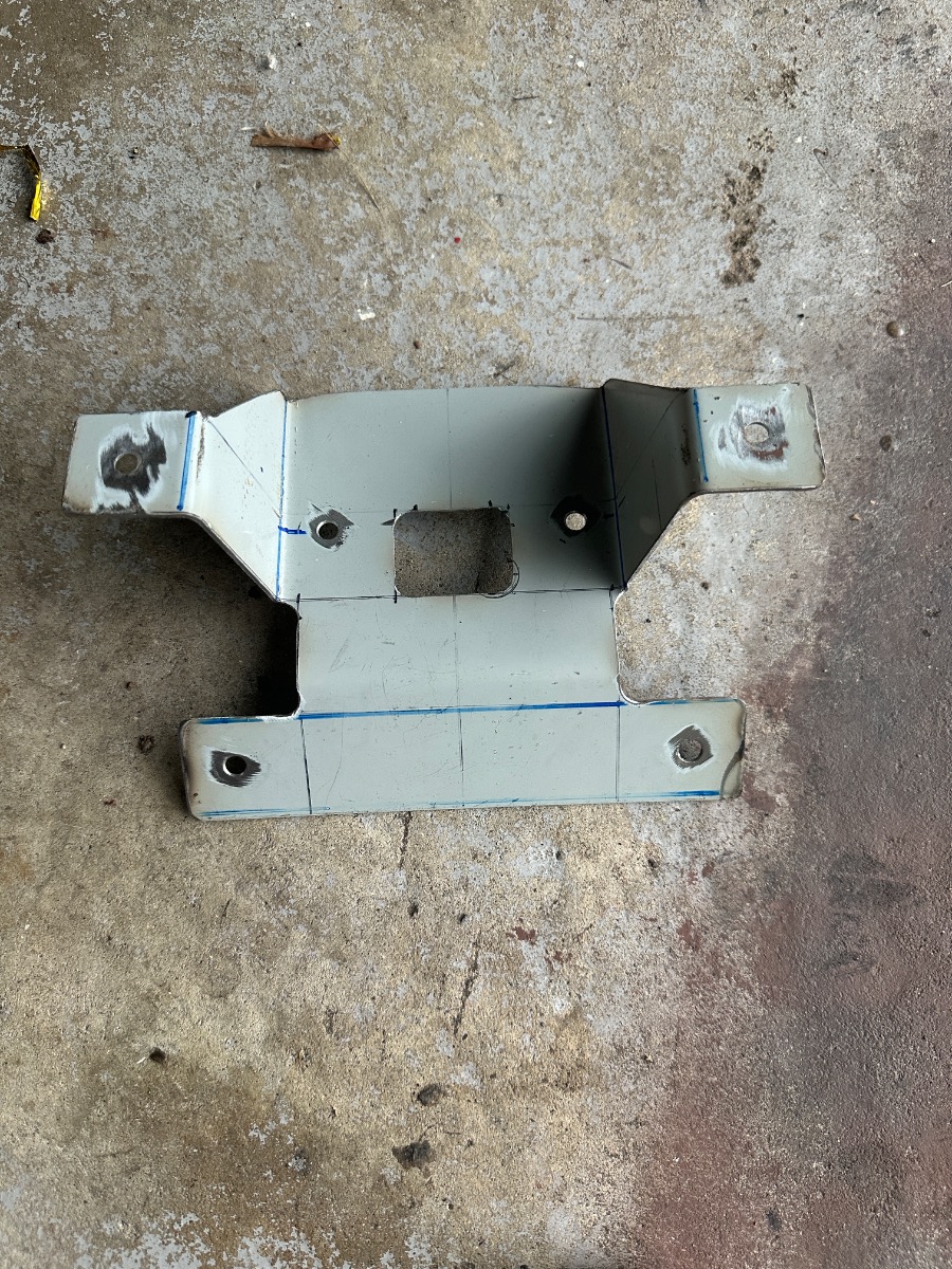

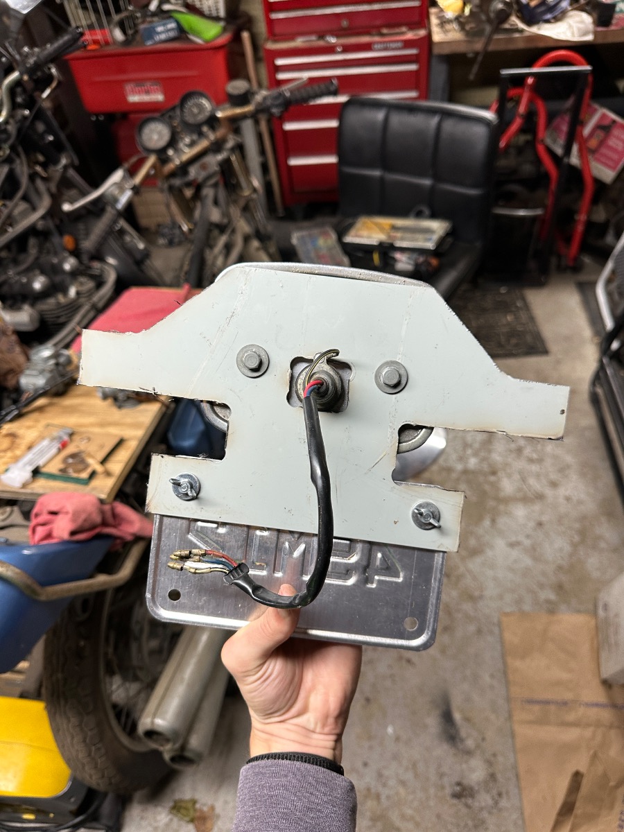

Hey! New here. Just got a 78 kz650c and did a rear fender delete to get rid of the chrome one.

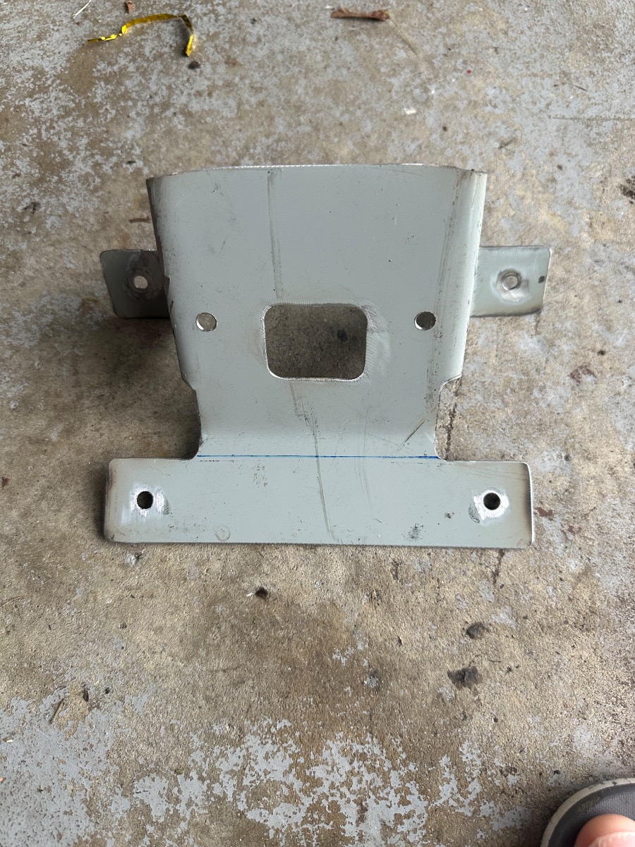

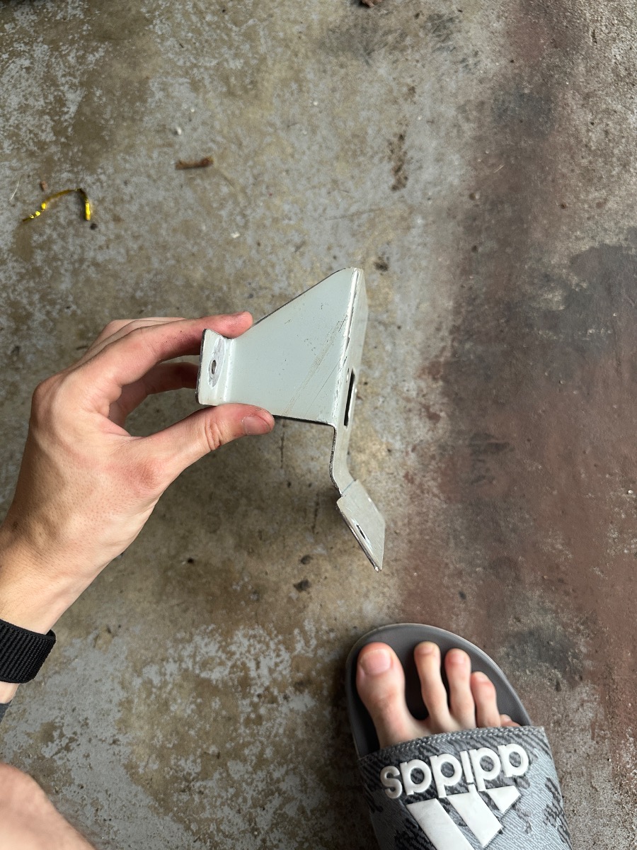

Made a custom bracket for those interested. Holds the taillight and license plate. Take a look!

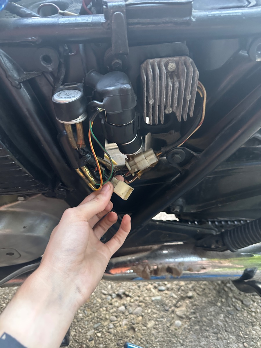

On another note, my left side cover has revealed a plug that is disconnected and goes to nowhere. Any thoughts??

Welcome.
Nice work on the fender delete.

What colour are the wires on the un-plugged plug?

The plug is black & yellow, green & white, and blue.

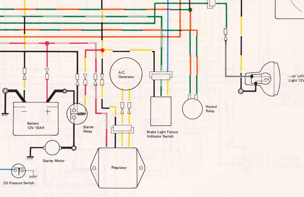

Your missing the rear brake light failure indicator switch box.
You can download a FSM and wiring diagram on here.
