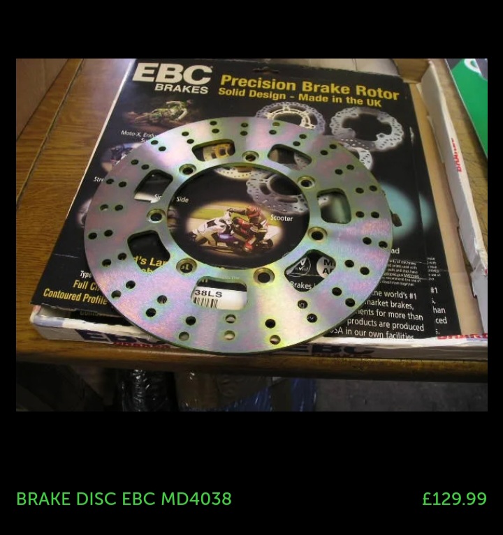

Zpower UK. Will ship world wide or Google EBC MD4038 for supplier near you.
(EBC MD4038)
FRONT FITMENT = Z1000J3, Z1000R2, GPZ1100B2.
These are EBC discs, OD 280MM ID 130MM 7 HOLE MOUNTING.
www.z-power.co.uk/brake-disc-ebc-md4038
(EBC MD4038)
