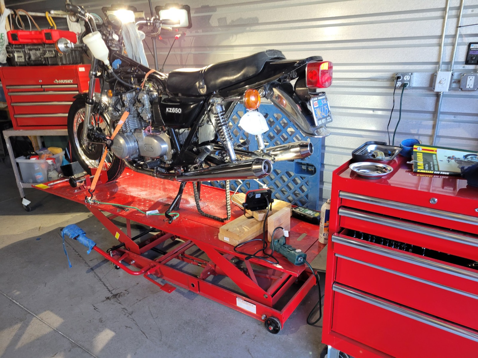

Hi, I'm Steve. I'm new to this group. I am currently restoring a 1978 KZ650b. I have a few questions on the front brake calipers. The pads won't retract enough to insert the disc when reinstalling the wheel. How do I get the caliper to retract further to install the wheel with the disc? I need them to open about a quarter inch more. I bled the brakes and the two holes in the reservoir look clear. Any thoughts or suggestions?
I've attached a picture of the project.

Welcome from the UK. Are these "single" piston callipers ? if so are the "sliders" free ?
