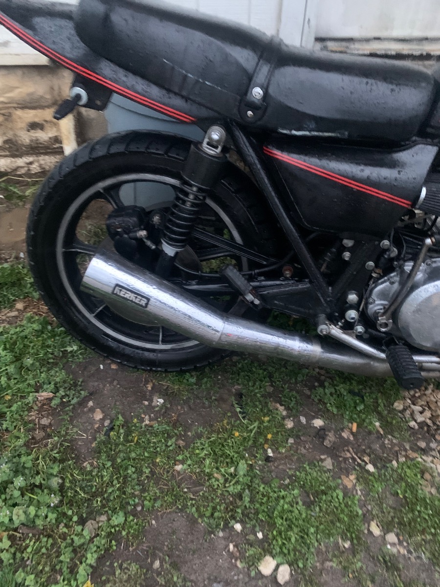

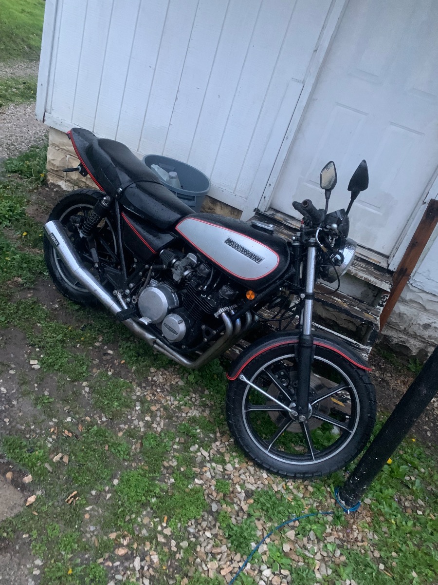

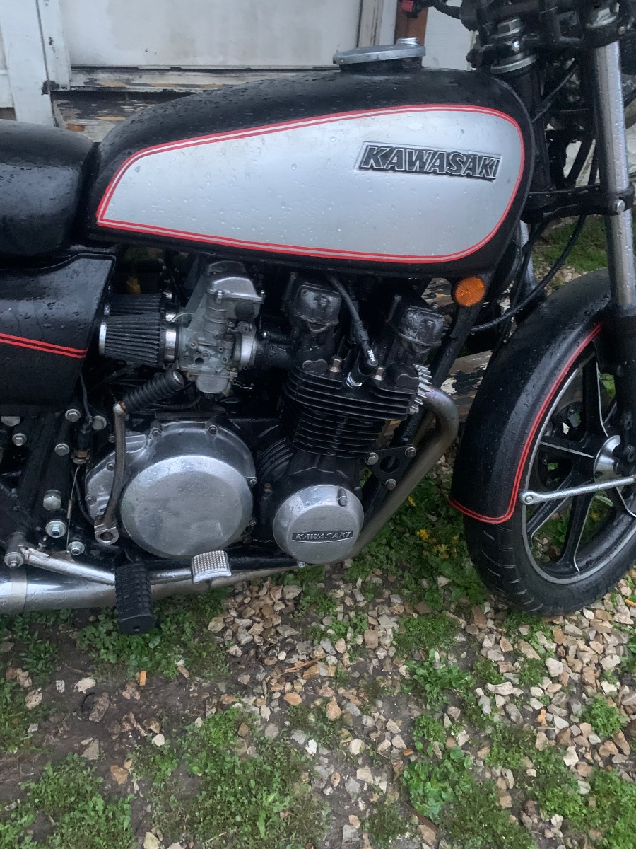

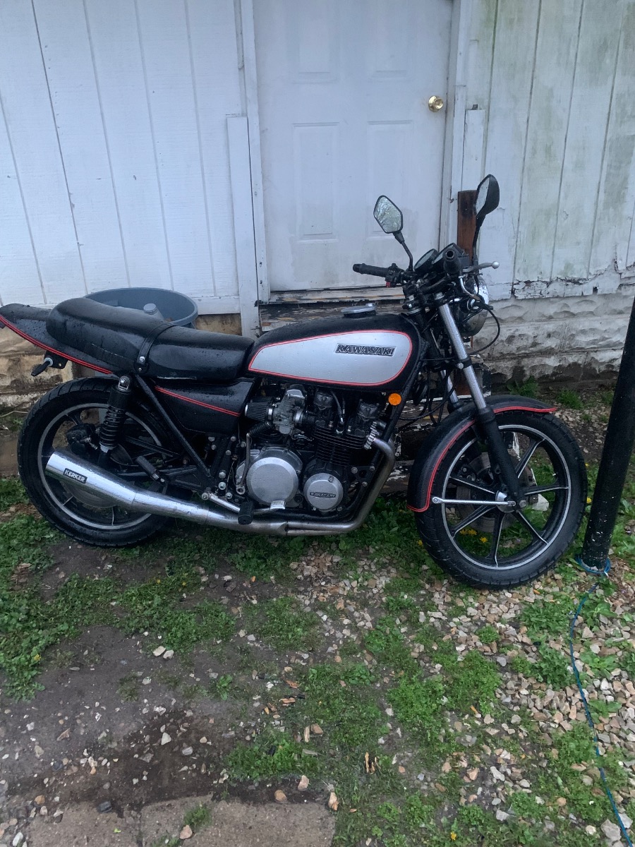

I am trying to identify what model my 79 kz650 is. If anyone can help me I would greatly appreciate it! Here's a few pics..

Agree the frame number will tell you what the frame began it life as. Will say you have great looking machine. It has the tank/side covers and tail that were stock on B, C and F models. A single disk in front a a disk in back with cast wheels. Stock the B models had a single disk in front and drum in rear with spoke wheels. The C models had dual disks in front and single disk in rear with cast wheels. The F models had a single disk in front a drum in the rear and cast wheels. So to me is appears that there has been some conversion of wheels, brakes made on it from stock. But what do I know?

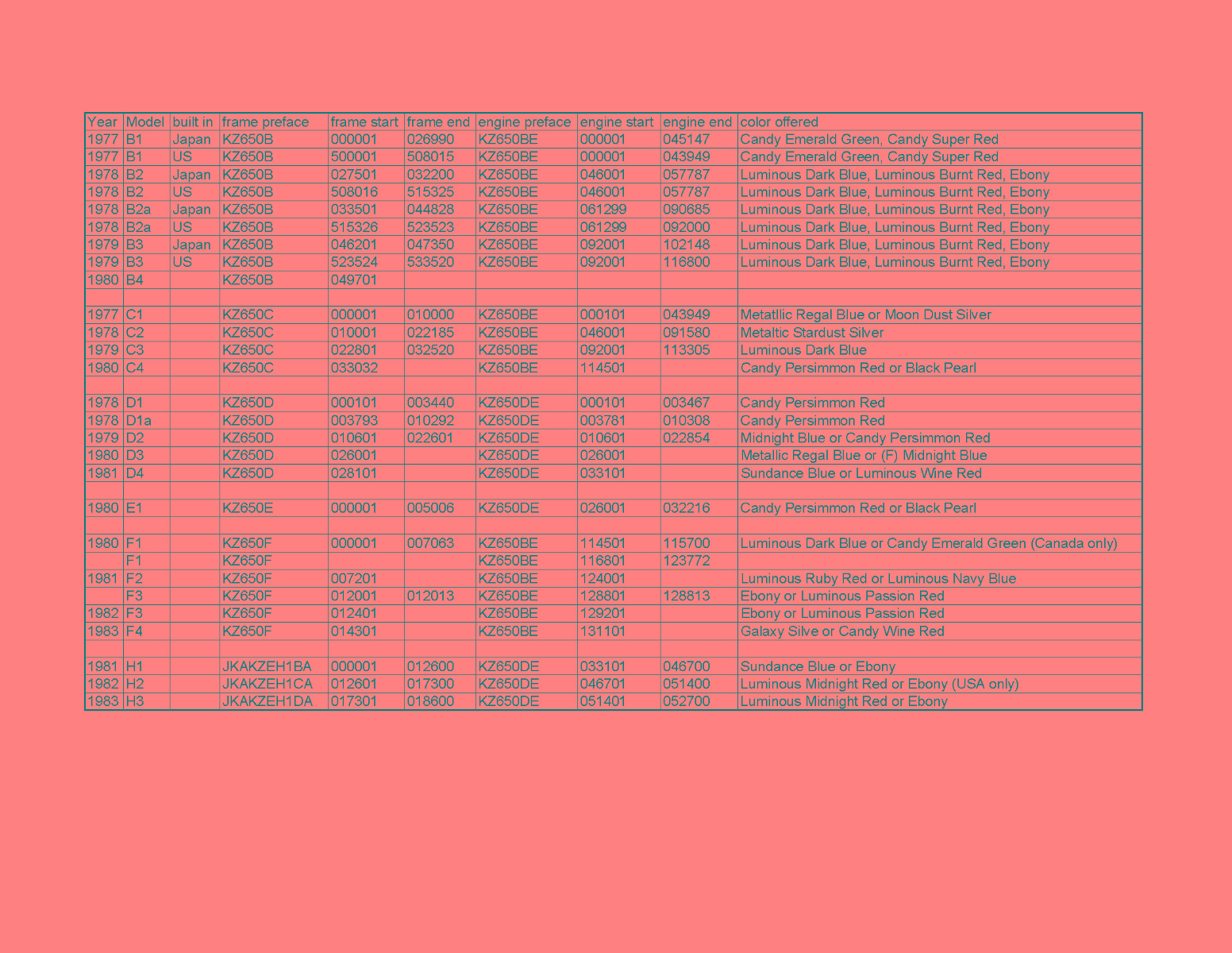

Here is a table I created in the past with frame and engine numbers for the 650s. Never claimed it was 100% correct just what info I could find and make sense of.
Here are some of the differences between models

The frame number falls within the range of 1979 C3 models that I could find and make sense of. The engine number falls within the ranges I could find for 1978 model years. I do not know this as fact but it would appear your great looking machine is an altered version of several models. I mean it is over 45 years old and who knows what has or has not been done to it.
If it were up to me I would call it a C3 model.

We personally don't know KZ650's well at all. The aircooled Z1's / KZ900's / KZ1000's / KZ1100's could, to a point, all be (re)assembled interchangeably, sorta like Legos, wherein they all over many years & models of production pretty much just fits together with little drama. They're commonly referred to as 'Frankenbikes'. Looks like that's the case here.

Your bike looks like a fairly stock 1979 C3, the big tells are the rear 18" disk mag wheel, and the two bolt front foot peg mounts (only after '79)
It looks like a PO has installed a LTD front end on it.
The LTD style headlight bracket mounts to the upper triple tree and single disk brake (stock cover on RH side of axle) F model bikes also had the same front wheel/brake but the headlight brackets were conventional. All C models only came with dual disk brakes which requires a bigger front master cylinder.
