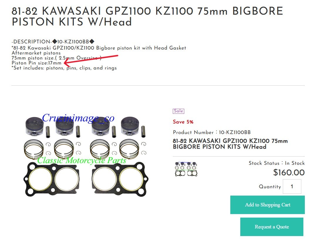

I'd bore the stock sleeves. LA Sleeves are awesome, but very expensive.
CruzinImage sells piston kits for cheap. Can't blame anyone from being gun shy about them, but I've yet to hear a bad review.

23 Mar 2025 13:47I was planning to go this route (I have a GPZ1100A2 block that had one bad bore) until Warren sorted me with some 72mm Wiseco's for my 1000 blockI'd bore the stock sleeves. LA Sleeves are awesome, but very expensive.

23 Mar 2025 13:51 - 24 Mar 2025 00:52On "Cruzin Image" look at GPZ1100 but make sure it's the early model with 17mm wrist pinsThanks TexasKZ I love getting back story about things like that, helps lend perspective. I will have to check the details but after reading that I'm certain I have a J model.
I am getting lots of conflicting opinions about the 2.5mm oversized bores. I had one engine shop tell me they wouldn't even quote it because he had seen it burn up motors. And I have had others tell me it is no big deal.
From what I understand more combustion volume means more fuel and air so more heat, which sorta makes sense.
I did email LA sleeve to get a quote, thanks for the idea!
Nessism,
I took a look at their website and didn't find a Kz1100 piston but I emailed them and asked if there was anything they were interested in. Thanks for the idea
