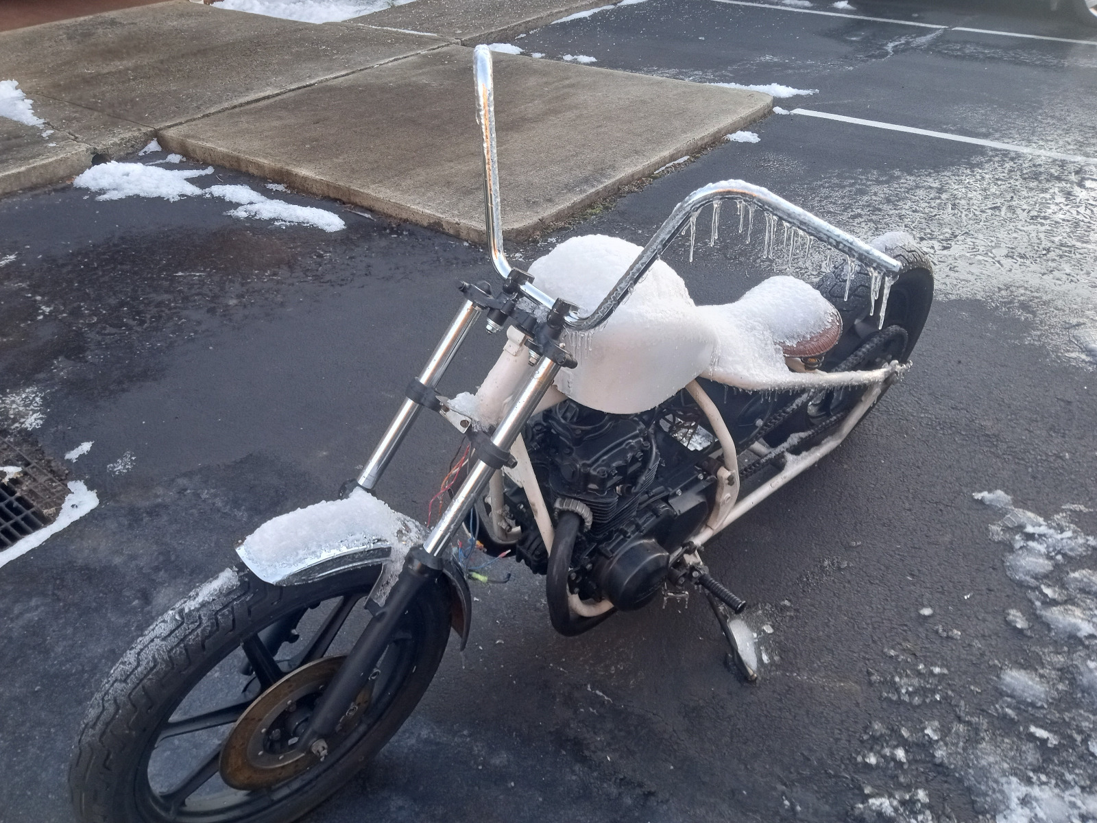

Hi Ya'll!
This is my first time posting on this forum. I've been riding for years and have owned every sort of make and model you can think of. All that aside, I recently relocated to Lynchburg Virginia and have been shopping for a new toy since. Well right before the end of 2024 I purchased a 1982 hardtailed kz440 with a single carburetor. It's a little different like me and I like it quite a bit. Through reading various posts about others who have decided to ditch the dual carb airbox setup I've been reading of peoples jet sizes. Mine currently has a 150 main and a 30 pilot. I've read of folks having anywhere from a 170 to a 135 main and a 25 to a 35 pilot. just curious if anyone else might have any insights. As winter is in full swing I haven't had much time to work on the bike other than changing out bars and the headlight, but I'm thinking new jets are in order as when I rode her before winter I noticed a few flat spots and that it just didn't seam to have the top speed I would have assumed with it not being as heavy as it would have been stock.
Anyway hope all is well in the world of kawasaki and two wheels. I appreciate any feedback!

Re: 1982 KZ440 Single Carburetor Set Up
21 Jan 2025 09:35
Welcome to KZRider
Next time you post a picture complete the install by clicking the insert all tab .
I fixed it for you this time
