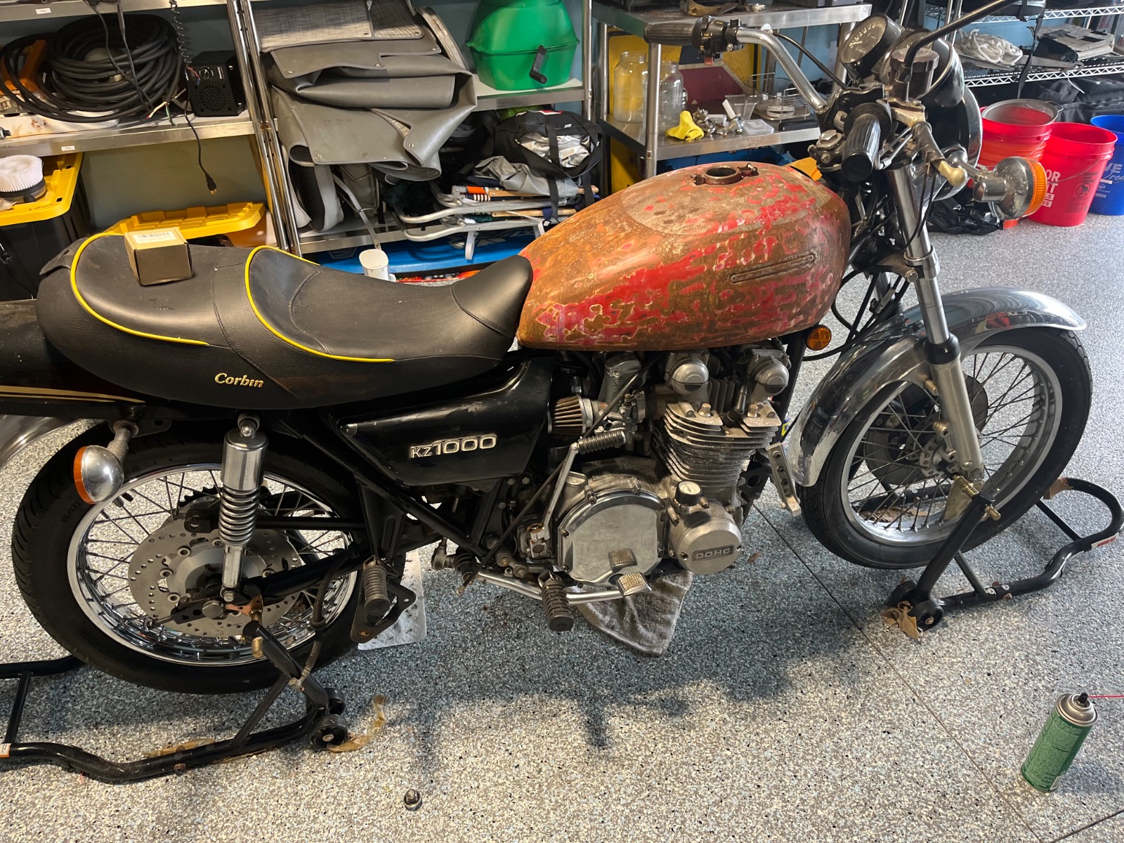

Im Scott from Florida. If you look carefully this bike indicates how high the water was in my garage from the hurricane. 1978 KZ1000A. My uncle and his best friend rode around in the 70’s and 80’s on this bike and its exact twin (that my uncle still has). So im nursing it back to life. To be honest I thought the saltwater flood would have did more damage to it.
Here is what I have learned. Do not pump water out of the engine until you have oil and wd40. I drained it and it kicked over fine. a couple days later it was stuck. Filled it with cheap oil and wd40. Rocking it back and forth from the crank eventually worked it loose. Rebuilt the carbs (again) and got it running (0 electrical problems). Ran it for 20 minutes and it kicks over just fine now. Rebuilt the rear master cylinder (dry for 10 years), new chain, clutch, and rotor and its almost ready for a ride.

Looks like a very early Corbin seat. Have one very similar w/the yellow piping on our Z1-A that slmjim bough new.
