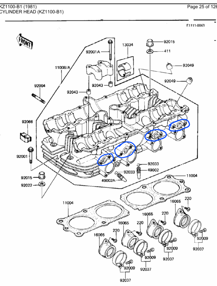

The B1 head has injector holes in the intake tract casting, and will need to be "plugged" by (1) thread tapping each of the 4 holes and installing grub screws, or, (2) the holes could be tig-welded closed.
...OR, find a B2 GPz head that does not have those holes. (the injectors on the B2 are mounted on the throttle bodies and not directly in each intake tract, as on the B1 )
...unless what you actually have is a B2 head...
More info here:
kzrider.com/forum/2-engine/257256-81-and...-comparisons?start=0
H.
