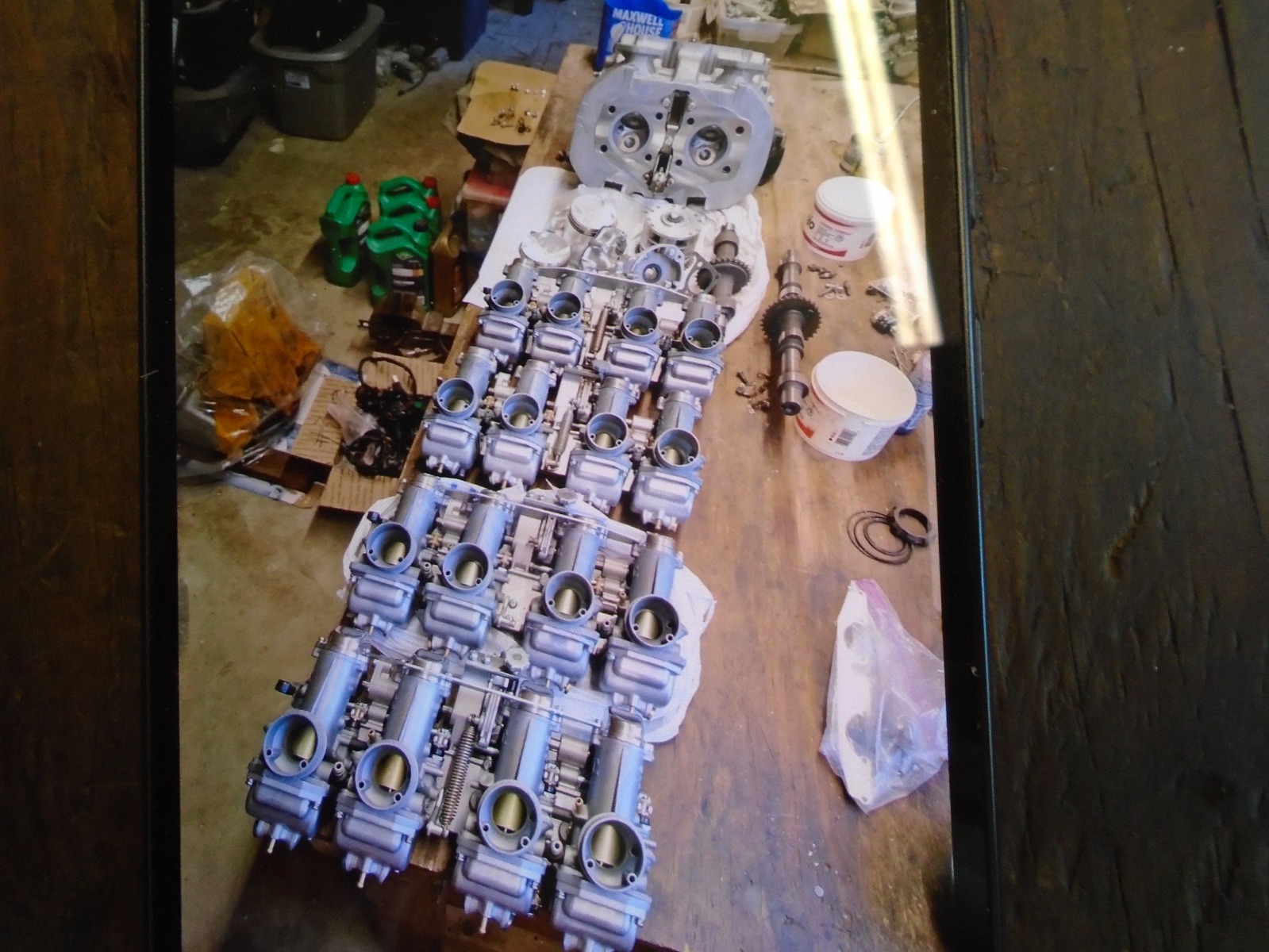

When You say 26 KZ1000 carbs, specify please. There's several variations of "1000" KZ carbs, although persons often lump them up as "1000" carbs. Don't know your intensions of final completion but i still have several sets of the Correct 76-77 KZ900 Z1200 carb banks.
