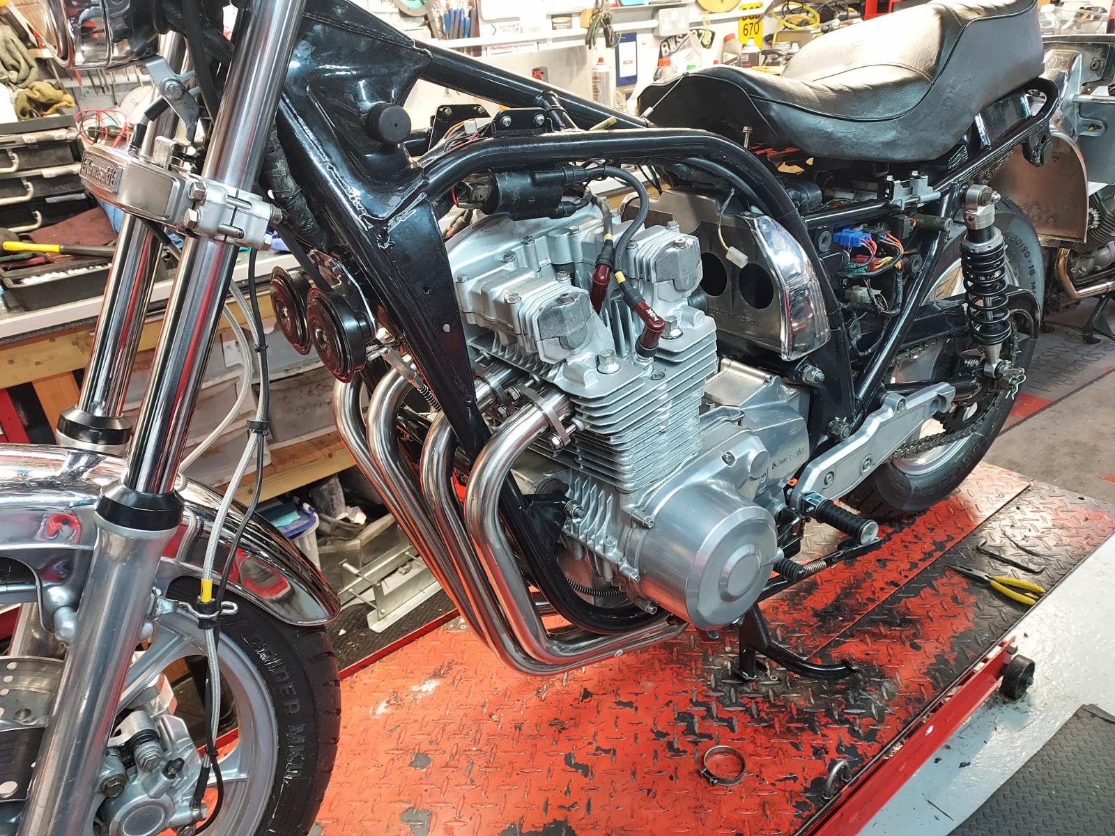

Hi, I am from Scotland and was gifted a KZ1000k LTD about 3 years ago, a good friend had ridden it back from France in 1988 and was so fed up with the constant rain that he left it in his back garden until I picked it up 3 years ago. It was a mess but he was clever enough to put most of the chrome parts in his loft, the rest of the bike was a mess and had seized when sitting outside. Roll on till now, I have rebuilt the top end, new pistons and rebore, powdered coated all the parts and rebuilt the brakes etc. Today I finally managed to get a spark on all 4 plugs after a week pulling my hair out so whilst i wait for carb parts I thought i'd fit the seat , not sure where I am going wrong, can anyone post a photo of the seat catches and hinges on this model so I can see if anything has got damaged during the powder coating or maybe I'm just missing something?

its an 82 with the stepped seat, there are 2 hikes which i can see that part is obvious but there is also a spring loaded stay and a small bracket inboard of the hinges which seems to catch , the seat doesn't fit properly as far as I can see, a photo of a similar year would help, can't find one anywhere .

- don't want to state the obvious but that M8 bolt sticking up from the rear tank mount probably isn't helping. Catch and helmet lock look ok, can you post a pic with the seat open ?

Yes it is the original, managed to get to the bottom of the seat, after some measuring I figures the PO (My Friend) had taken the hinges off and put them back on the wrong way round!!! All good now, got the carbs on today and other bits and pieces so hopefully on Monday I will try to get a tune out of it!
