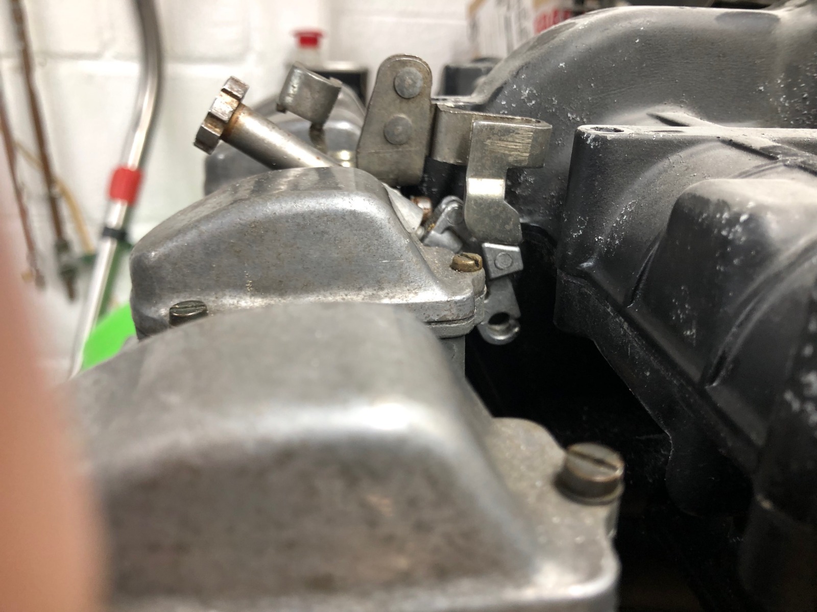

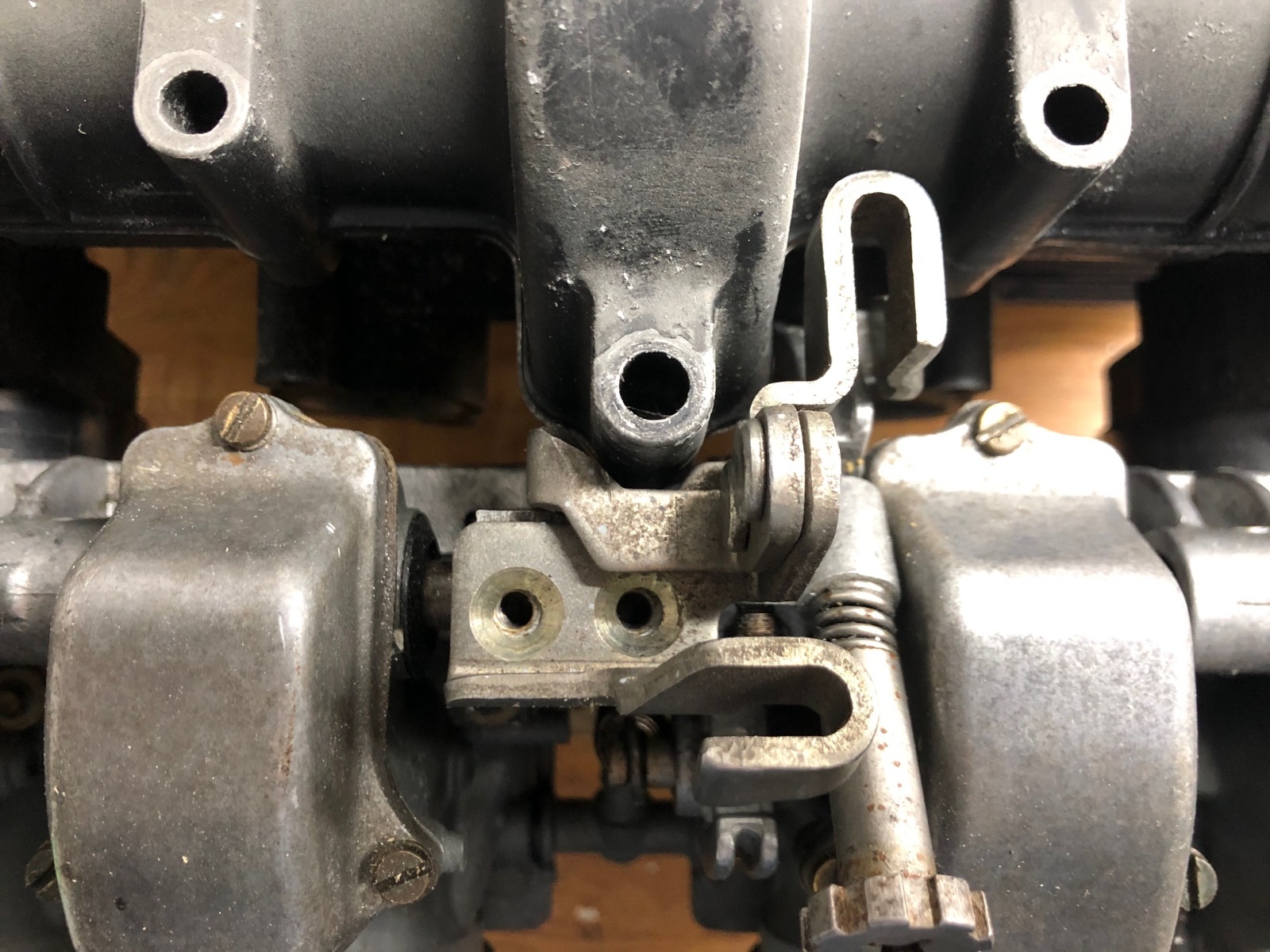

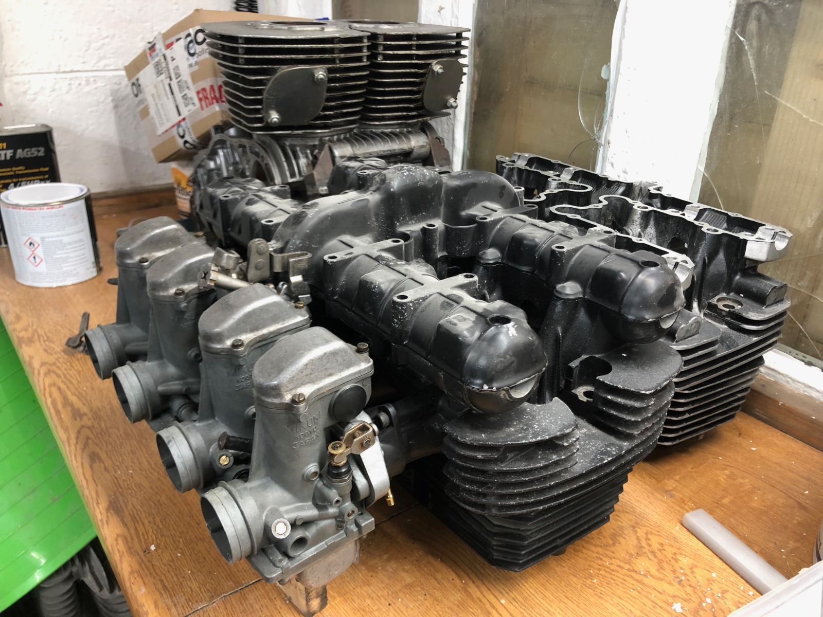

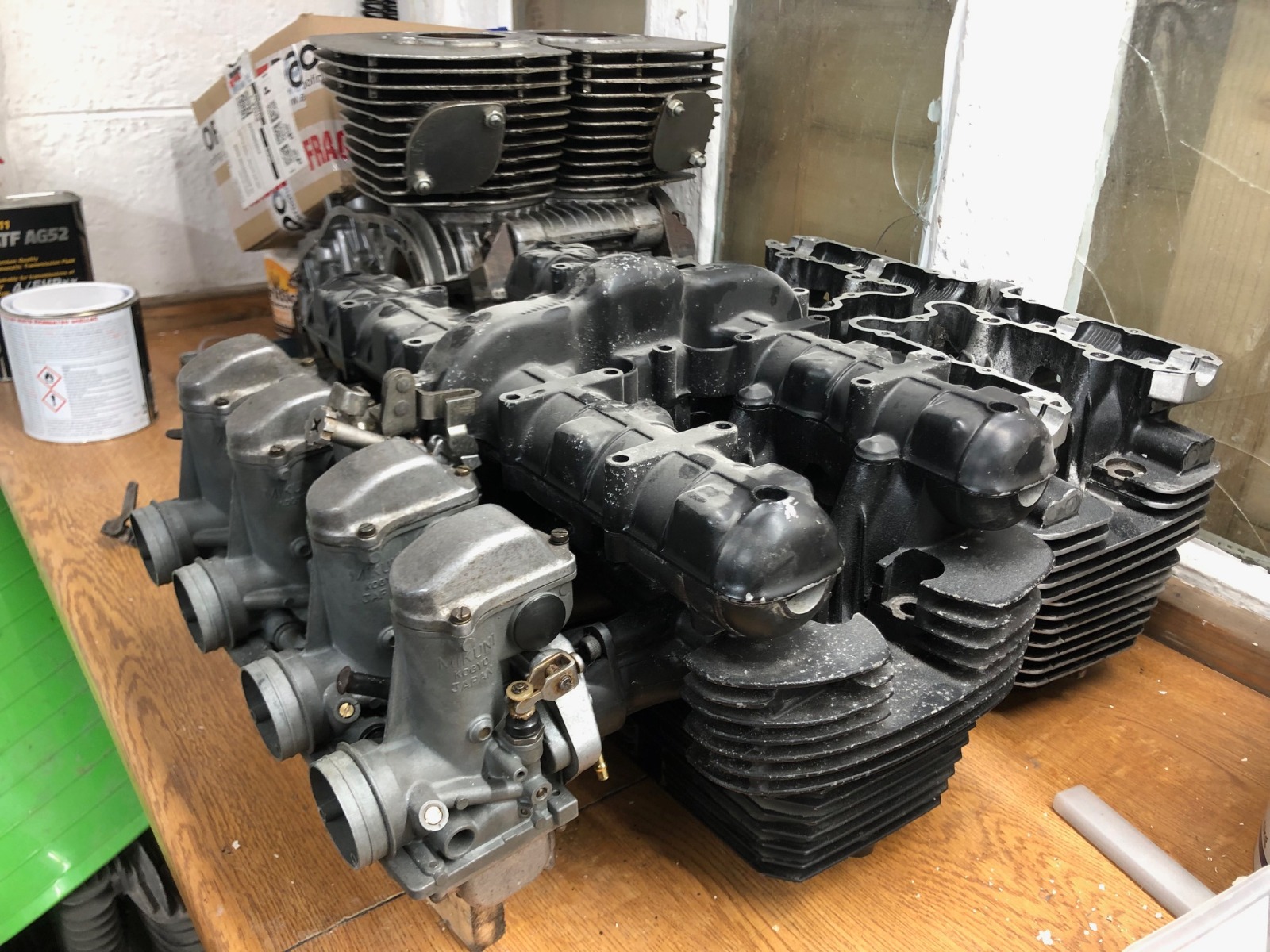

Currently figuring out how to attach Suzuki GS750 VM26's to a Zephyr 750 head.
Have the Z900/1000 rubber carb manifold's, elongated holes, bolts straight on.

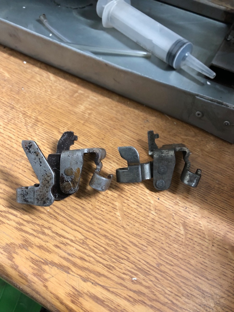

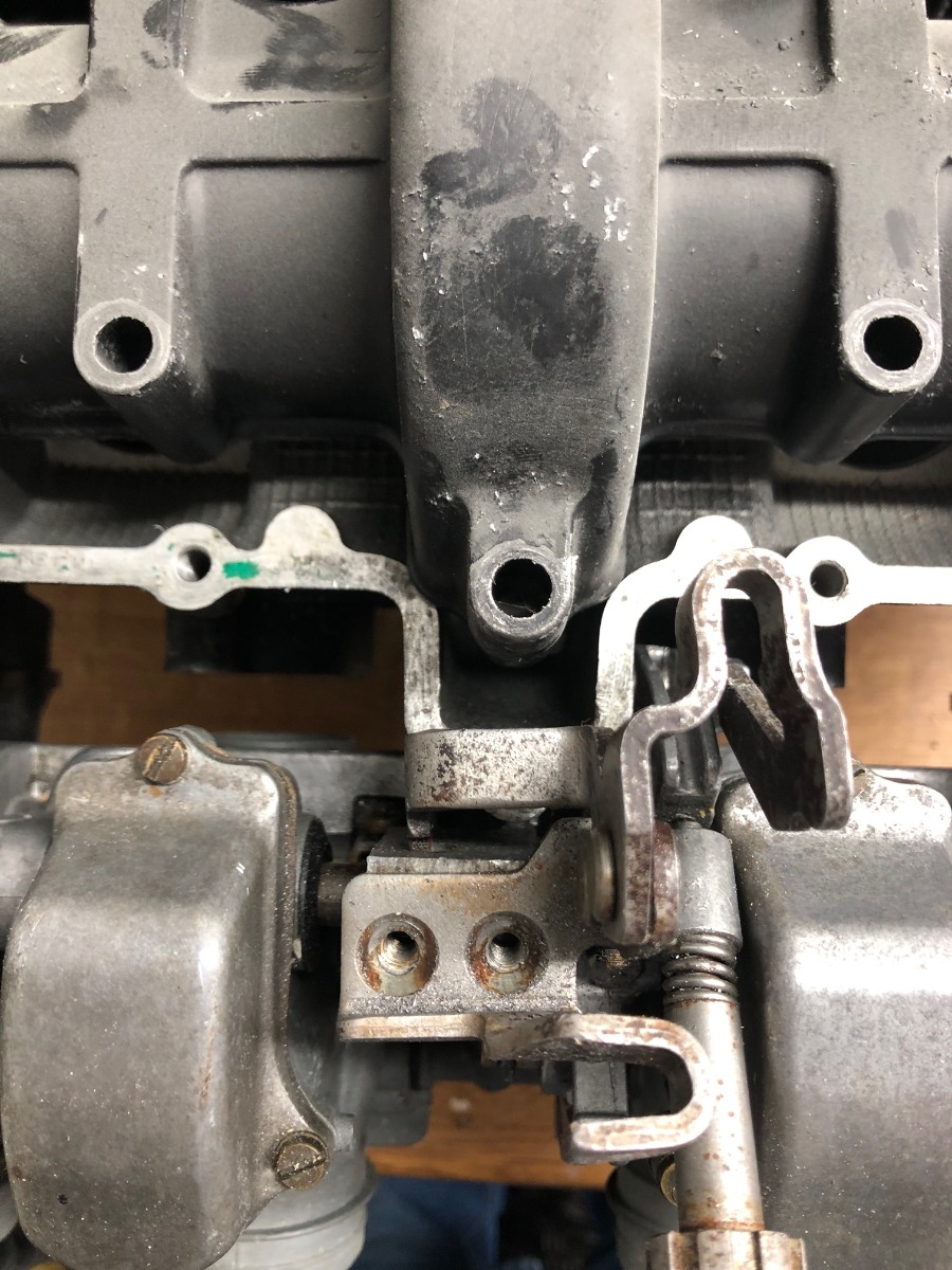

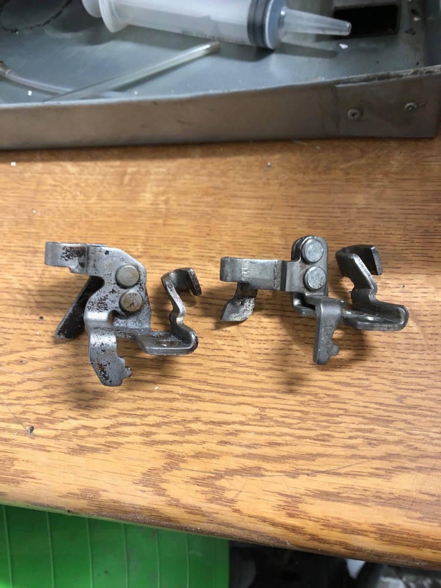

Suzuki throttle bracket looks similar to Z900 and overlaps the rear cam tunnel bolt.
Bought a Z650 (KZ650) throttle bracket, it fits around the rear cam tunnel bolt.
Sure this has been done before and found a thread about it, but the actual question is about which cables/throttle tube to use, cannot find a clear example. At the moment I have 80's GPZ750 unitrac cables and throttle tube.

Engine currently in bits, early 80's KZ750 cases (actually fits my frame, GPZ unitrac motor that came with bike had be bogged in) , GPZ750 barrels, 90's Zephyr 750 head.
My 80's GPZ750 unitrac engine needed a lot of cylinder head work, but luckily I found a Zephyr head that has been reconditioned, stripped it anyway and its all good for less than the price of a new set of valves and it has the Z900 look, will have to file the square fin profile to something more rounded , think it will look more at home in the Z650.

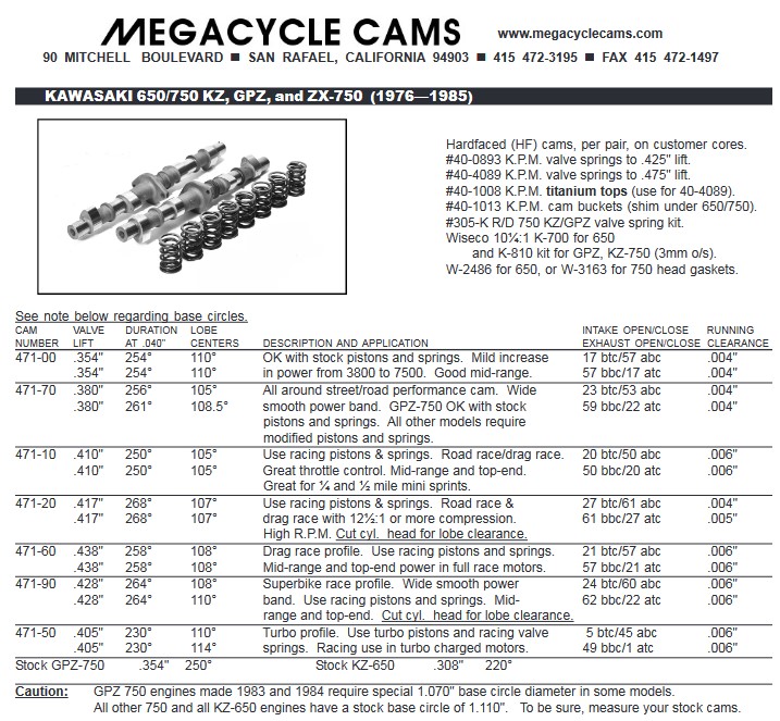

Question 2, I have read something about cam circles being different in some engines, so what do I check to determine if my GPZ unitrac cams will work correctly in my Zephyr head, it has same cam cover style as the Z900's.
Have added a few pictures below.

As for the cam info on 750's see this : (bottom of pic)

Hi, Thank you for the cam information, took the base circle reference, did a search and found a posting on how to measure it.
Apparently it's the exhaust cam that has the smaller base circle.
quote from other post
" only the exhaust cam on the 83-86 Unitrac zx750's have a smaller base circle. The intake cam has a "normal" base circle exactly the same as any other kz750 or kz650 intake or exhaust camshaft."
www.kzrider.com/forum/2-engine/612384-ho...e-1983-gpz750#819840
Will go measure it, its a unitrac motor I stripped, so it might be it is the smaller exhaust cam in which case I cannot use it in my later Zephyr750 head.

Quick update, using the rough method, caliper at 90 degree across the lobe, my exhaust cam is roughly 1mm shorter than the inlet cam, so it is a unitrac smaller base circle one.
Off to buy a set of zephyr 750 cams which will match the head I have.
